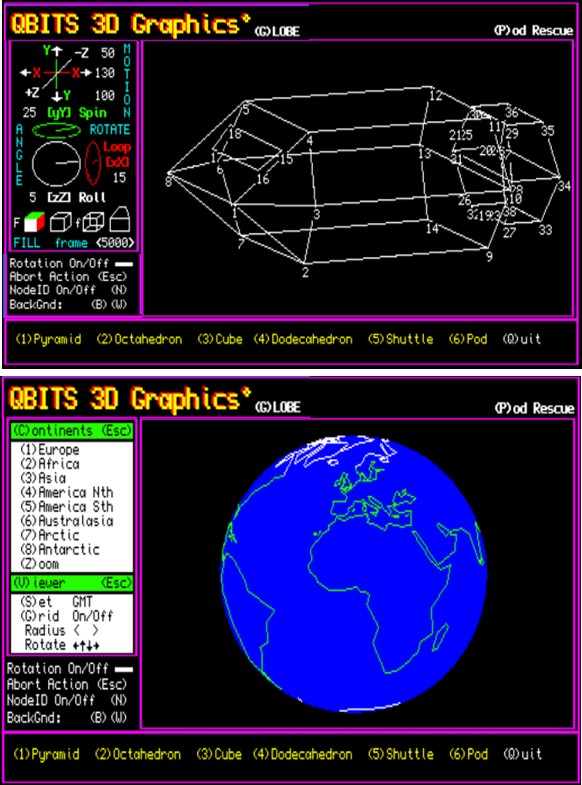

Here’s another in the QBITS suite, the revised and extended 3DGraphics Prog. The accompanying .pdf hopefully will explain all.
This Special Edition includes a simulation where you take control of the moving shuttle and try to Dock with a revolving Rescue Pod which can be a little tricky.
The QBITS rotating Globe is also included.

Hi Qbits,
Excellent piece of software that works first time, on QPC2, of course ! (I had to setup my qpc2 screen to 512x256 though).
The pdf docs are very clear, and give a thorough introduction to 3D perspective graphics. (Full frontal views only).
I could not get the globe 'VIEWER' parameters to function, but this may be a work in progress ?
With the shuttle & pod rescue feature, one small complaint is the colours of both merge into one continuous shape.
Finally, a Pause possibility would give you the opportinity to think.... unless there is one which I have overlooked ?
But these little problems do not in any way take away the pleasure of using the whole program !
Regards, Steve.

Hi Steve,
Thanks for taking a look, the Viewer should be working, press ‘V’ highlight changes – ‘S’ ‘s’ Reset to GMT ‘G’ ‘g’ Grid on/off ‘< >’ left/right chevrons to reduce increase Globe size and the cursor keys to Rotate Globe. Downloaded the prog to check and its running OK with my QPC2 Set up. Note: Check in the back pages of my pdf.

Hi Qbits,
Yes, the 'Viewer' controls do work ok, after following your recommendations...
'Set' GMT, replaces the world view onto the Greenwich meridian. The 'chevrons' require you to reduce the globe at first....
Again, an excellent well-presented program.
Steve.

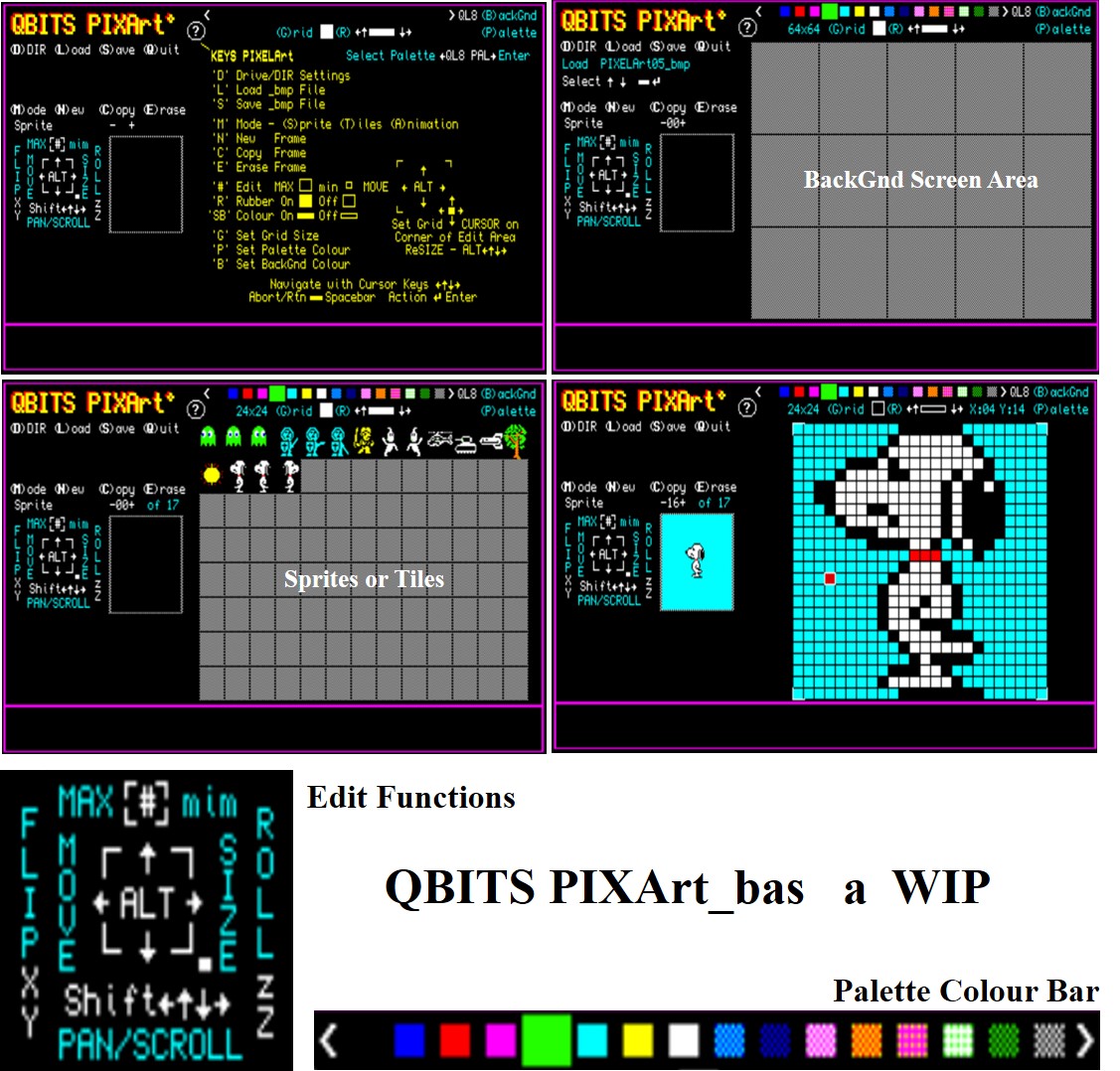

Thankfully made some time for a very welcome and therapeutic Tinkering in QL SuperBasic. Still amazed at what can be achieved with this underrated version of the BASIC computing language.
Following on with upgrades to the QBITS QLFont Editor and QBITS 3D Graphics I thought I would have a stab at my QBITS BITMAP Design.
Pixel Art and its development is fascinating subject in itself, so I set myself the task to create a QBITS PIXEL ART software program. This begins with an upgrade to the Sprites generator that was achieved with QBITS BITMAP Design. Retro Computer Games deploy patterned Tiles for screen backgrounds. Still a WIP is a function for generating such background scenes. Then hopefully some form of controlled animation which will go towards creating a simple Demo Game.
QBITS
Attached is a preview of screen shots that I have put together so far. My Autum Project for 2023.
