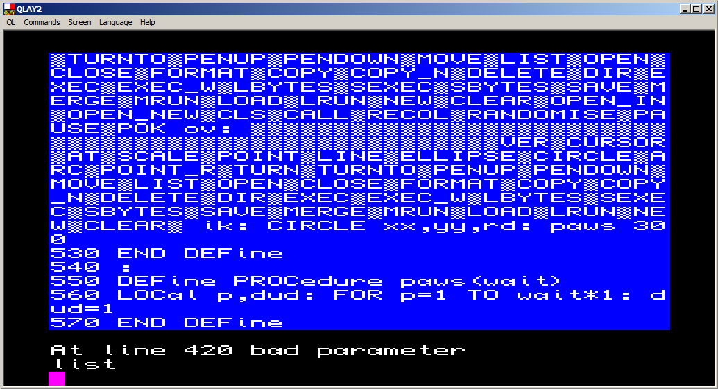

Weird but I ran this on QLAY2 and it corrupts itself (i.e. the BASIC gets corrupted).stevepoole wrote:Hi Again,

Hi Bwinkel67,
I don't have QLAY... but have examined the fireworks code, and guess at your bug solution.....
First you mention corruption : Do you get the MIStake keyword inserted, and if so on which lines ?
The type of the formal parameter 'wait' depends on the first calling parameter, the literal 22222, so is integer.
22222*.5 is 11111, also integer. The second call gets 999*.5.... 499.5 which is float ! (The FOR loop is float too...)
If QLAY baulks with the value 77777*.5, it means that QLAY is expecting an integer maximum of 32767 !
Normally, the QL allows coercion in such cases, but maybe QLAY doesn't here? (Try changing 77777 to 32767).
But as I said, I can only guess without having QLAY to experiment with !
Best wishes,
Steve.

No, I mean corrupts memory where part of the loaded code becomes gobbledygook.stevepoole wrote: First you mention corruption : Do you get the MIStake keyword inserted, and if so on which lines ?
If I save the basic code after running it, here is what it looks like:
100 ::
110 CLEAR: main: ÿÿÿÿÿÿÿÿÿÿÿÿÿÿÿÿÿÿÿÿÿÿÿÿÿÿÿÿÿÿÿÿÿÿÿÿÿÿÿÿVERCURSORATSCALEPOINTLINEELLIPSECIRCLEARCPOINT_RTURNTURNTOPENUPPENDOWNMOVELISTOPENCLOSEFORMATCOPYCOPY_NDELETEDIREXECEXEC_WLBYTESSEXECSBYTESSAVEMERGEMRUNLOADLRUNNEWCLEAR 7: QUIT: REMark fireworks2_bas by S.Poole, v20apr20
115 REMark Change line 560 to 'wait *.5' to speed up screen output on Qemu.
120 :
130 DEFine PROCedure main
140 LOCal p,ik,ct,loop,a,time,x,y,ring,dia,Rink,b,inc,fil
150 LOCal yes,nbr,lng,ov,dwn,i$(1): p=5: ik=255: ct=0
170 ÿÿÿÿ ÿÿÿÿÿÿÿÿÿÿÿÿÿÿÿÿÿÿÿÿÿÿÿÿÿÿÿÿÿÿÿÿÿÿÿÿÿÿÿÿÿÿVERCURSORATSCALEPOINTLINEELLIPSECIRCLEARCPOINT_RTURNTURNTOPENUPPENDOWNMOVELISTOPENCLOSEFORMATCOPYCOPY_NDELETEDIREXECEXEC_WLBYTESSEXECSBYTESSAVEMERGEMRUNLOADL 512,256,0,0: SCALE 100,-75,-50: FILL 0: ÿVERCURSORATSCALEPOINTLINEELLIPSECIRCLEARCPOINT_RTURNTURNTOPENUPPENDOWNMOVELISTOPENCLOSEFORMATCOPYCOPY_NDELETEDIREXECEXEC_WLBYTESSEXECSBYTESSAVEMERGEMRUNLOADLRUNNEWCLEAROPEN_INOPEN_NEWCLSCALLRECOL RANDOMISEPAUSEPOK 0: ÿÿÿÿÿÿÿÿÿÿÿÿÿÿÿÿÿÿÿÿÿÿÿÿÿÿÿÿÿÿÿÿVERCURSORATSCALEPOINTLINEELLIPSECIRCLEARCPOINT_RTURNTURNTOPENUPPENDOWNMOVELISTOPENCLOSEFORMATCOPYCOPY_NDELETEDIREXECEXEC_WLBYTESSEXECSBYTESSAVEMERGEMRUNLOADLRUNNEWCLEAROPEN_INOP 0: CLS
180 REPeat loop
190 FOR a=3 TO 3+RND(5)
200 time=2+RND(3): biz: x=RND(-55 TO 55): y=RND(-25 TO 40)
210 dia=RND(1 TO 80/time): Rink=RND(1 TO 7): ring=RND(6)
220 IF ring: zap x,y,dia: zap x,y,dia: rays x,y,dia
230 FOR b=1 TO 1+RND(12)
240 inc=RND(255): fil=RND(0,1): yes=RND(0,1)
250 nbr=RND(10 TO 19): lng=RND(10 TO 19)
260 IF ring: FOR ov=-1,-1: burst x,y,lng/3,yes,ov,inc: paws 77777
270 spark x,y,lng,inc: i$=INKEY$: IF i$<>"": EXIT loop
280 END FOR b: FOR dwn=1 TO 7: ÿÿÿÿÿÿÿÿÿÿÿÿÿÿÿÿÿÿÿÿVERCURSORATSCALEPOINTLINEELLIPSECIRCLEARCPOINT_RTURNTURNTOPENUPPENDOWNMOVELISTOPENCLOSEFORMATCOPYCOPY_NDELETEDIREXECEXEC_WLBYTESSEXECSBYTESSAVEMERGEMRUNLOADLRUNNEWCLEAROPEN_INOPEN_NEWCLSCALL dwn
290 END FOR a: END REPeat loop: END DEFine

Hi Bwinkel67,
Line 420 has the statement INK ik,ik+4,3, where ik+4 can take the value 255+4. ( SMSQ/E converts this within range using MOD. )
So, try changing line 240 to read inc=RND(251) . ( QDOS does not do range checking and conversion, it would appear ).
But I am at a loss to see why that would corrupt the ' OVER ' entry in the name-table to ' ÿVER ' !
Hope this fix will work though...
Steve.

Re: Happy Birthday!
Depending on the ROM version used, QLAY might simply crash/corrupt the program because of too many LOCale variables in the procedures.
Weird things happen on older (older than JS) ROMs (even on "real" QLs) when more than eight local variables are used.
Using Minerva ROM on the emulator would cure that.
Re: Happy Birthday!
So using Minerva got rid of the corruption but it now crashes at line 420:
At line 420;3
bad parameter
I tried steve's hack and still got the same error. At least it's not corrupting anymore.
At line 420;3
bad parameter
