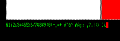

I followed the steps, compiled, and it worked, but with some inconvenience.
SYSROM = mge.rom
KBD = ES
Even though I have this configuration in sqlux.ini, I get this message when running the emulator.
Using default keymap. (use KBD=<countrycode> in sqlux.ini to change)
I'm using the mge ROM, in fact, the ROM on Dilwyn's website is the one on my QL computer! which is also shared on my website.
When I run the emulator, the keyboard works, indeed, as an English keyboard, but if I change the settings of my Linux keyboard to English, then yes, the characters that correspond to a Spanish QL keyboard start appearing. Here is a screenshot.
I have not tried all the combinations yet, but I have not been able to access the key with the characters '[' and 'ç', the penultimate one in the first row on the Spanish QL keyboard.
Update. Apparently, in previously compiled versions of sQLux, the keyboard, when the English keyboard is selected, already worked as I described.

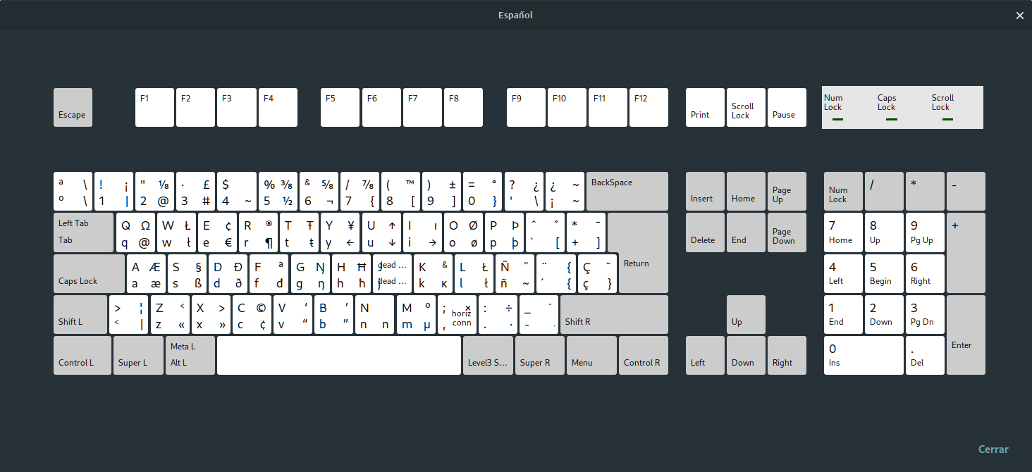

Support material. My Spanish keyboard on Linux.

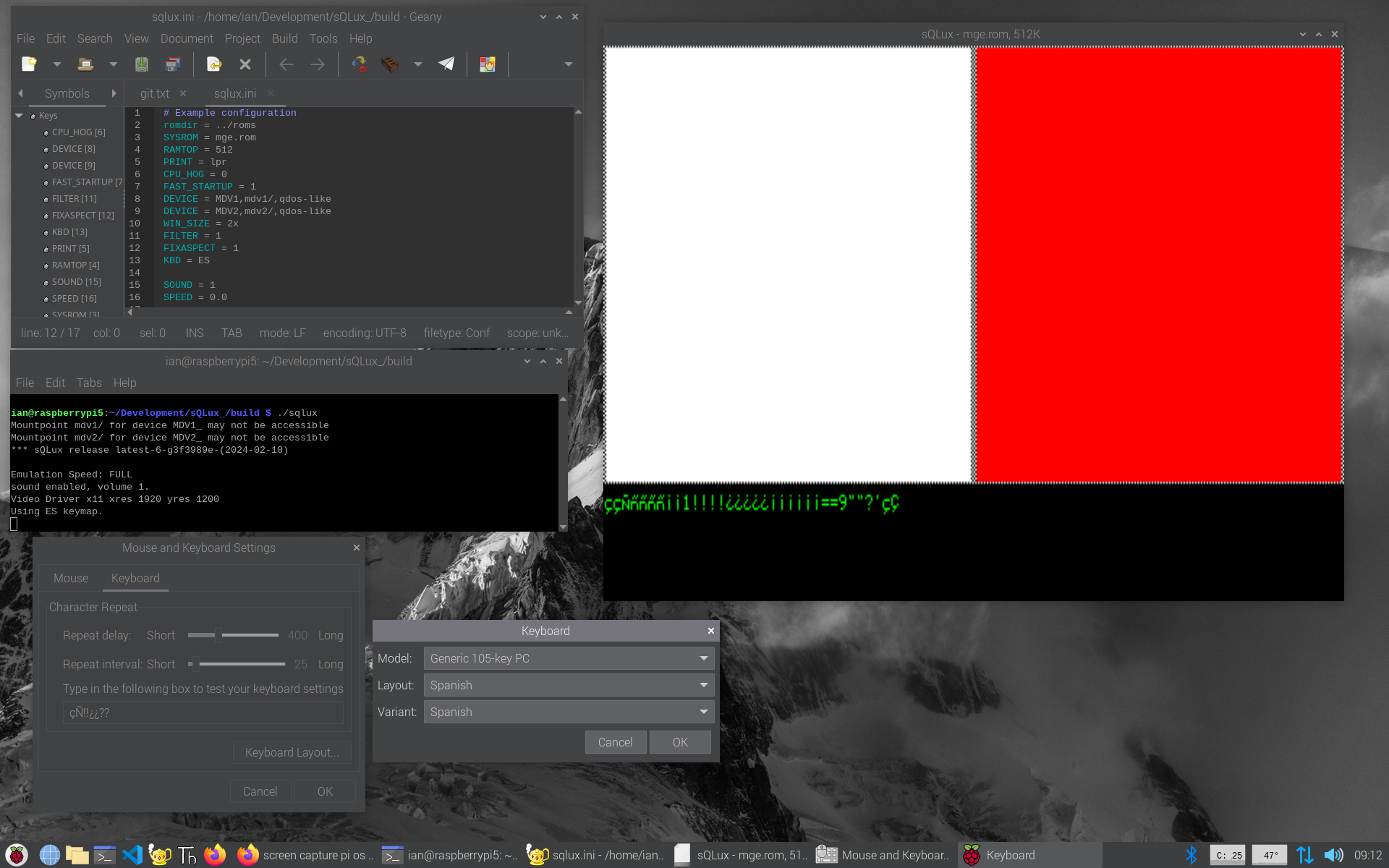

After a great deal of support and testing from @badaman the code changes needed for the Spanish keyboard have now been merged back into the sQLux master branch.
The changes have been tested under X11 (Mint Linux, Ubuntu Linux and Pi Os) and MS Windows. There is support for dead keys, and a selection of Alt Gr key combinations.
By default Pi OS bookworm uses X11 for SDL, so these changes will currently work "out of the box" for Raspberry Pis. The changes do not work on Pi OS bookworm when SDL is configured to use Wayland, as the version of Wayland currently used in Pi OS does not report dead key key presses.
