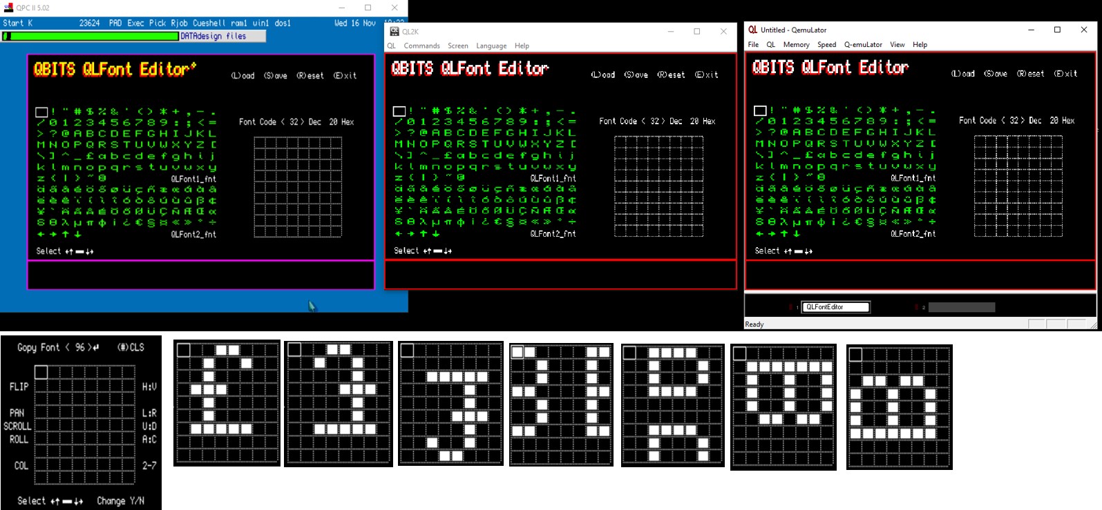

Hi all,
Sems my QLFont Editor has prompted a bit more thought. I’m not by nature a perfectionist but words of my long-departed father still echo around the house. There’s always room for improvement however well you think you may have done.
The heart of the Font Editor is the Bitmap and its design attributes. A little tidy up of the code and additions made.
Flip Horizontally or Vertically,
Pan Left & Right,
Scroll Up and Down
Roll (rotate 90*) Anticlockwise or Clockwise
Change Font INK colour 2-7
Press’#’ and clear the Bit Grid to begin a new design.
Copy in a Character Font from one of the rest of the Fonts displayed.
I apologise for the run around but I think this will be the final version of QBITS QLFont Editor. I think all’s working satisfactorily as best I can cheek.
I’ve done a small revamped of the attached pdf.
QBITS
Note: 20th Nov 2022 Some KEYPad and Bitmap Editor corrections made to code and pdf.

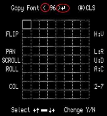

I haven't found it yet "Copy" to copy an existant char to another, say, to make a "Q" from an "O" or similar. That makes life a lot easier.
Re: QL Tinkering
Hi Ralf R
When in Bitmap Editor mode use the ‘ < , > .’ Keys < > are displayed. Select lower or higher Character Font, then Enter to Copy across into Bitmap. I guess my screen aids are more wily than I perceived. Although once mastered I hope it will be an obvious reminder.
QBITS
QBITS
- QBITS BitmapEditor.jpg (32.08 KiB) Viewed 7328 times

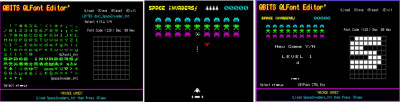

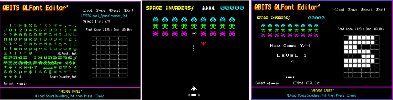

Hi All,
Here’s my nostalgic give away for Black Friday > QBITS QLFont Eitor SE< with attitude. Only kidding.
This Special Edition come with an added bonus a simplified version of a Classic RETRO ARCADE GAME - Space Invaders - to show off the use of Edited Font Designs.
Download QBITS_FontEdit_BBQLSE (Font Files & QBITS_FontEdit_SE for QPC2 QBITSProgs Menu)
Note: Code Line 1003 to Set Default Device Driver - flp1_ win1_ etc...
Note: Code Line 2003 to Set Pause Delay: 0 for BBQL: between 2 -5 for higher speed platform.
(L)oad SpaceInvader_fnt file and Press (D)emo to action Demo Space Invaders.
There are Four Levels, but watch out for those falling bombs you only have four Lives per Level.
Use Left & Right cursors to move the Space Ship and spacebar to Fire.
QBITS
