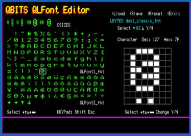

Here’s the QBITS QLFont Editor.with my usual attached pdf and few Font files to check out
Once downloaded and fired up you may want to check out the Fonts Andrews has posted under Fonts in Software & Programming.
I have given Giro Rescue a bit of a QBITS makeover to run on my QPC11 set up - hope Henry has no objections.
QBITS
QBITS
- QLFontEdit.jpg (38.82 KiB) Viewed 9488 times

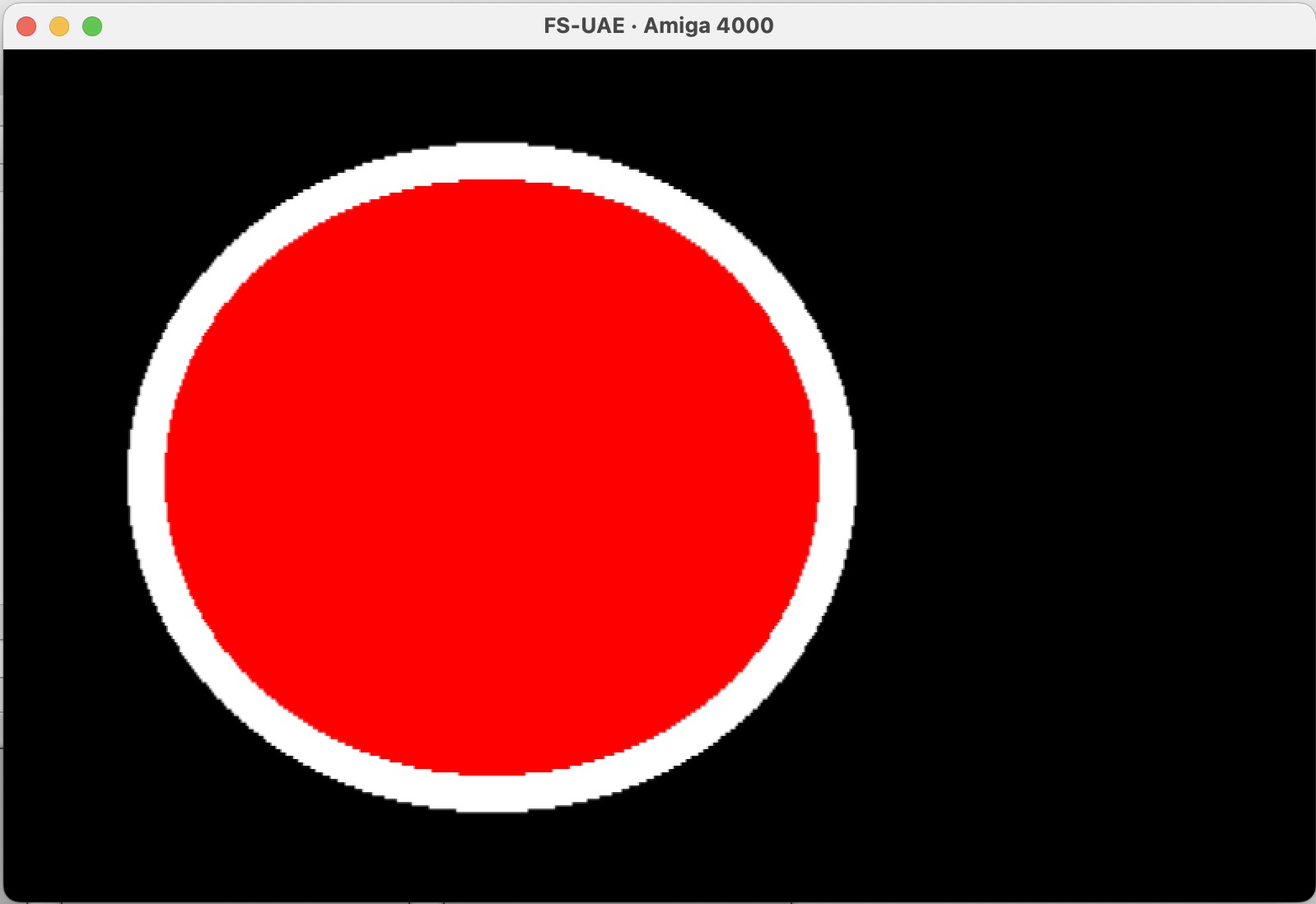

100 REMark A circle routine using only
110 REMark integer arithmetic.
120 REMark Converted some time ago from
130 REMark a ZX Spectrum Z80 m/c routine
140 REMark I wrote once.
150 REMark -Mark Swift-
200 MODE 4
210 OPEN#3;scr_512x256a0x0
220 CLS#3
230 LET XC=188: LET YC=128
240 LET RX=140: LET RY=95
250 LET WidX=14:LET WidY=10
260 GO SUB 500
270 PAUSE
280 CLOSE#3
290 STOP
500 REMark ELIPSE XC,YC,RX,RY,WidX,WidY
510 DIM S(18)
550 LET XR=INT (RX-INT(WidX/2)): LET YR=INT (RY-INT(WidY/2)): LET Index=1: GO SUB 1000
560 LET XR=INT (RX+INT((WidX+1)/2)): LET YR=INT (RY+INT((WidY+1)/2)): LET Index=10: GO SUB 1000
570 LET Xf=S(1): LET Xt=S(10): LET Y=0: GO SUB 710
580 LET Index=1
590 IF S(Index)=0 THEN GO TO 610
600 GO SUB 1100: IF YI=0 THEN GO TO 600
610 LET Index=1
620 LET Xf=S(Index): IF S(Index)=0 THEN GO TO 640
630 GO SUB 1100: IF YI=0 THEN GO TO 620
640 LET Index=10
650 IF S(Index)=0 THEN RETurn
660 GO SUB 1100: IF YI=0 THEN GO TO 650
670 LET Xt=S(10): LET Y=S(11): GO SUB 690
680 GO TO 610
690 REMark
700 GO SUB 710: LET Y=-Y: GO SUB 710: RETurn
710 REMark
720 IF Xf<=0 THEN GO TO 770
730 BLOCK#3;(Xt-Xf+1),1,(XC+Xf),YC+Y,7
740 BLOCK#3;(Xt-Xf+1),1,(XC-Xt),YC+Y,7
750 BLOCK#3;(Xf+Xf-1),1,(XC-Xf+1),YC+Y,2
760 RETurn
770 BLOCK#3;(Xt+Xt+1),1,(XC-Xt),YC+Y,7
780 RETurn

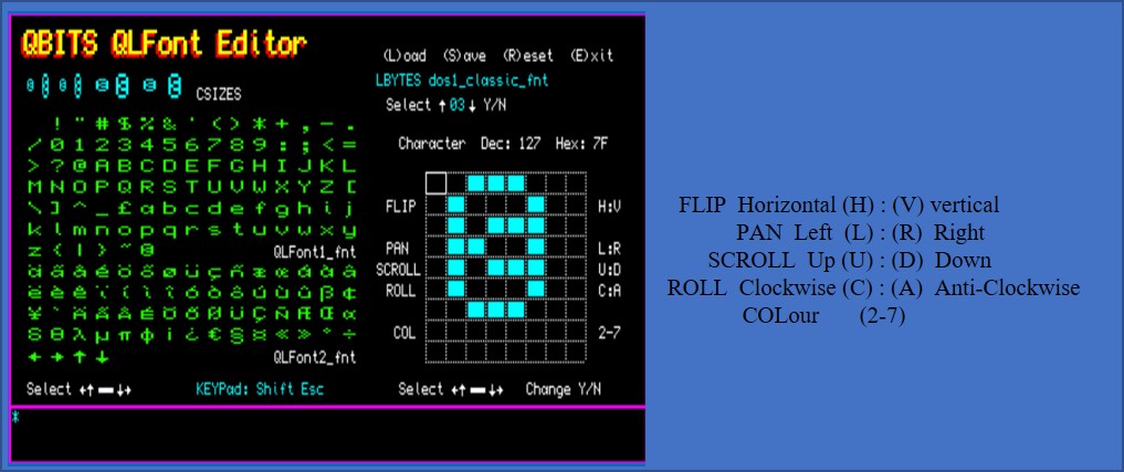

Re: QL Tinkering
Mark Swift
Your Circle_bas Prog draws a circle expanding from the centre line of x,y increasing segment by segment using the BLOCK command.
On a BBQL it is slow enough to see the circle grow. On more updated platforms the circle appears instantly unless Pause are inserted.
From a Tinkering Point of View does the code have any practical use for other Progs???
Thanks for your thoughts/request, here is the Editor with Flip, Pan, Scroll, Rotate and I added Colour as an extra.
It kept me busy for a while and was fun to do, hope it meets all your expectation.
I had one problem being a 9x8 matrix the Rotate clips the bottom row.
QBITS

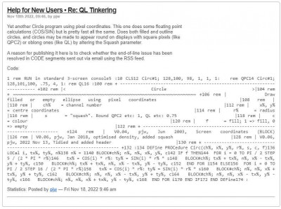

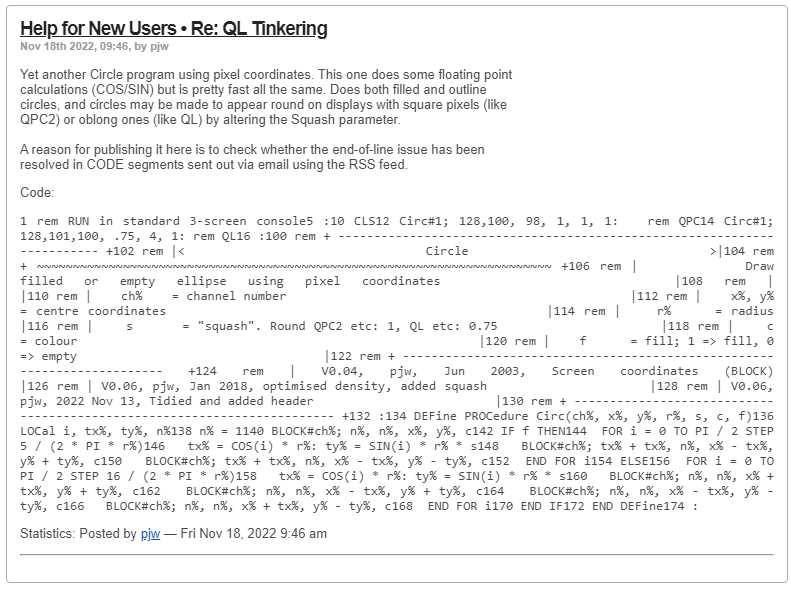

Yet another Circle program using pixel coordinates. This one does some floating point
calculations (COS/SIN) but is pretty fast all the same. Does both filled and outline
circles, and circles may be made to appear round on displays with square pixels (like
QPC2) or oblong ones (like QL) by altering the Squash parameter.
A reason for publishing it here is to check whether the end-of-line issue has been
resolved in CODE segments sent out via email using the RSS feed.

Re: QL Tinkering
Apparently not...pjw wrote: Fri Nov 18, 2022 9:46 am

Thanks a lot, that is really very good, my compliments!qbits wrote: Tue Nov 15, 2022 2:00 pmRalfR
QBITS
