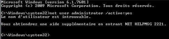

Hi Derek,
after opening the Habi Image Editor (Img1.2-eng), when selecting "disc" "Open disc" I got the message (apparently from the Image Editor itself * ) :
"There is no administrative privileges"
and I do not know how to do to correct this ? **
* I suppose that the error message is generated by the program, because I tried also other versions and got a similar message in spanish.
** somewhere on the internet, I read that when you are the only user (thus administrator), you don't initially have the "rights" but you may acquire them with the command : " net user administrator /active:yes" but it doesn't work.
Thank you for your help.
Polka
Polka

Re: Announcement - new QL Interface
Have you tried to right click the program and then select "run as administrator" from the menu ?
Thank's a lot ! indeed, it was so simple (when you know...
Polka
