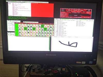

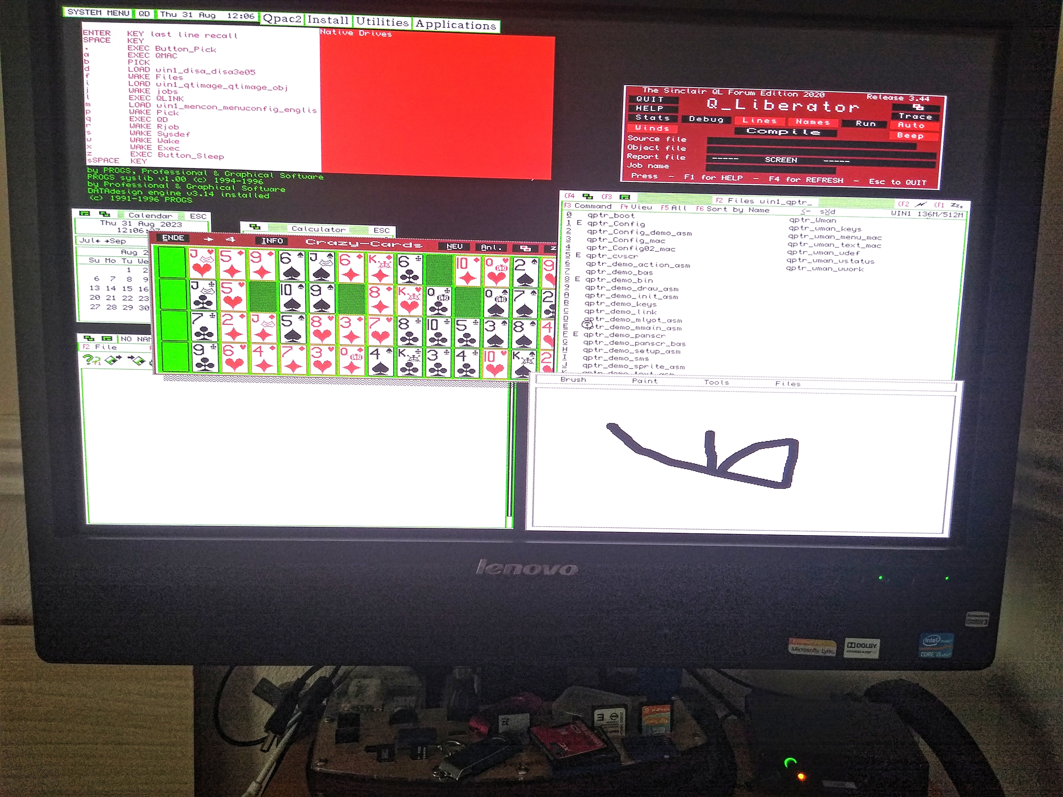

I have had some time to use my Q68, which, I like to use the Q68 in screen mode DISP_MODE 4 (1024x768 Mode 4) or DISP_MODE 6 (512x384 Mode 33)
Here is a picture of the Q68 in DISP_MODE 4 on a Lenovo M92 All-in-PC in monitor mode, running a few applications
