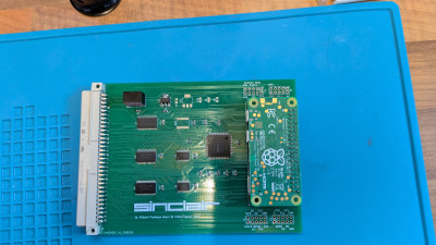

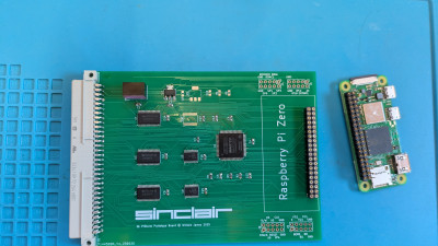

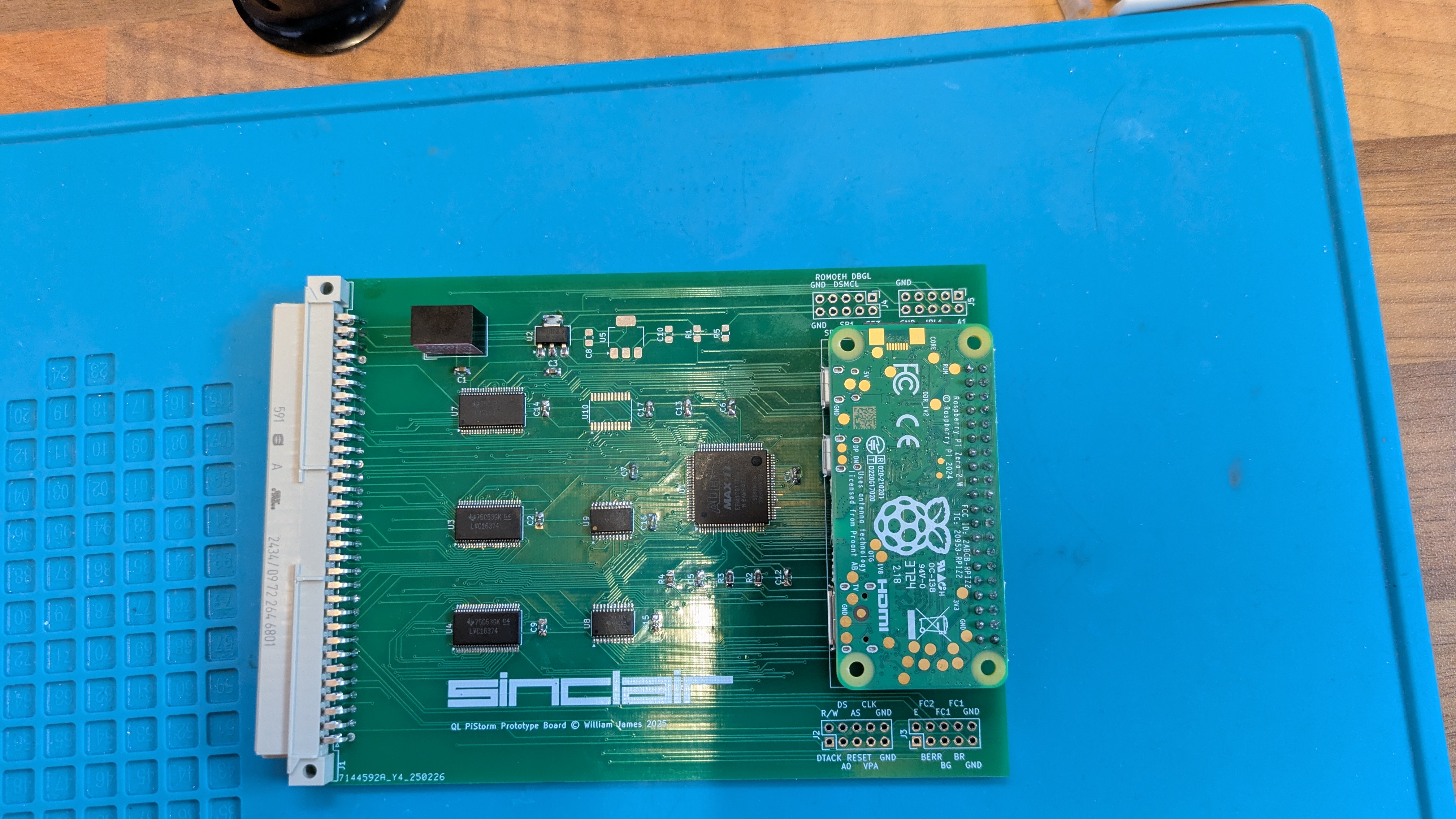

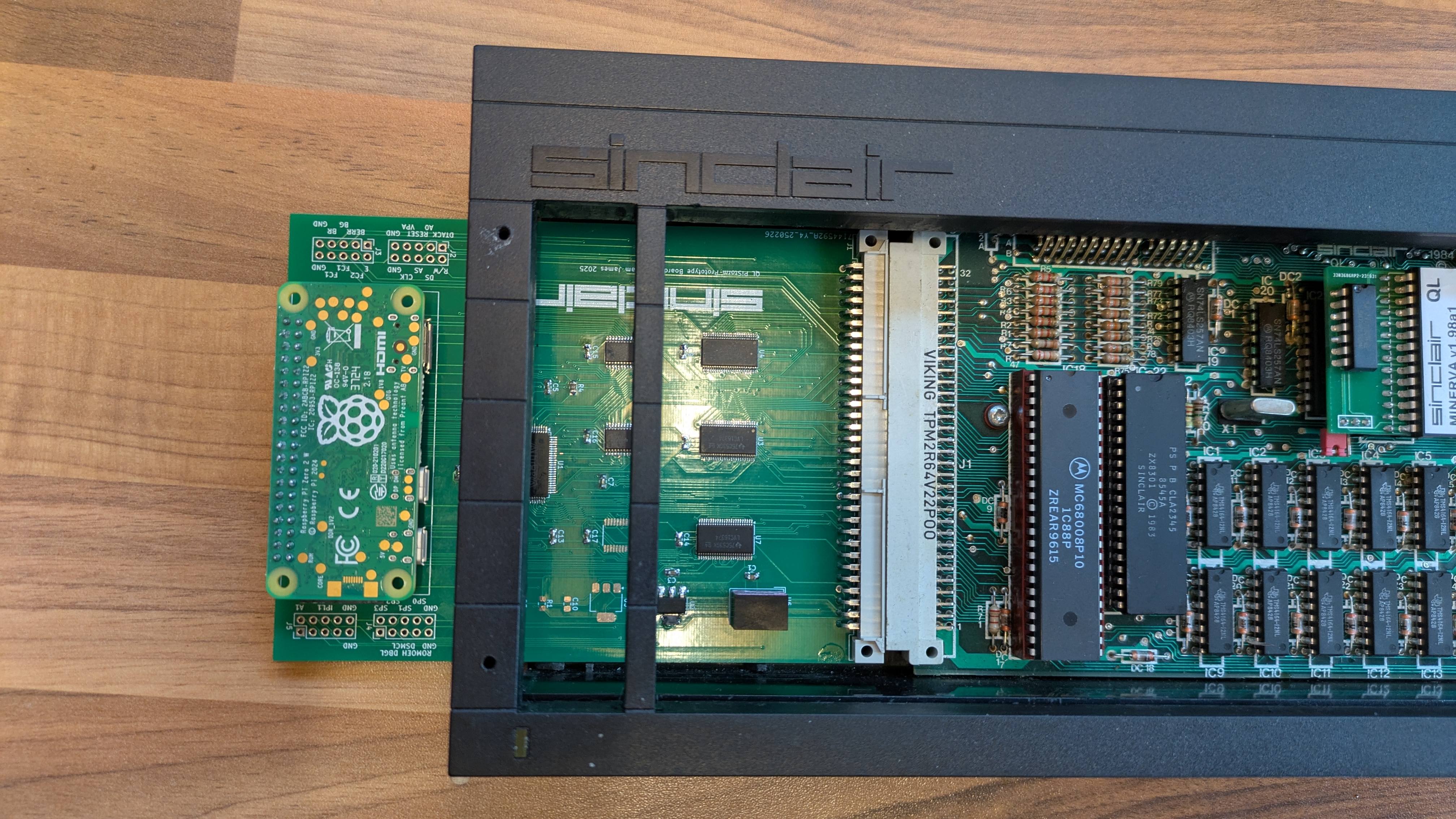

Progress today - I have soldered all the bits on and modified the PiStorm Source code ps_protocol.c so that it only does 8 bit reads and writes... First I need to rewrite the test program buptest.c so that it reads and writes to the QL memory and perhaps writes something onto the screen. This will test out the actual hardware interface. I was thinking it might be nice to have the QL PiStorm as an expansion card but with a floppy interface on the board too rather than trying to fit it internally into the 68008 socket. I think it would require an unsightly wire to the 9v supply or a replacement of the 7805 with a 2A Traco Power thing. Anyway, I let you all know whether it blows up my QL test rig in the next couple of days. :D

Your QL PiStorm , looks good.
Using the QL expansion port is a good idea, all the signals required are available. Where as, the CPU socket has some signals missing.
I have a 2A Traco in place of the QL 7805, does away with the heat sink.
