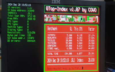

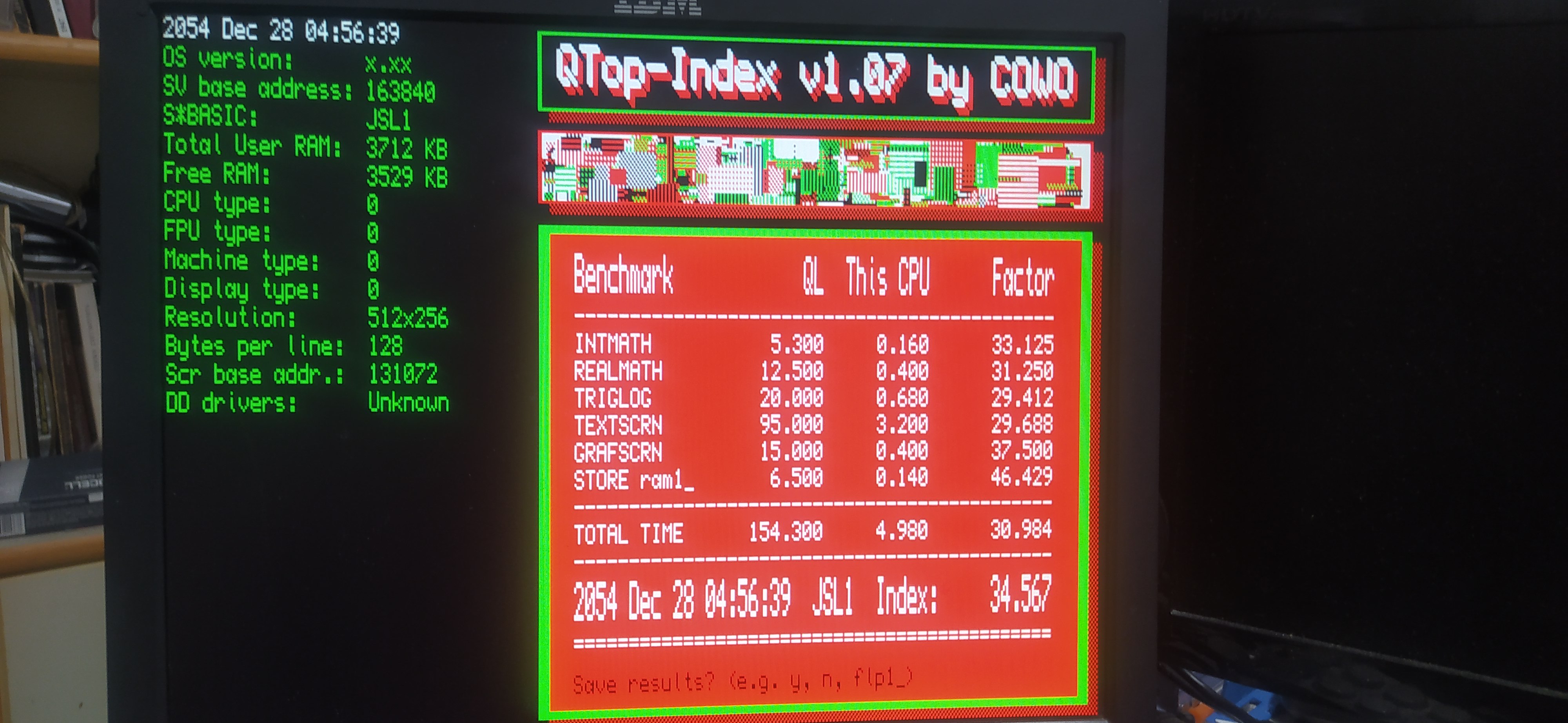

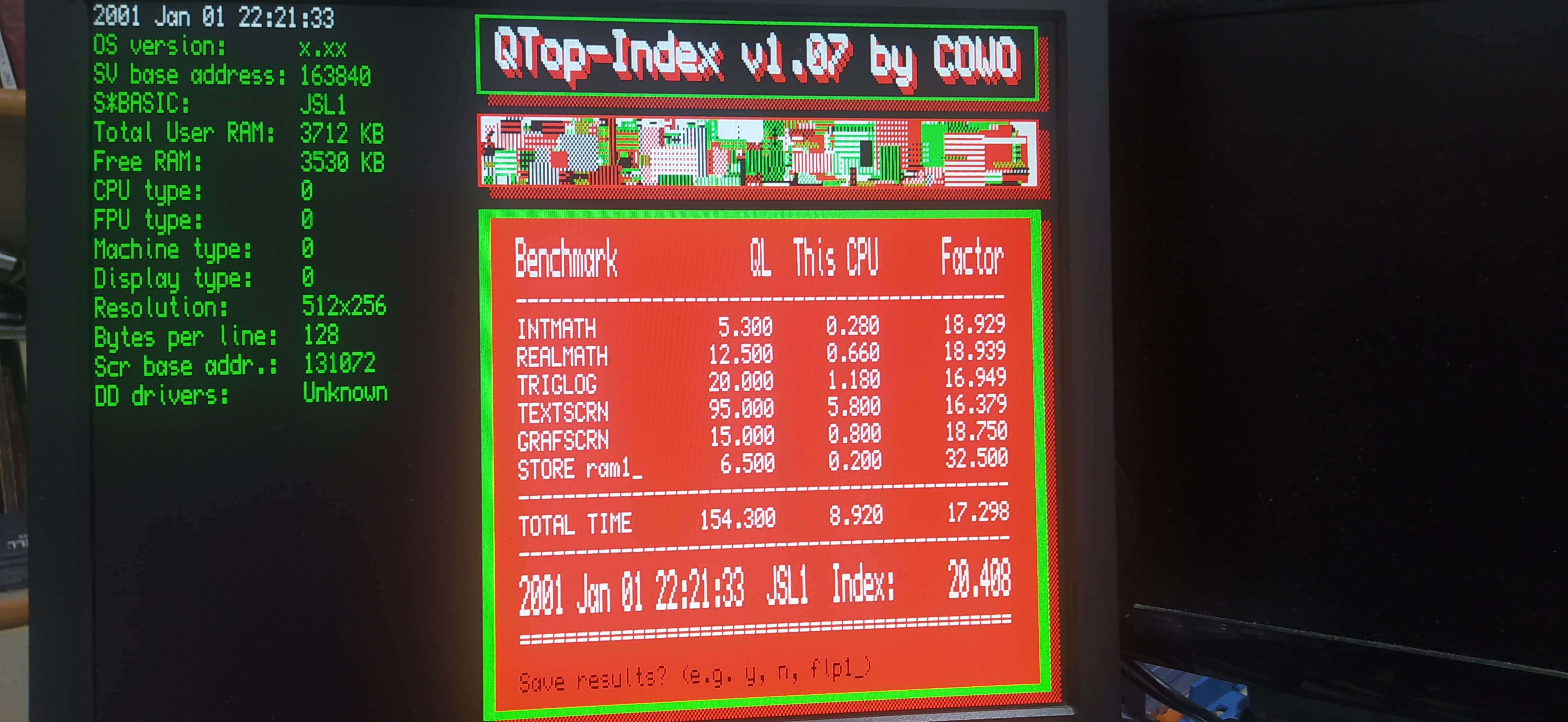

I did a little increase in speed.
lliont
Posts: 330
Location: Athens, Greece
Re: QLion Gold Card
Post by lliont »
and a bit more
lliont
Posts: 330
Re: QLion Gold Card
Post by lliont »
and now
