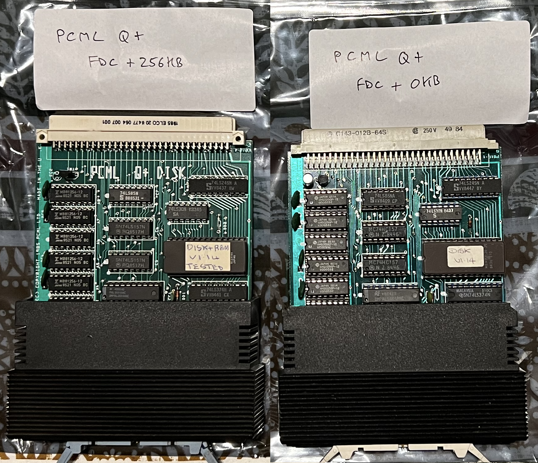

Interestingly, although the layout is the same, the boards are a bit different
(also the 0k board has all the chips socketed, in 2 different colour sockets, but I'm thinking someone may of done that)
Posts: 1681
Re: Memory IC's for PCML Q+?
I see some obvious component difference on both boards, wire link vs diode, missing capacitor, and possibly missing diode on right hand board, its a bit blurry to tell.
Are you sure the rams have power supply and that wire link isnt pulling chip select to 0 or something like that?
Posts: 1024
XorA wrote: Thu Feb 20, 2025 5:27 pm I see some obvious component difference on both boards, wire link vs diode, missing capacitor, and possibly missing diode on right hand board, its a bit blurry to tell.
I don’t really follow as I know very little about electronics
The board with the missing capacitor and wire link is the good board
I could have another go at imaging them?
Posts: 1681
Swapping the PALs between boards would be an obvious test!

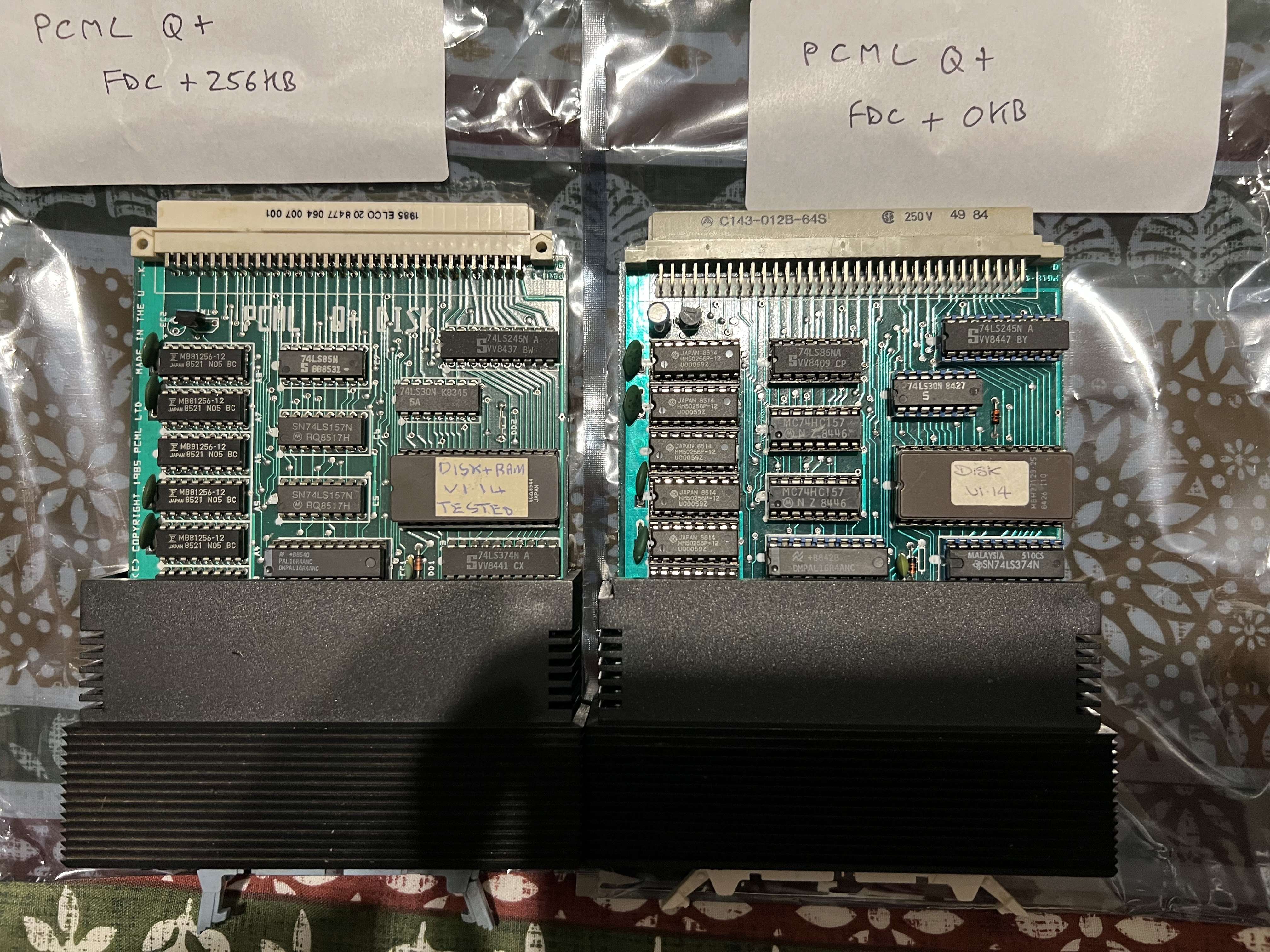

Hopefully this is a better image
Posts: 1024
XorA wrote: Thu Feb 20, 2025 5:44 pm Swapping the PALs between boards would be an obvious test!
Good point, will give it a go
Posts: 1681
t0nyt wrote: Thu Feb 20, 2025 5:44 pm Hopefully this is a better image
Thats much better, the hardware gurus should be able to analyse that better!
Posts: 1024
I put the PAL from the 256k in the 0k board and it became a 256k board (according to Minerva)
I couldn't get the PAL from the 0k board to work in the 256k board though (got black and white stripes or nothing)
Put the PAL's back in their original boards and 256k is 256k & 0k is 0k (as expected) so I didn't damage them it seems

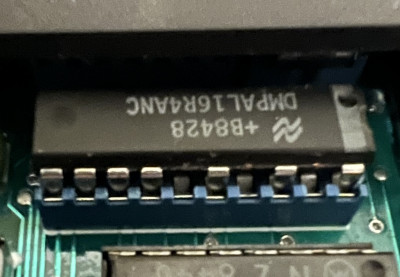

But I noticed something I hadn't noticed before, the 0k PAL has 3 legs cut off...
Posts: 1586
I suspect if you 'joined the missing legs' it would work in the other board too
Posts: 1024
Pr0f wrote: Thu Feb 20, 2025 6:55 pm I suspect if you 'joined the missing legs' it would work in the other board too
It did cross my mind that putting the legs back was worth a try
Am not sure there’s enough left to be able to solder to though, but I’m willing to give it a go in the next few days
