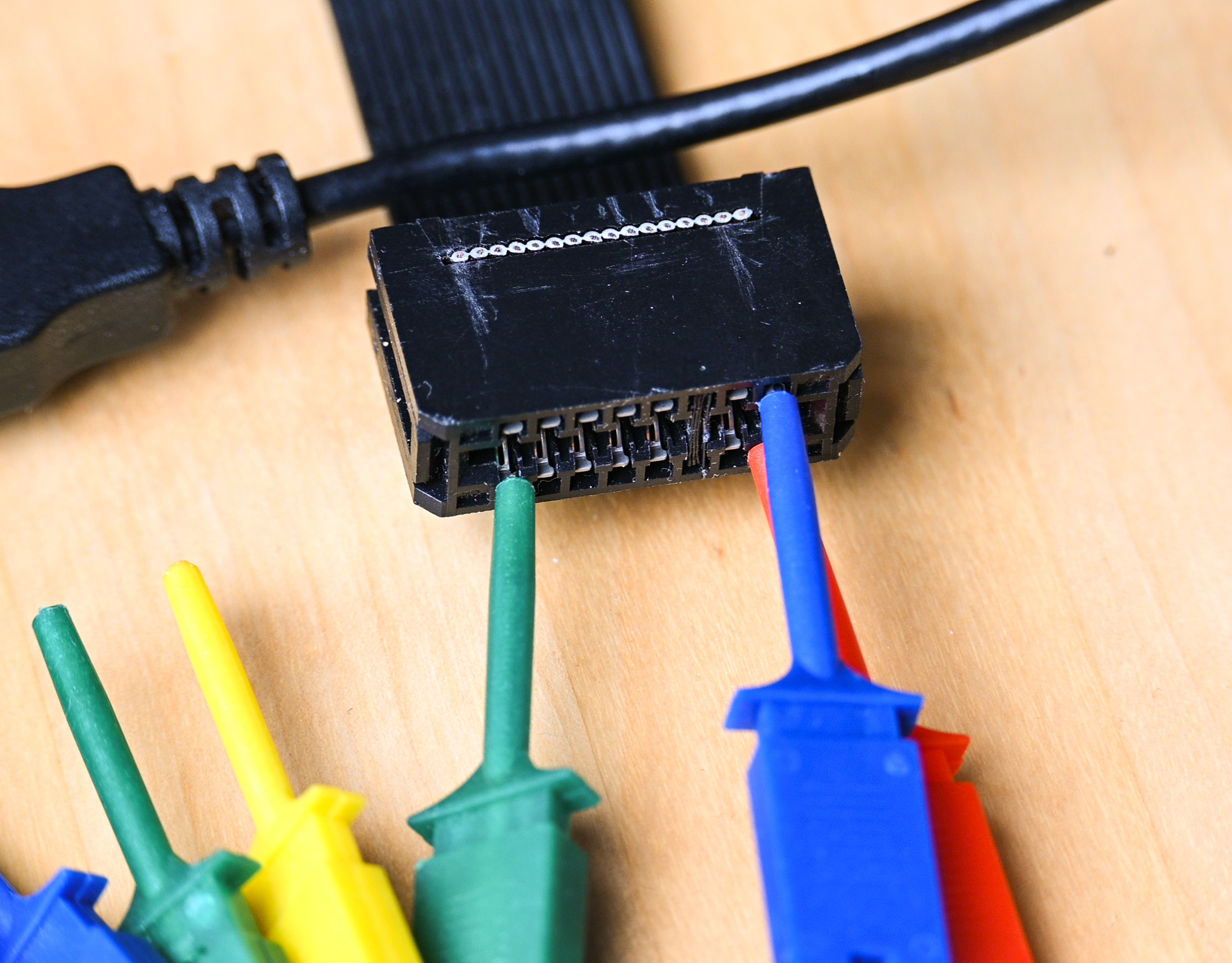

Here is how I connect to the mdv data tracks using a microdrive cable: The connector at the end of the cable has eight contacts on each side, but the third from right is not connected as it corresponds to the indentation on the edge PCB connector of the QL.
The first contacts on the right (blue and red, upper and lower) are the microdrive data lines, I connected the lower one (first track) to channel 0 of the logic analyzer, and the other one to channel 1. Also connect GND (green) to either one of the contacts on the left. No other connections are needed.

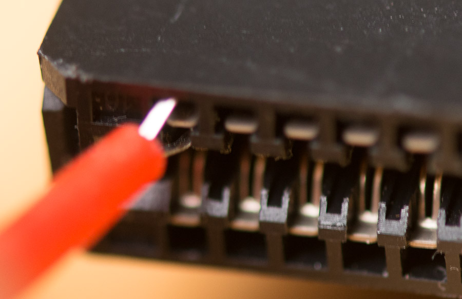

In my case, I inserted the hooks this way, but I guess your connector has a different geometry that prevents it:
Re: 68K/OS "ROM" based disk attempt
My hook ends look much thinner than yours, I think that might be the problemM68008 wrote: Fri May 10, 2024 4:46 pmFor outside, you can get some kind of edge connector and connect the probe to it. Or if you are opening your QL anyways, we could find the ULA pinout.t0nyt wrote: Fri May 10, 2024 9:06 am Hi Daniele,
I think I have all the Hardware & Software ready to go BUT I can't get the "hooks" to latch onto the MD cable
Any thoughts on what else I can do please?
I’ll take a look on Amazon for a different set
