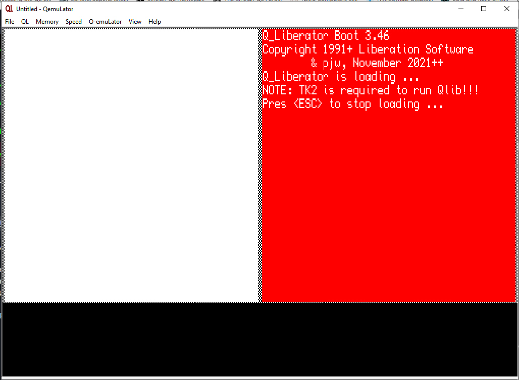

Im not sure about your preconditions. Did you get the systems variables pointer first? If you did, it should work every time.
At first run I always get the message "TK2 is required to run QLib!!! Press <ESC> to stop loading".
I press Space or Enter, and everything loads and works correctly.
Tk2 is loaded.
using TK2_EXT command before running your boot file makes no difference.
QEmulator is using Minerva198 (min198_qem.rom) and TK232.rom, 4Mb RAM

Andrew wrote: Mon Mar 25, 2024 3:19 pm <>
Tk2 is loaded.
Thanks Andrew. Its a bit of a conundrum. Some changes are going on in the OS that I had not
anticipated, and have yet to understand the reason for, or to find a way around it.
If you print out the value of a6 on the first go you get one number, on the second it returns
a different value. This occurs even when nothing obvious should make it so; no toolkits
loaded, no jobs started or removed. Strangely, this behaviour has not shown up in different
contexts, like if you loaded a file containing only the FindKey function, getting the SYSV, and
invoking FindKey('TK2_EXT') it works as intended. Also, this only happens in Minerva (1.98,
havent tried any other).
Im sure I, or someone, will figure it out eventually, but Im done for now. In the meantime
just write your own boot script. Its simple enough: TK2, ENV_bin, Qlib_sys and optionally, set
QLIB_USE as per your environment.

pjw wrote: Mon Mar 25, 2024 5:27 pm If you print out the value of a6 on the first go you get one number, on the second it returns
I also tryed with Minerva 1.97 and TK2 2.36 - same behaviour.
Also the strage behaviour has not shown up when I used Findkey in a different program :shock:, nor with JS rom or SMSQE
I already had a boot for using QLiberator, as I load qlib_run and env_bin in the main boot, but I was interested more in your FindKey function, to use it in a program instead of loading exists_bin, and that's why I noticed the strange behaviour.

Under the assumption that SuperBASIC moved at some point during the running of the boot program, for reasons unknown, I thought pre-empting it before obtaining a6 might do the trick. And it appears to have worked. Basically:
IF version$ = 'JSL1' THEN
 REMark Minerva
 DIM t$(9000): DIM t$(0): REMark Nasty kludge!
 SYSV = VER$(-2)
ELSE
So for anyone still awake and interested, replace the current boot file with this:
QlibBoot.zip
(1.73 KiB) Downloaded 109 times
Please let me know if there is a problem (or not).
