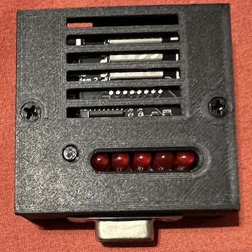

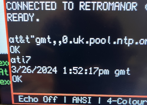

I'm nearly in business
Wi-fi modem has arrived and is connected to my wi-fi and QL
And (after issuing a AT&T command to setup the NTP server) I now simply have to issue an ATI7 command to get current date/time
Still trying to find more details on the AT&T command so I can set the best timezone (given BST is on the way) and more importantly setting a better date/time format (my guesses haven't worked so far)
EDIT: sussed the format %dd/%MM/%yyyy %hh:%mm:%ss, now to sort the timezone (as BST is several hours out!)
