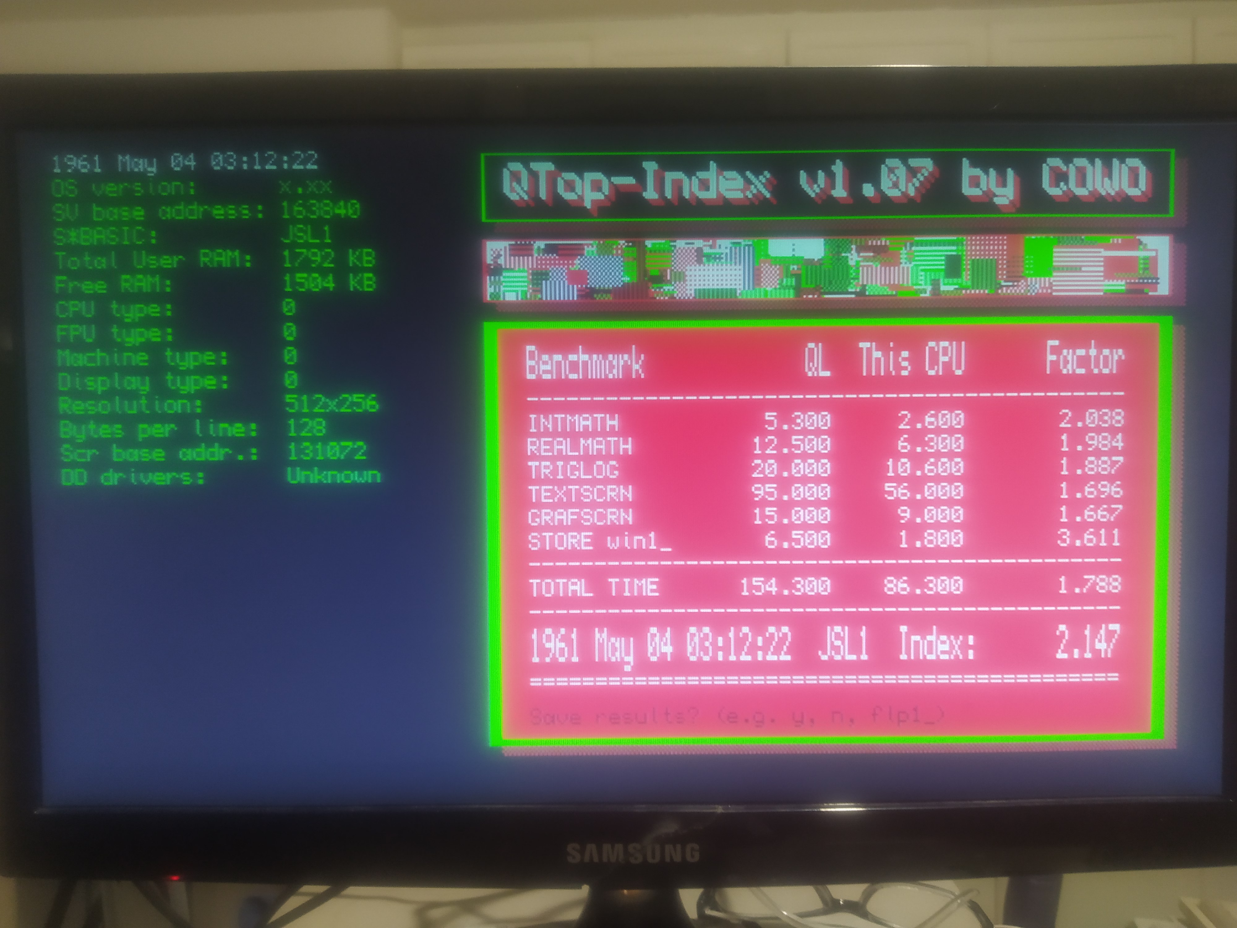

I adjusted the video for 10Mhz and I run at 10Mhz without a problem (other than that zx8302 runs also at 10Mhz).
Here is a benchmark
Here is a benchmark
