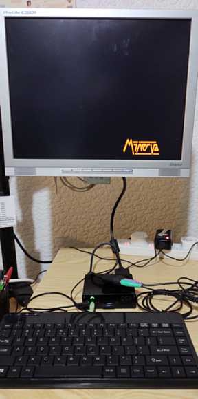

The Minerva4Q68 startup stops at random points before it gets to the F1/F2 keypress. Sometimes, only one or two letters of the message appears.

dilwyn wrote: Sun Jun 11, 2023 8:12 pm The Minerva4Q68 startup stops at random points before it gets to the F1/F2 keypress. Sometimes, only one or two letters of the message appears.
This suggests that the keyboard driver interrupt keeps hanging in a loop.

Patching neither the Q68_ROM.SYS nor the _rext version fixed the issue, but there is now a consistency in how far it gets. Every time now it stops after displaying the Minerva logo. If left for a few minutes, it disintegrates into random patterned screens.
Keyboard and mouse attached via Derek's PS/2 splitter cable.
Have tried with the keyboard plugged directly into the Q68 (no splitter cable), just the keyboard plugged into the splitter (no mouse), and reversed keyboard and mouse (in which case the startup stops just after the ROM check and CLOCK messages before it gets to the booting from ser message).
Keyboard and mouse work fine in SMSQ/E.
Minerva4Q68 startup
Minerva4Q68 startup

dilwyn wrote: Sun Jun 11, 2023 11:08 pm Patching neither the Q68_ROM.SYS nor the _rext version fixed the issue, but there is now a consistency in how far it gets. Every time now it stops after displaying the Minerva logo. If left for a few minutes, it disintegrates into random patterned screens.
Looking at the source code of SMSQ/E it appears that in v3.36 the keyboard handling code has been changed to use external interrupts in addition to polled interrupts. This might explain why Minerva hangs on your Q68; it only uses polled interrupts to read the keyboard and when an updated version of the hardware generates an external interrupt there won't be a handler to serve it, so it returns without clearing the interrupt and keeps looping forever.
Since Minerva appears to crash already before you've got a chance to press F1 or F2, there might also be some problems with hardware initialisation. The problem is that external ROM's initialisation code only gets called after Minerva has initialised the hardware and the machine is already in user mode and with interrupts enabled, so when the Q68 has already asserted the external interrupt the machine will lock up before the extension ROM even has a chance to respond to it. To fix this, the hardware initialisation code from SMSQ/E has to be backported to Minerva. Not a big deal I expect, but this requires a careful look at the SMSQ/E source code.
I'm sorry to have bothered you, but it appears that not all Q68's have been created equal...
