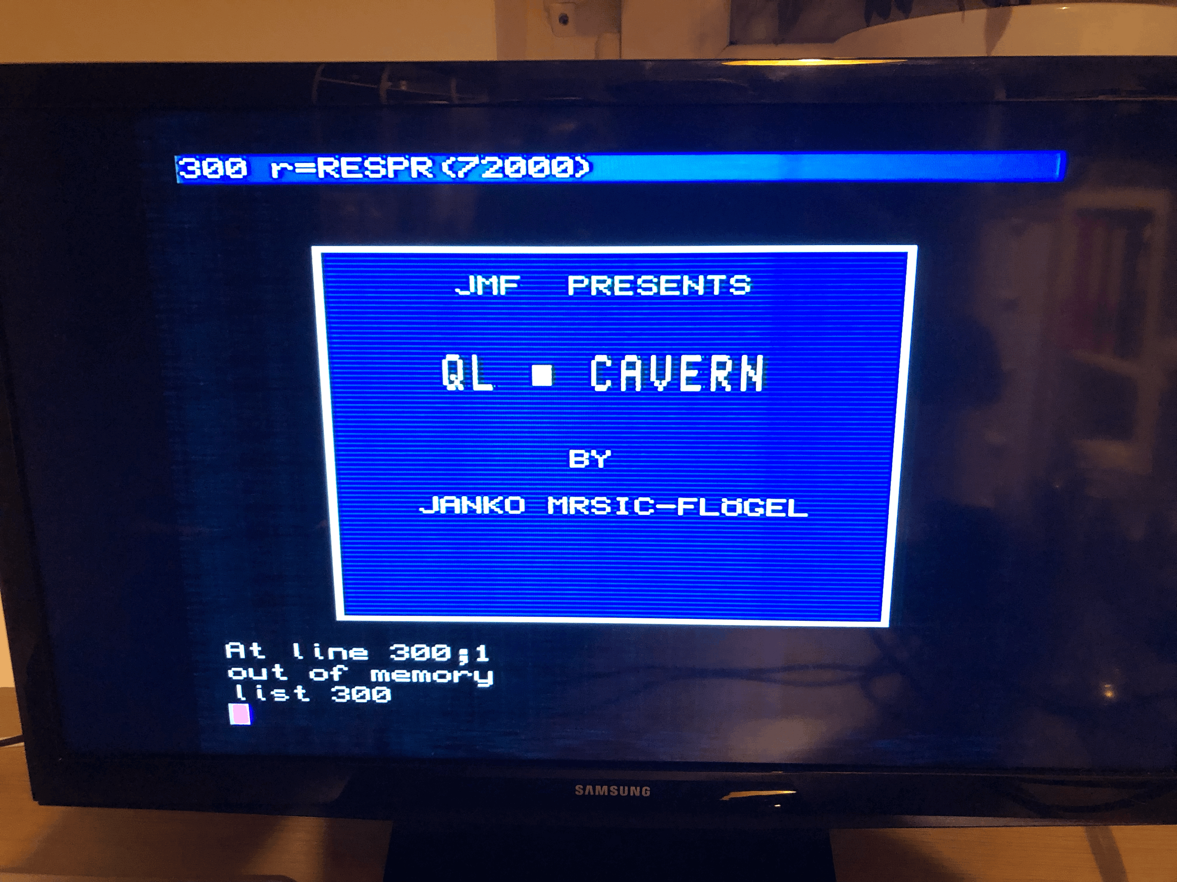

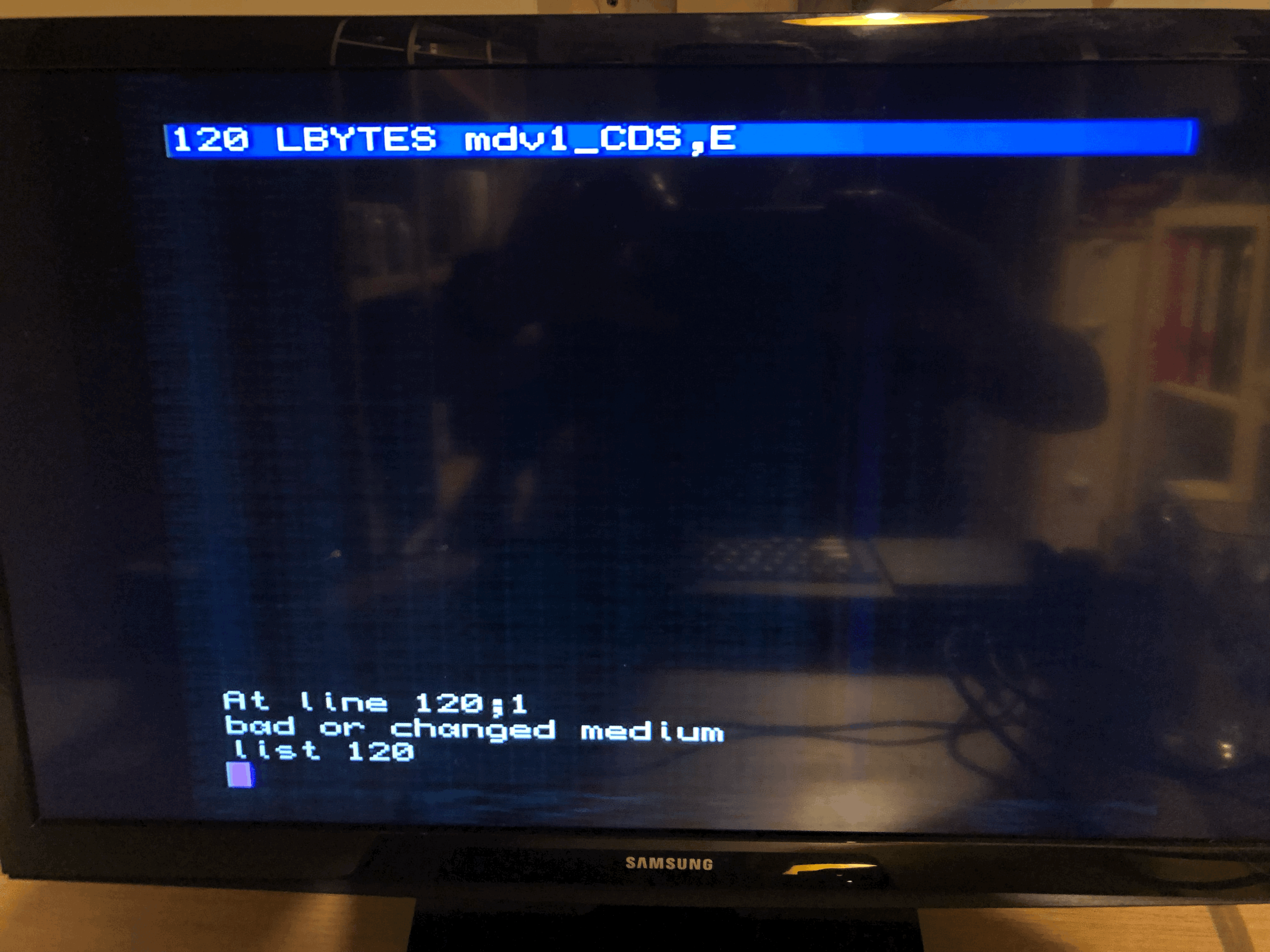

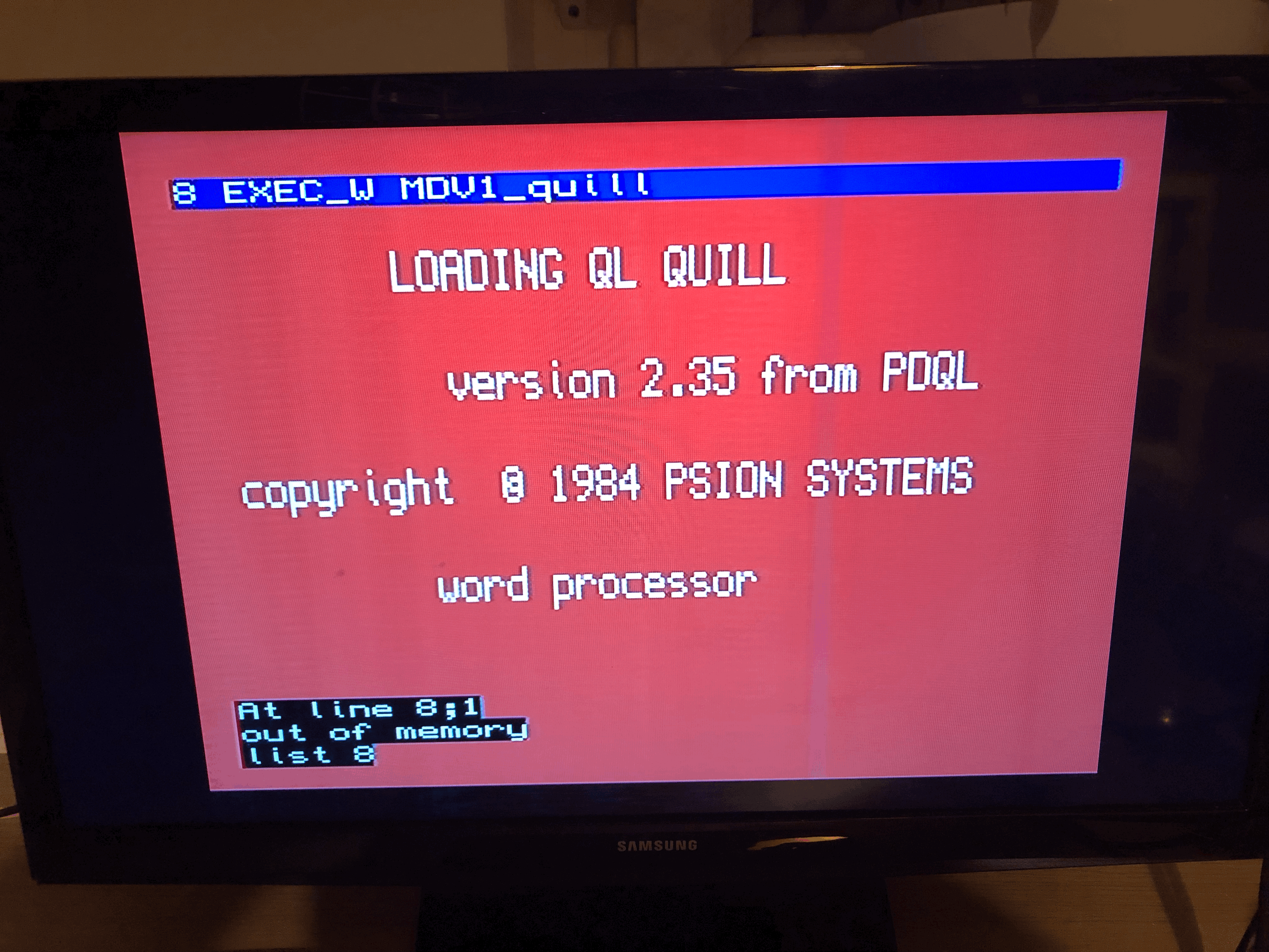

Hello everybody,
after some time I am back with more info and some additional help for troubleshooting.
As many suggeseted I got in touch with a colleague who undertook the necessary mods to the Issue 5 board and he did a great job.
But surprise, surprise - things are still not 100% OK.
With Minerva ROM my QL wouldn't load from the vDrive nor from the MDVs. I reverted back to the AH ROM and things improved 50%. Suddenly, my vDrive was fully operational, whereas MDVs would still not load programmes.
I have to mention that removing Minerva I broke the pin on the upper right side. (I know, I should have used the ROM extractor but don't have one yet.) Anyhow, I think the pin was OK before so I would rule that defect out.
The situation with AH ROM installed is now the following:
- I can load nearly all files from the vDrive (there are some excepions like Spook but I had a problem with it before);
- MDVs seem to roll ok - there is no problem loading shorter SBASIC files;
- I can even load Metacomco Pascal, in connection with its own ROM;
- but I have problems with most MDV programmes: they might load the intro screen (HyperDrive or 3D Slime), or a part of the programme in SBASIC (QL-Decision Maker), however the loading process would end with a long beep, reset, infinite loading loop or mostly with a message "out of memory" (I attach some typical screenshots);
- it seems there is a problem with memory - out of memory message is usually linked to RESPR or ALCHP functions;
- there does not seem to be a RAM problem - Minerva showed the standard 128K setting was ok and, in any case, (same) programmes do function well if I load them from the vDrive.
I guess many are wondering why do I bother with MDVs while I have the vDrive functioning (with AH ROM). True, but I have some programmes on cartridges and would still like to use the original QL funcionality.
Any ideas of what is going on would be greatly appreciated. Thanks!

- Posts: 4840
Re: Problems with/after ROM replacement, vDrive and Exapanderam
The problem maybd related to the broken pin on the Minerva.
But Minerva should improve the Microdrive access, as AH rom is full of bugs.
Do you have the 2 resistors on top of the 8302? This improves the microdrive reliabiliy.
Thanks Derek, will fix Minerva and put the resistors on the top of 8302 - hope that will solve the problems.
