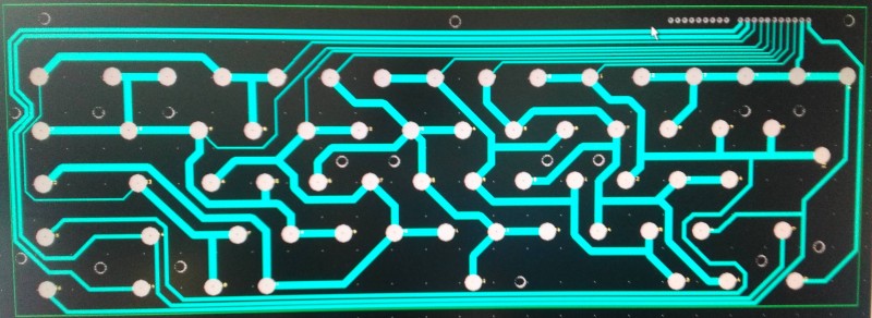

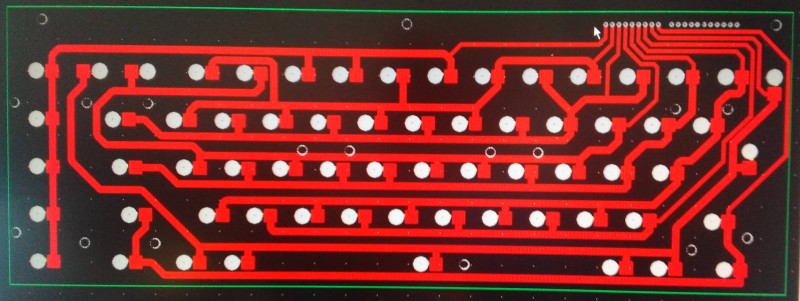

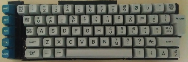

Thanks to Zer0_lag it gave me renewed impetus to continue the Hall effect keyboard since it doesn't need extra circuitry as well as the fact I forgot how expensive one off PCBs were like £120 for one and £150 for ten. :o I finished the metal work hacking as in the picture that was ten times more difficult at mum's flat, where I am her carer 24/7, using a junior hacksaw, a pair of pliers, a hammer & a drill bit in a chuck but no drill. :roll: Today I have the easier task of cutting the ends off the PCB to fit between the metal end plates that are the flanges of the old mounting method. I bent the flanges down to form a nice pair of legs to keep the PCB off the deck and so I could bolt the five blues keys on the end as the QL function key. Worked out nice so far but a lot of wiring to come. :)

Not sure what you mean but the matrix I was given or took from a manual didn't match my membrane so I just copied my membrane because that was working. Having created a PCB layout as on the previous post I am using it to show me the 9 & 11 way connections by switching one layer on at a time as in the pictures. The hall effect switches have no contacts so never get tarnished or wear out. It seems from what No_lag said they do have an input & output as well as 5V so I have to get them round the right way.

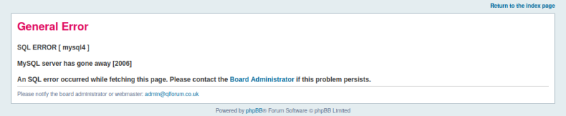

Why is the forum doing double posts from you and Nasta? I sent a pm to Rob that I get SQL errors with lost server etc after I post but I don't think he read it yet. See pic.
