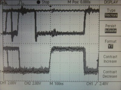

This picture shows the ROMOE signal on my SuperGoldCard QL, which is used as an imput to QL-SD. The horizontal dotted line is the maximum allowed low level TTL voltage of 0.8V. The measured signal illegally goes up to 1.5V where logic level is low. The oscilloscope has a bandwidth of 60 MHz only, so the spikes visible to a >300 MHz PLD might be higher.
The 30 year old circuitry of the QL was too slow to see this, so the fault did not have immediate effects. But the QL-SD uses a contemporary PLD, with over 300 MHz maximum operating frequency, which considers it a valid ROMOE signal and does unexpected things. Other signals than ROMOE are also far from perfect.
Quality of ROMOE is better on a standard QL.

Best get some 220Ω resistors and 47pF capacitors then to low pass the filtor the signal...
Follow that with a schmitt trigger input and plug and pray :P
Yes, I know, it's never that simple :-(

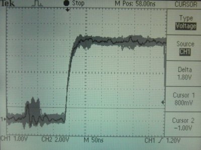

And here's one of the examples why: Noisy low-level address signal at 1.2V during ROMOE active-high. (Scope has persistance on, address signal on top.) To deal with this kind of noise, the adress line is sampled at ROMOE rising edge, where there is less noise. Now if ROMOE is delayed by filtering, the adress line might get evaluated at the worst moment.
In the next step you'd filter every address line. ;) I was posting this because Dave asked for details, and also as a warning what needs to considered when using modern PLDs. I do not lack ideas what could be tried, but the design is finished & well tested on the standard QL, so I won't rip up the whole thing again. I have already invested far more time than reasonable. And Adrian Ives as well.

Yes, with digital signals, correct timing is everything.
A question. Could some of the problems be due to a poor ground layout / tracks? Are you seeing a form of "ground bounce" where the voltage drop through the ground is helping to cause the voltage on the signal lines to be out of spec?
Mark

Thinking about my comments after hitting the post button, if the 'scope is grounded at a good "solid" ground point, probably not ground bounce :oops:
