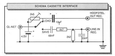

janbredenbeek wrote: The complete source and circuit diagram are here on GitHub: https://github.com/janbredenbeek/QL-Basicode
So reading this diagram, you need to add a 4.5 volt power source to the circuit to get it to work I'm guessing? Also, is that a 2.5K preset resistor I assume...so you have to do a little adjustment to get it to load properly?
The 2.5K preset provides a pull-up so the level is just around the transition point. There is an earlier thread about it: viewtopic.php?t=1179&p=38201#p38191

bwinkel67 wrote: If I don't build the interface right away, is there a concern of just sticking a mono speaker (perhaps amped) on the network jack (i.e. I don't want to blow any circuit in the QL but want to see what sort of noise/sound can come out of it)? It seems that the emulator instructions didn't quite require it but recommended it for better results.
The network ports are well buffered so a short circuit wouldn't do any harm, but it may be wise to put a capacitor in series with the speaker to decouple the DC component in the output signal.
