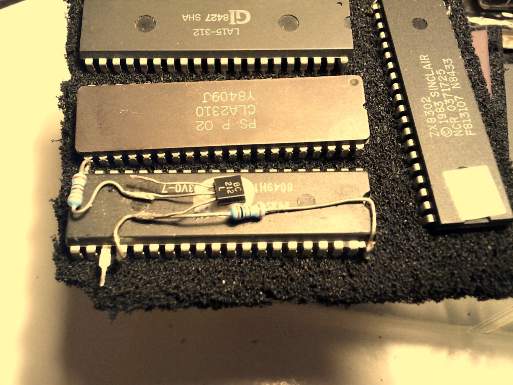

Silvester
Posts: 436
Re: CAPSLED
Post by Silvester »
It's a bit cruel, a PCB would be nice :)

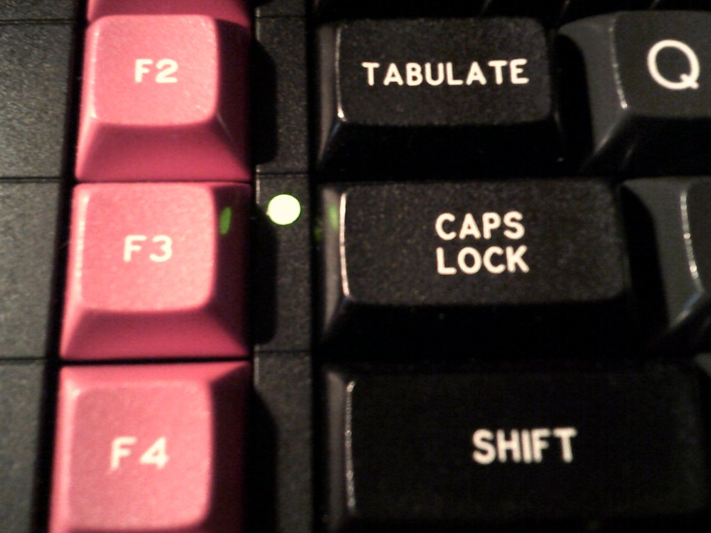

and while I had my cheapo camera out...
Green LED fits nicely even in Schon keyboard case.
David
Posts: 4811
Re: CAPSLED
Silvester wrote:It's a bit cruel, a PCB would be nice :)
Hi David,
That looks like my first attempt in 80s-90s, except I bent out Pin 24 unlike in your picture which you have Pin 23 bent out. What is the purpose of bending Pin 23 out?
I later did a veroboard version, that was too big to fit into a QL case, but I had my QL in a Memotech MTX 512 case with rewired keyboard matrix to suit the QL.

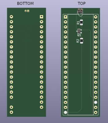

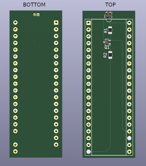

Posts: 4811
Re: CAPSLED
First attempt at PCB:
CapsLockLED PCB v0.01
Maybe the LED header could be horizontal.
Silvester
Posts: 436
Re: CAPSLED
Post by Silvester »
Derek_Stewart wrote:What is the purpose of bending Pin 23 out?.
Since both pin 23 & 24 are interrupt lines to CPU I also bent out other pin (it may have also been used on QL where I used a 74148 priority encoder to use level 5 interrupt). IIRC Hermes uses interrupt generated within ZX8302 from activity on COMDATA/COMCTL line.
David

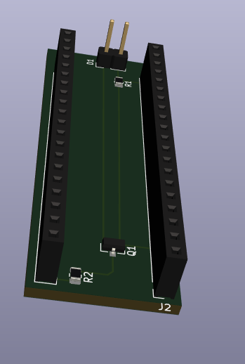

Posts: 4811
Re: CAPSLED
I revisited this, and updated the PCB layout to have Pin 23 not connected to the QL board.
The 3D view of PCB, without he Socket fitted is:
The LED connection is at the front of the board, this gives possible connection to existing LEDs or a new LED
