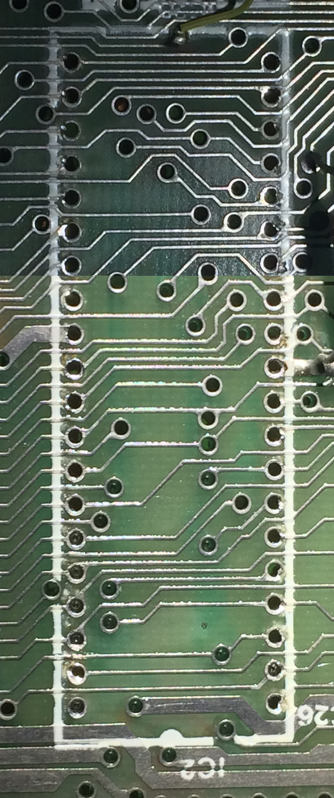

Martin_Head wrote:Any chance that you may have damaged one of the through plated holes in the PCB when removing IC's.
As you have changed the symptoms, maybe you have fixed the initial fault, and just added a new one.
I checked all the traces with multi-meter on the RAM chips before socketing them and the all checked out (it's a pretty set pattern so easy to check).
For the CPU socket I took pictures and that all seems fine. I actually took even closer pictures so anything that looks odd in this composite picture of two images is due to lighting that is cleared up at the closer ones. Of course I also inspected the races up close before taking pictures.
There are obviously damaged pads for the CPU pins on that picture (top righthand corner) and possibly even more damaged through plating on holes where pins used to be (which can't be seen in the pic but can be tested with a multimeter).
Posts: 1545
Re: Question about a non-working ZX Spectrum
Nasta wrote: There are obviously damaged pads for the CPU pins on that picture (top righthand corner) and possibly even more damaged through plating on holes where pins used to be (which can't be seen in the pic but can be tested with a multimeter).
I checked all the pads before socketing it. I also took more magnified pictures where, with better lighting, you can see they look good. Some of it is deceiving in this picture because the white mask melted and covered up part of a corner of some pads making it look like they are incomplete or gone and some is just left over solder playing with lighting. The other pictures get a much better view and there is little damage other than two places on the board that got too much heat and the board substrate chipped ever so slightly (but didn't damage the traces). Plus I have some even better googles to inspect the board at really close up and everything checked out. All the pads make contact as I traced all the lines. The worst of it is on the side that is showing since that's where the tip of the soldering iron heated up the legs of the bad cpu to get sucked out the other side.

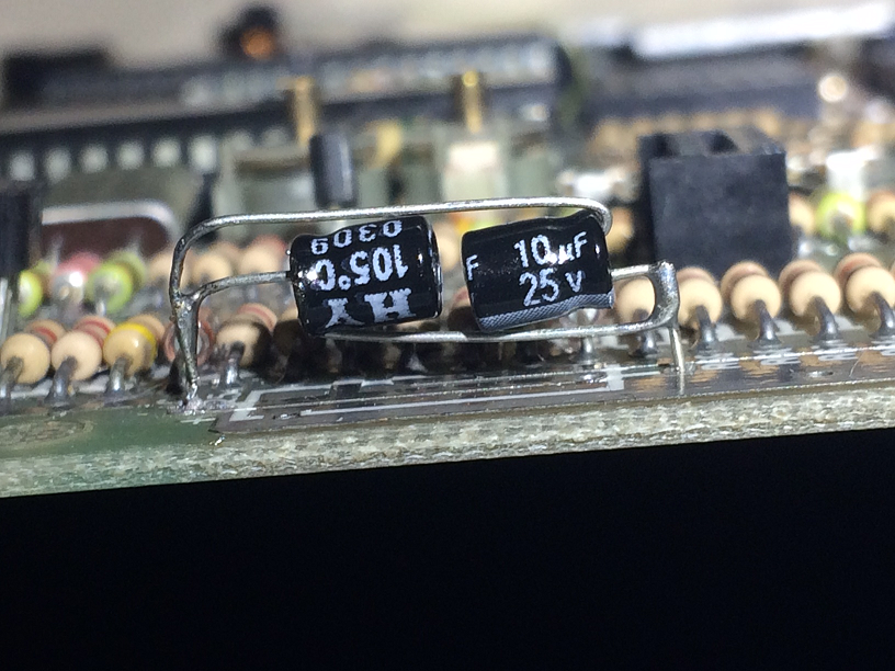

Ok, update. I recapped the board and replaced the two SN74LS157N since I had access to two of them (date code 1977). The whole board is socketed now as I ended up pulling the RF video chip just to be complete -- Interesting that without it plugged in the composite loses color so I guess it's not just for RF video. I didn't have 22uf caps so I built my own:
I may redo the cap's at a later date and find a recap set with more reasonable sized caps. All the ones I had I needed to be creative to get them to fit.

Posts: 2853
That photo is work of art! :lol:
Posts: 1545
vanpeebles wrote:That photo is work of art! :lol:
I'm naming it "Opposing Caps" in honor of The Falcon and the Winter Soldier.
