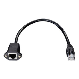

Maybe the inner side of the mini backplane needs be used, and a cable like this to bring the signals out. Not nice, but cables hanging out somewhere was QL tradition for several extensions in the past...

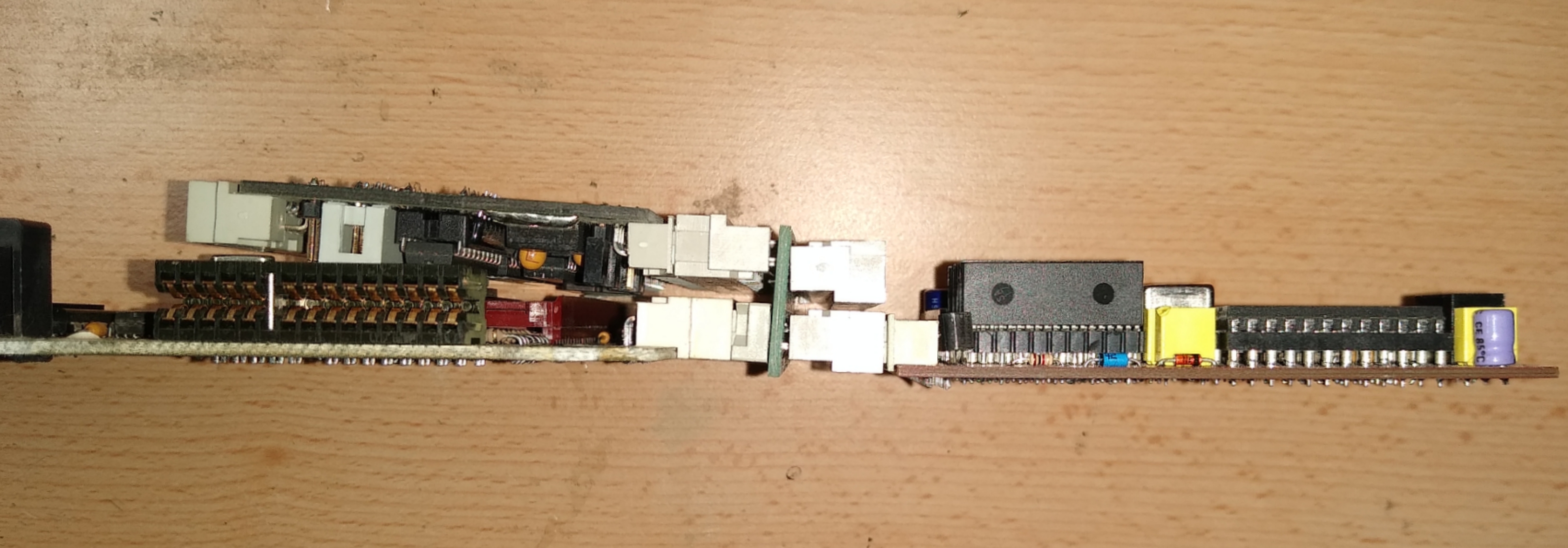

Really need an edge on view or if someone has one of these backplanes, a pic showing another card plugged in on top...

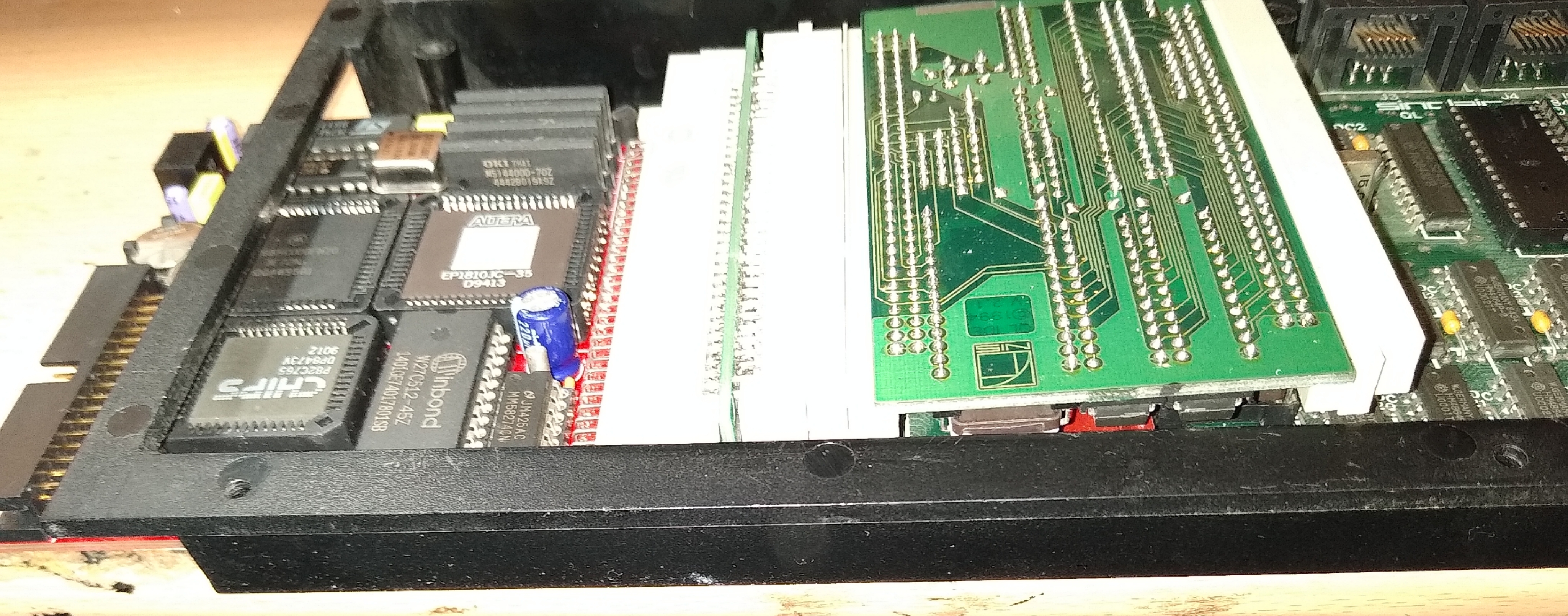

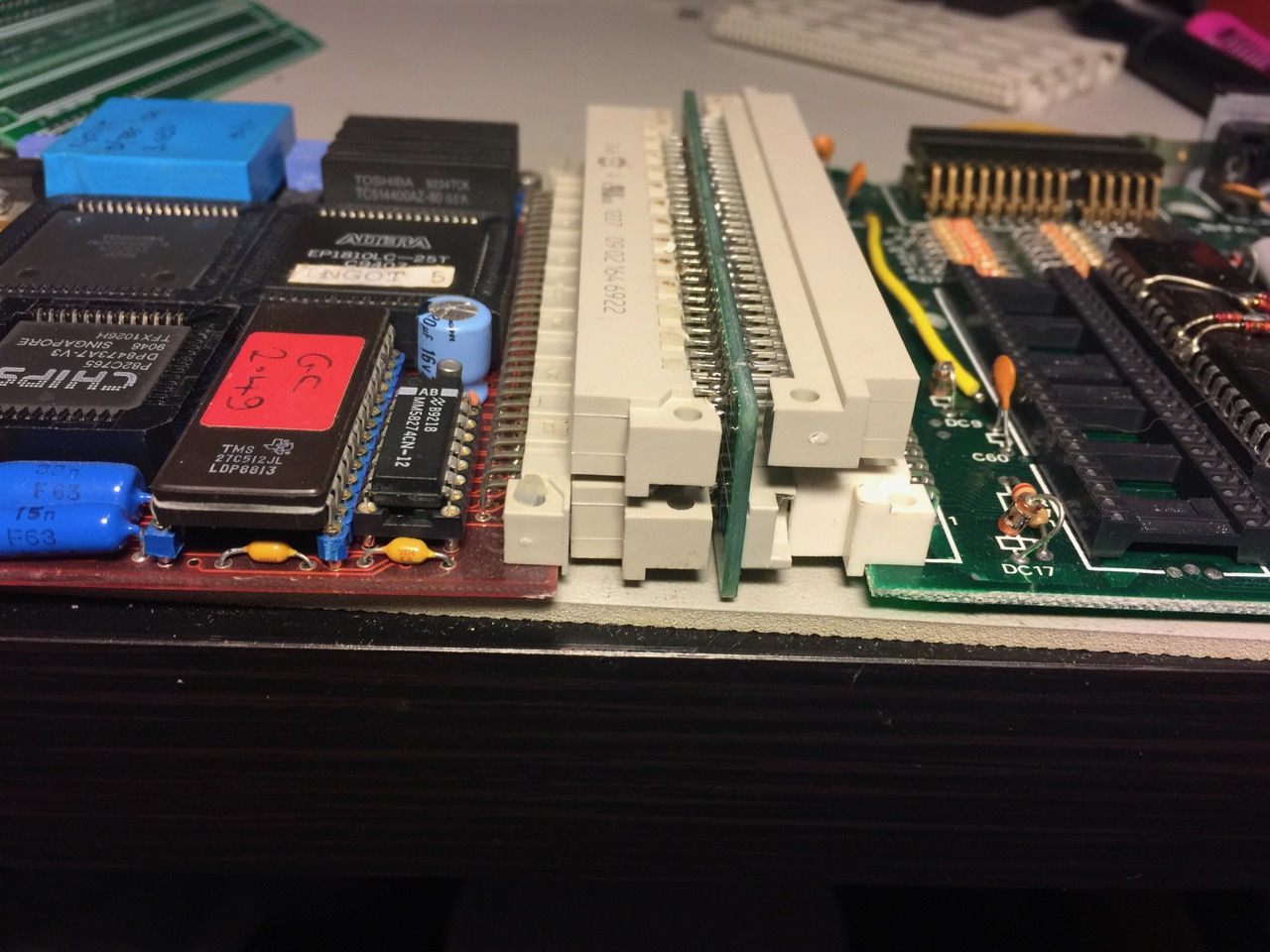

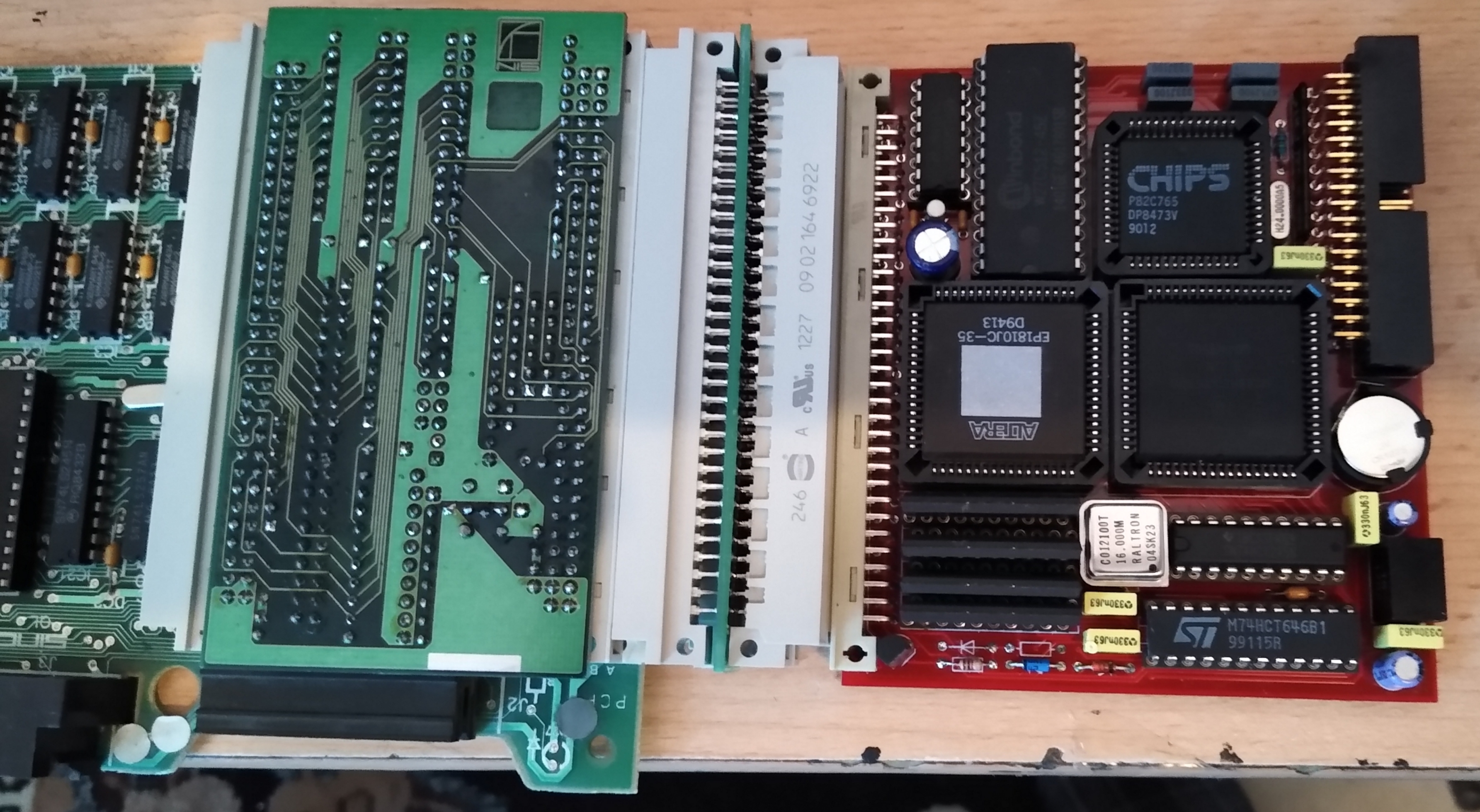

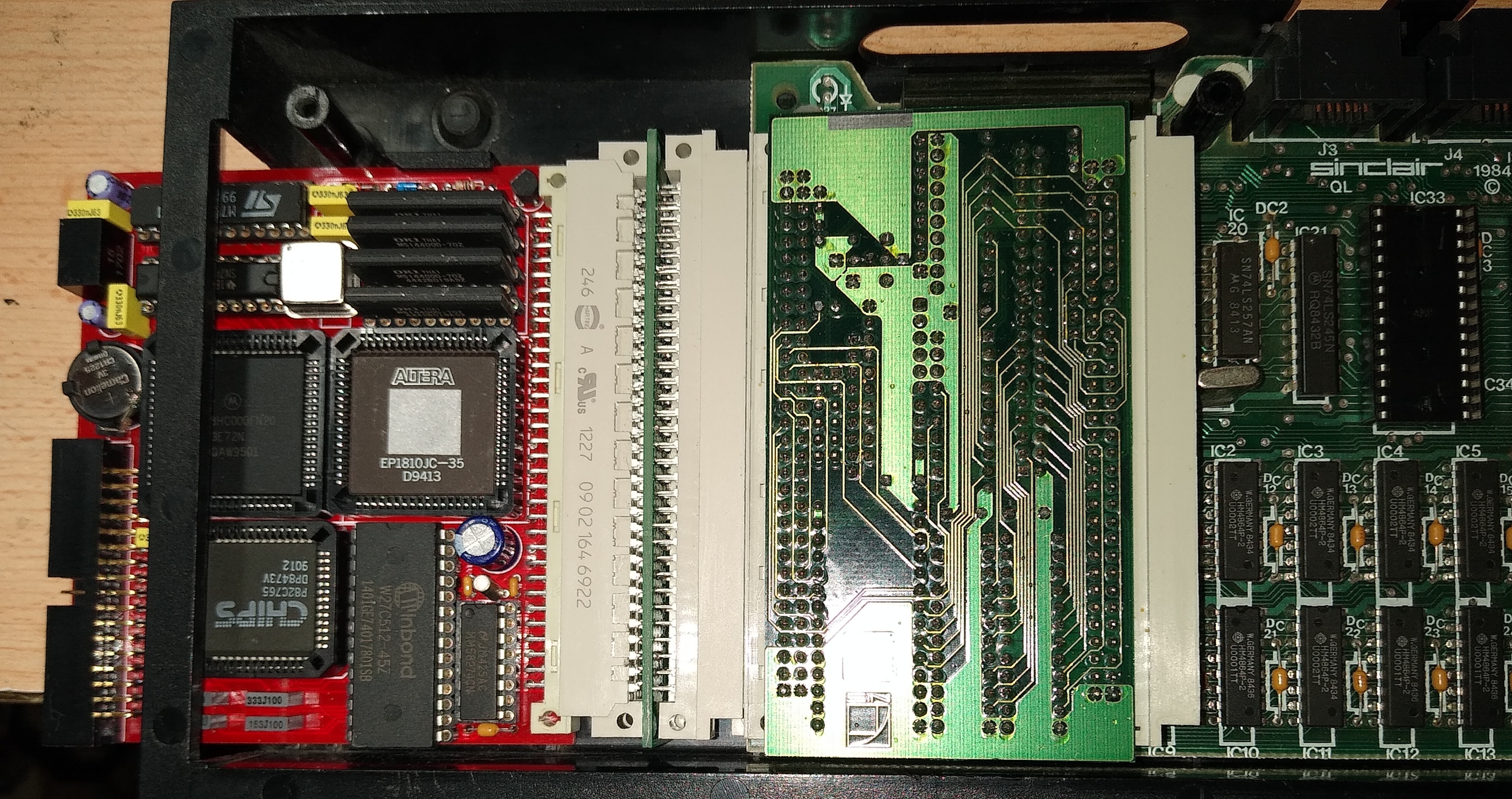

Here are some photgraphs of the MiniBack Plane with Tetroid Gold Card in main expansion connector and a Qubide inteface in the connector facing over the QL board.
The Qubide board is raised up at on end due the IDE conne tor.
I do not think the upper connector above the QL Expansion port is usable

The upper out facing port is usable with lower profile cards like the SQB, but no with the SGC etc. The in facing port is inverted.
