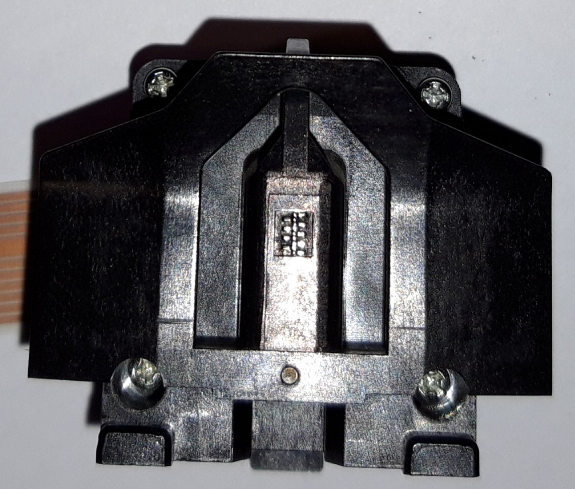

I have a spare SP800QL carriage/print head I can send you from Texas, for just cost of shipping. It is fully working. I also have a PCB same situation, and I think a QL-badged case top.

That's very kind of you Dave. I will certainly take you up on that - just the head if possible as my carriage seems ok (and to save postage costs).Dave wrote:I have a spare SP800QL carriage/print head I can send you from Texas, for just cost of shipping. It is fully working. I also have a PCB same situation, and I think a QL-badged case top.

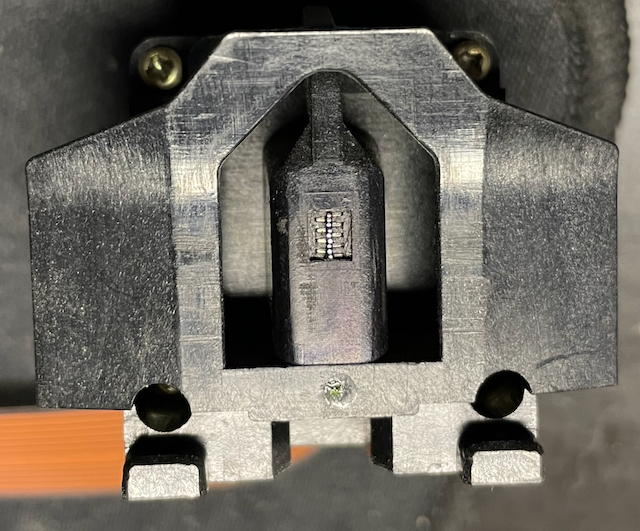

*digs*
This what you're looking for?
*digs*
- Posts: 1400
Re: ql printer repair woes
Yes, looks the same to me. Are the resistances between the centre 3 common connectors and the outer connections to the pins around 32 ohms?Dave wrote:Let me dig it out for you first before anything else.
*digs*
I wouldn't want to fit out without finding the problem on my PCB first though.
Three show open, one shows 1.8M, all the rest show 33. Working pull I did a test print on right before taking that pic.
