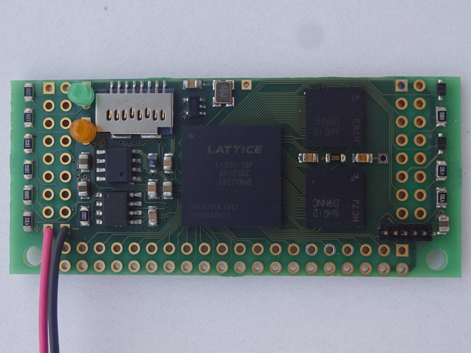

My problem with providing fixed geometries: The Qzero is a tinkering module with a long list of individual ways to use it:
  • Absolutely smallest "desktop" QL with just keyboard, video and microSD?
  • External QL mass storage device with QLNET and microSD card?
  • USB/serial to QLNET converter?
  • One or two network connectors?
  • With or without microSD card?
  • 1, 2 or more LEDs and which shape?
  • Plugged onto a baseboard to make it larger, more heavy and provide more connectors?
  • Use "large" connectors inside the case at all, or lead out the cables directly, like keyboards do?
  • Battery-based, since the Qzero consumes extremely little power?
  • Add a RPi Zero as hat?
  • Use the Qzero as a hat for RPi?
The list could go on... and every decision changes holes and space requirements. So the best would probably be if someone who decided for a specific use, and knows about the 3D printing constraints, also constructs the case.
For a quick shot, simply allowing 65 x 50 mm and 14 mm height as internal space could ba a compromise. Leaving the decisions for holes and connectors for later.
The absolute minimum would be 65 x 28 mm and 4 mm height. In that case, very thin cables need to be lead out.
This should not create the wrong impression I had already decided the Qzero will be publicly released. Still possible that I spare myself the trouble and provide it to friends only.

Hi Peter,
How about using header pins for the connectors, so a wired connection can be made to the physical connector.
Posts: 2452
Re: A small QL
Derek_Stewart wrote:How about using header pins for the connectors, so a wired connection can be made to the physical connector.
That's how it is. Standard 2.54 mm pitch. In most cases, it will be sufficient to use the smaller ones on the left (video) and on the right (peripherals).
