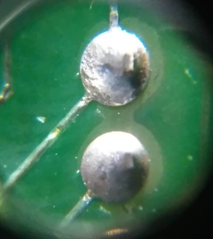

Some progress has been made but there appears to be many faults or at least more than one. I put the original processor back in with the dodgy A15 line while I am poking around the board and I found that there is something flaky next to the IC33 ROM and IC21 buffer. I took a picture of the top pin I could see a problem with although all the pins on IC21 are dull and look like dry joints to me. If you look close you can see the pin actually looks like it is sitting in a hole and hasn't been wet by the solder. I scraped and soldered the pins and the board wasn't dodgy to being pressed any more but no change in the green screen with the old ROMs. Don't ask me why but I checked the A15 line with the IC33 ROM removed and it goes the full swing with what I thought was a dead CPU pin so clearly it is the ROM that is pulling the line down and the CPU is OK.
That is two faults solved but still it doesn't run on my Minerva ROM and one of the data lines has two levels making the signal look different to the others on the buffer. If it was in a socket I would have changed it.
Here is another fault or a circuit error you tell me which. The clock on the ZX8301 IC22 is 5.1 MHz and all hell breaks sometimes when I stick a scope on it to look at it. Something else to look at tomorrow.

Lett me gess: D0?one of the data lines has two levels making the signal look different to the others on the buffer.
To me that sounds more like a problem with your scope than the ULA. If all hell breaks loose then you're disturbing the signal and anything you have measured is more or less meaningless. Given that the video timing is also generated from the 15Mhz clock it is very unlikely that this is wrong.The clock on the ZX8301 IC22 is 5.1 MHz and all hell breaks sometimes when I stick a scope on it to look at it.

A lot of pins seem to have jiggling when high from other signals and some are worse than others but the two high levels don't come anywhere near the level that would be seen as low. I guess it is just poor supply rails, tracking and decoupling.
Gone to the sort out the clock signal now hoping there are not too many other faults.
It isn't the scope it is probably another duff joint. I noticed before if that area is touched sometimes things go cuckoo including the screen.mk79 wrote:To me that sounds more like a problem with your scope than the ULA. If all hell breaks loose then you're disturbing the signal and anything you have measured is more or less meaningless. Given that the video timing is also generated from the 15Mhz clock it is very unlikely that this is wrong.
