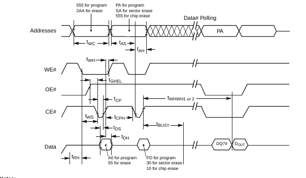

I am not sure I can do the same for EEPROM with /ROM_CE, reading specs now.
write operation
write operation

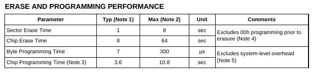

Also sector erase and program are lengthy operations, where the chip status has to polled until operation complete.
timings
timings

You won't be able to 'flash it' without some additional logic or timing within a program. But if preprogrammed, it can work the same way as an eprom/rom chip, so WE would just be wired to 5v for that.

Instead of status polling, I thought we could wait in a delay loop, and verify the whole sector afterwards, reprogramming failing bytes, if any. Not sure if good idea.
