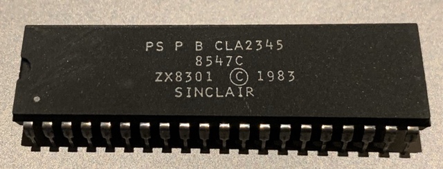

Nasta wrote:Interesting, I've seen several versions of the 8301, but none had that. Does the NTSC flag work on both MODE4 and MODE8? It would have to limit the number of display lines so in 60Hz there would be a lot of vertical overscan.
Can you check some more so I'll add it to the 8301 documentation thread? Can you tell me what the markings on your 8301 are?
I didn't check all my ZX8301 (got 10 or so), but the 6 or so I did check all have date codes from 1985:

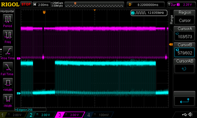

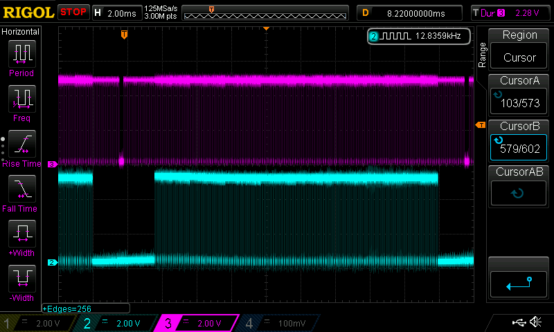

The line timings don't change at all, it just displays less lines to meet the 60Hz. PAL mode (pink is CSYNC, blue is BLUE with a completely white picture):

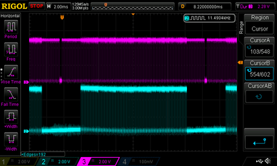

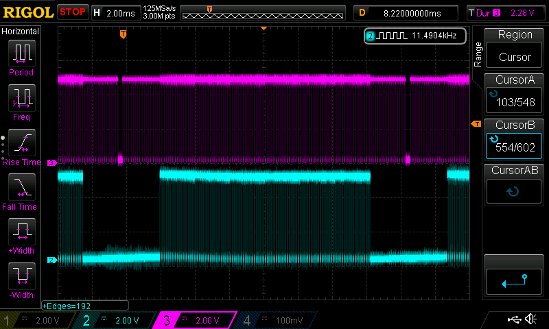

Same view with NTSC. Apparently there are now about 192 white lines (the counter is a btit jumpy between 190 and 192):

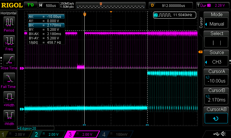

The vsync front porch is apparently 32 lines:

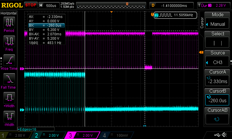

The back porch curiously seem to be 34 lines
All a bit weird but that's what my scope says at least. Mode 4 and mode 8 seem to be identical timing wise.
On my D15 QLs, the POKE has no effect. But your 8301 is a CLA2345, this is different from mine (CLA2310, date code 8453).
(I have two issue 5 QLs and two issue 6, all are plain UK models but some have a 220V power supply rather than 240V).
Jan

janbredenbeek wrote:On my D15 QLs, the POKE has no effect. But your 8301 is a CLA2345, this is different from mine (CLA2310, date code 8453).
Interesting. I only have German QLs, which automatically seems to imply that I only have issue 6 QLs. I've shot a few ULAs during my experiments, but the replacement chips were all CLA2345, too. Do your issue 6 QLs also have the 2310?
Cheers, Marcel
Yes, these are Issue 6 QLs with (originally) JS ROMs.
But AFAIK the German QLs were made by Samsung (SG-xxxxxx serial numbers with Issue 7 boards)?
There's a lot of info on build standards on Urs König's page here: http://www.sinclairql.net/build_standards.html
