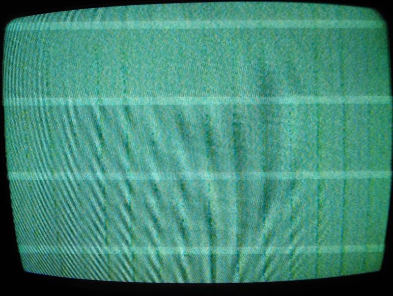

Post a pic of the screen display, maybe someone will recognise the nature of the problem.

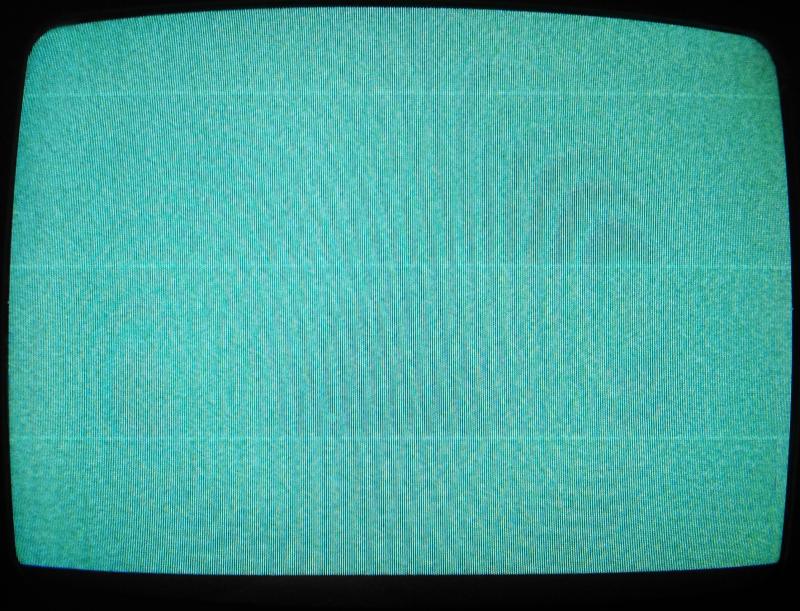

Re: Hi From London England
Post by Ruptor »
There is a half inch black band at the bottom of the pictures so the bottom should be straight seen better in the Bootup one but the camera angle makes it look curved. It is not so easy to take a picture and hold the button at the same time. The scan lines can be ignored because they varied with the position of the phone camera perhaps due to both the screen and camera having scans I think. :? I guess the RF and video is working but getting crap from the memory meaning there is either crap in the memory or what reads it is reading crap. Having said that it is probably unlikely the memory would all be the same at green if it was filled with zeros or random data so it points to what ever reads the video memory getting the same value regardless of what the memory contains. What does the reset hold say? It has changed the columns of dots and yet they resume the same pale green state when it is released. :? :? :? What happens on a working QL screen when the button is held because that might give a pointer.

Ruptor
Posts: 420
Location: London
Post by Ruptor »
