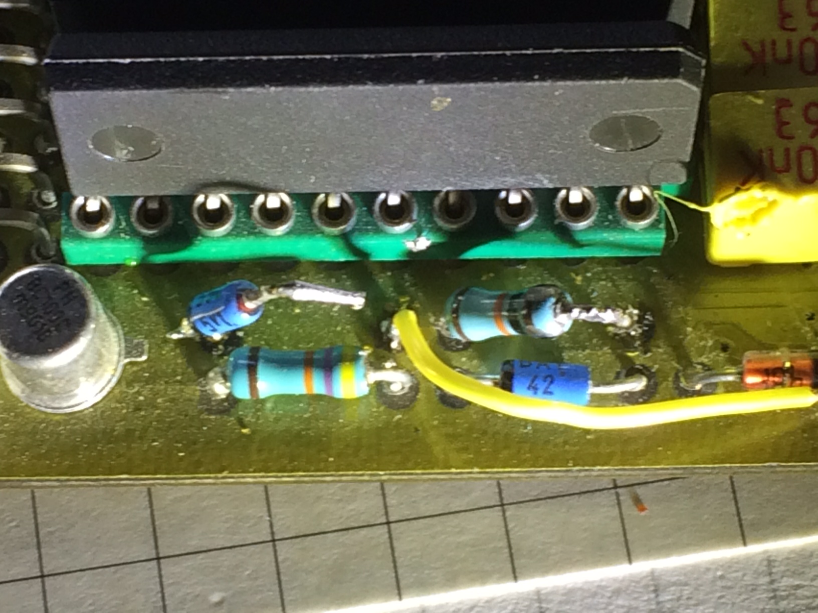

Thank you Klaus! Can you advise me on which particular resistor and diode needs to be used when returning the card to normal 9v operation please?
Kind Regards
Neil

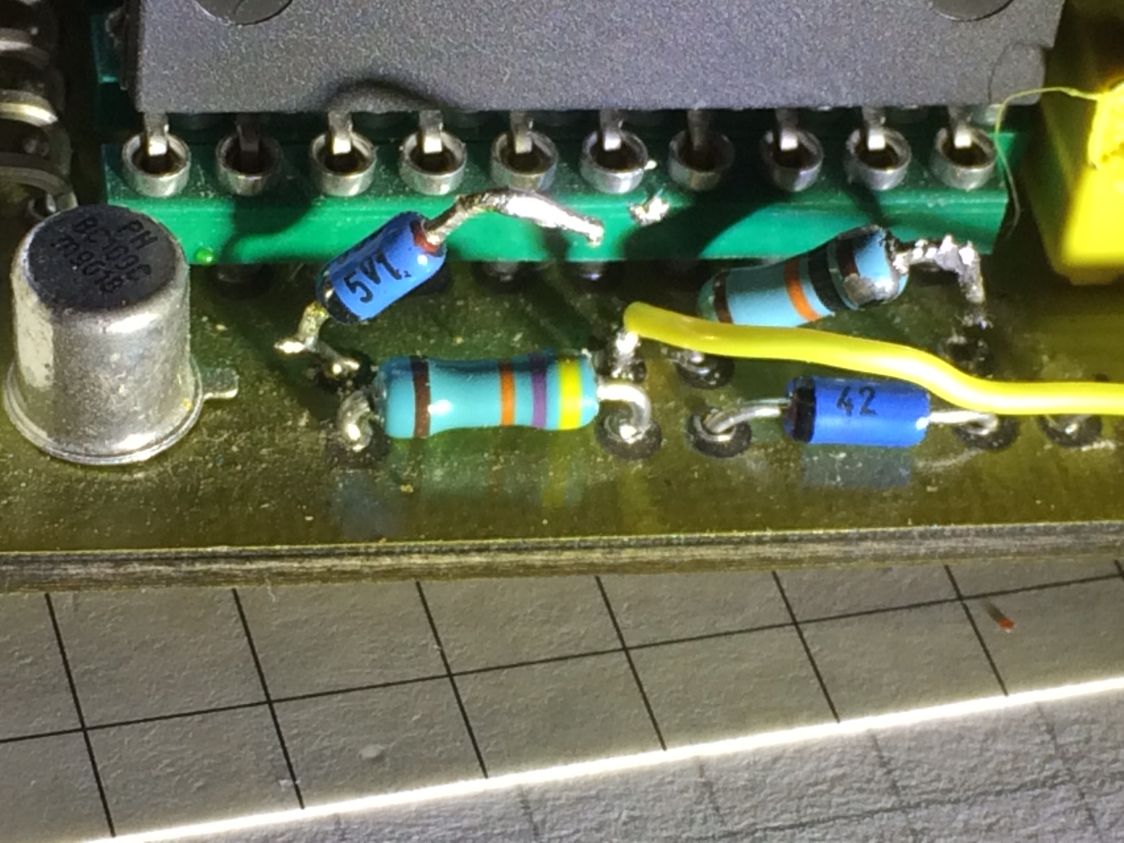

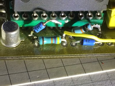

The values of the diode and resistor.
The diode is a zenerdiode -BZX 55C 5.1v
The resistor is a 10 Kohm 5%
Klaus

Hi Klaus
Excellent!!! Thank you very much! Out of curiosity, the diode only looks soldered to the board on the left-hand side, with the right side sticking up in the air?
Kind Regards
Neil

Post by klausfrank »
The reason, why the diode and the resistor are soldered only at one end,is that they disconnected, and I don’t loose them. Just in case.....

klausfrank wrote:The reason, why the diode and the resistor are soldered only at one end,is that they disconnected, and I don’t loose them. Just in case.....
Ahh, I understand - the photo you sent me is of a modified board! That makes sense!
Also, are the values for the diode and resistor going to be the same for a Gold Card V2 or V3 (with red PCB) ?
Thanks
Neil
