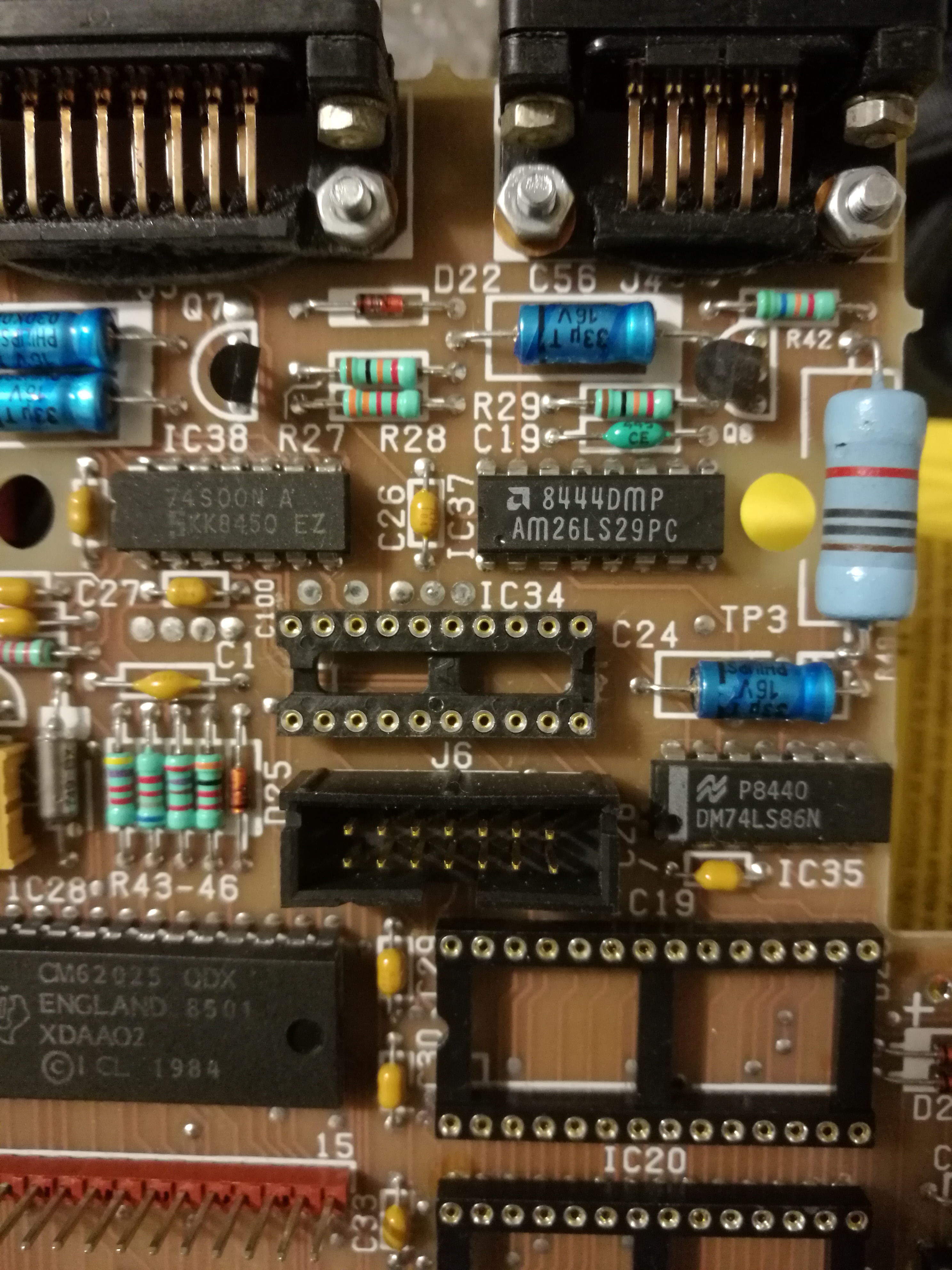

Re: ICL OPD (Merlin Tonto)
TP3 will be a test pad on the PCB - I can get you a close up picture when I get home tonight, showing where that needs to be connected. I plan to make that same modification too. The -5v is required for the RS422 circuit - I can't see it used anywhere else on the board, unless of course it's also providing the negative bias on the ZX8302 ULA - see the current thread in the hardware section.
Here's a close up of the main PCB back section, where the chip swap and TP3 are:
Oh yes, fairly obvious then. Thanks very much for that. What I don't yet get, is after that is done, where is the signal connection for the composite vid?
This doesn't give you composite video, just composite sync.
You could use something like an AD724 to take the R, G and B signals and composite sync and produce composite video and or S-video. I suspect some resistor dividers may be necesary
