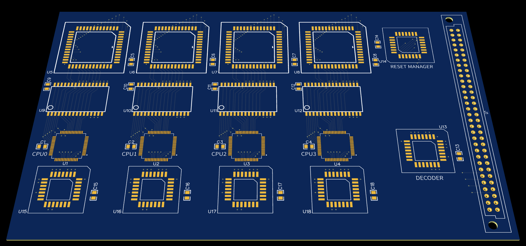

All the repeated components/tracks are done. Just need the control logic now - two GALs and a latch) plus some small odds and ends.

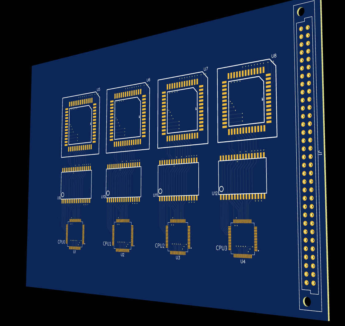

Can you supply a 3D representation of a populated board?
Would this new board be standard alone or plug into anothe QL, maybe iss8?
Posts: 2816
Re: Symmetric multiprocessing...
Pr0f wrote:that's a very sparsely populated board ! :-)
No glue logic, no caps, no buffers, no nothing yet!
Derek Stewart wrote:Can you supply a 3D representation of a populated board?
No "populated" representation. I don't use KiCad or any of the fancy packages.
The board would plug into any QL.
I repeat, this is VERY speculative.

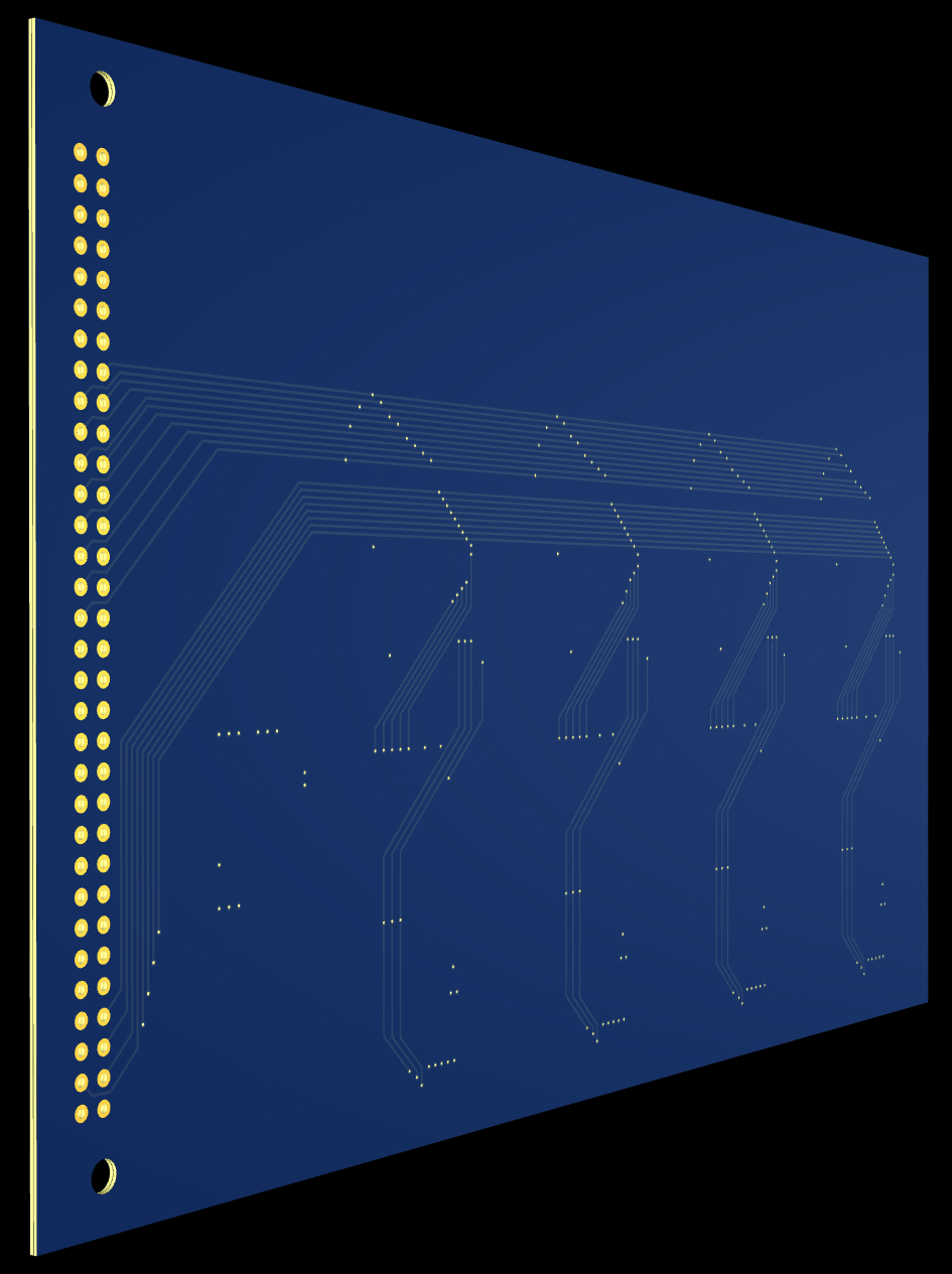

Now I have the core blocks done I can move them around the PCB and decide where the logic and voltage regulator will go.

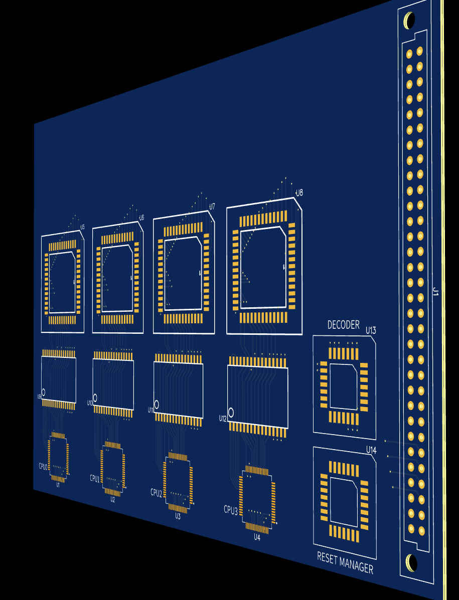

Adding in the logic. My approach on this is very ad hoc and not at all considered. I'll clean it up later. It's just a hobbyist prototype.
Top GAL is the decoder, which creates the selects for the four DP SRAMs. Bottom GAL is the Reset Manager, which uses four flipflops to set the state of /RESET for each CPU. I don't think I can simplify it any more than that.
The top GAL decodes down to four 2K blocks, creating CPU0..3 which are the /OEL enables for the four DPRAMs from the QL's side. The datasheet is a little weird, and describes /CEL and /OEL a little differently to normal SRAM. It implies /OEL allows reads or writes and !/OEL inhibits reads and writes, but another place it seems to suggest that /OEL affects reads only. Which would be weird. It also has a CARRY pin, for A11..19 being correct, which goes to...
The bottom GAL decodes down to the byte level, and maintains four outputs for /RESET. It takes CARRY and A0..10. It can then decode to the individual byte level, and toggle internal flipflops.
Yes, I know I need to put some address lines from the RM to the decoder, so I have the pins for the reset lines. I also need to have a GAL handle address decoding for each of the CPUs - though that will be very simple and take four more GALs, each identically programmed.
Also, the 68K vector area and etc. are so small, it might be unnecessary to remap the DPRAMs, IF they do not conflict with a ROM image. I haven't tackled that part of the design yet.
Pr0f wrote:you can use the FC0-FC2 to signal a fetch of restart vector - as it's different to other vector fetches - and could remap the dual port ram when a reset is done on the off board processor, but otherwise leaving it alone.
If you'd like to expand on that I'd be interested to read it.
