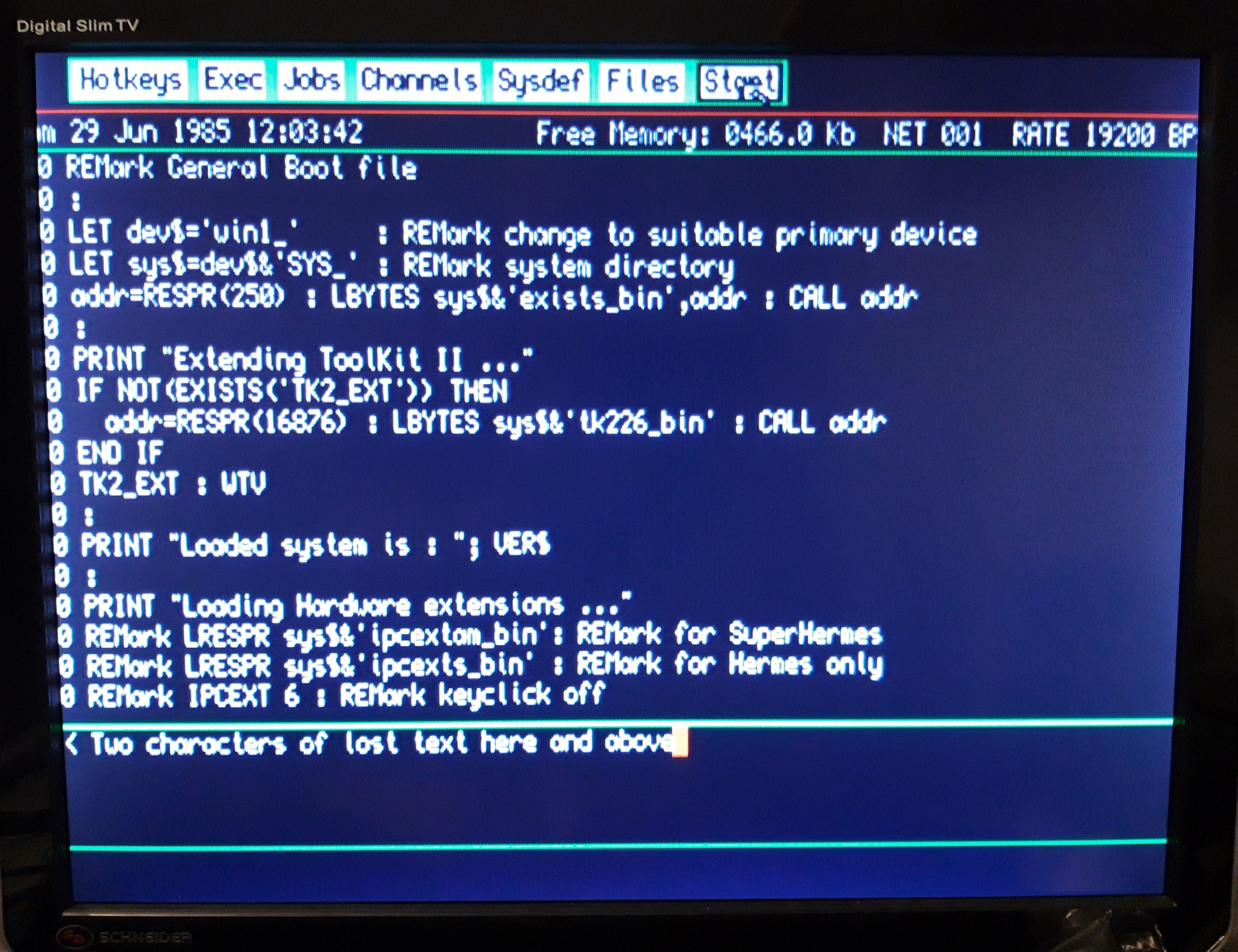

Sorry to dig this up again. After a break trying to do anything about it...
This is what I mean. I've moved the top menu options over but am too thick to work out how to move the main display window a couple of characters to the right (channel#1 isn't it, currently showing the standard Tetroid boot file?) and also the text input area at the bottom. I start the QL in TV mode.
If I do WTV that helps with the text input pane (and removes the green dividing stripe) but does nothing about the main display channel. I note that the date/time display is also too far to the left. That is clock_exe I believe.

Re: Hello and my QL experience so far
Why not define the channels #0, #1, #2, with the WINDOW command.
When the QL starts up in monitor mode or Tooklit 2 WMON command is entered the default channel definition are:
WINDOW #0,512,50,0,206
WINDOW #1,256,202,256,0
WINDOW #2,256,202,0,0
Just insert these three commands and adjust the values to suit the required window sizes for each channel.
See the QL Manual for more information on Window command.
The WINDOW command in the Online SuperBASIC Manual is at https://superbasic-manual.readthedocs.i ... indow.html if you are interested.

- Posts: 1400
Yes, I also have the original manual and have played with that in the past. I've finally got it right now and put it in the right place in the boot file, thanks.
