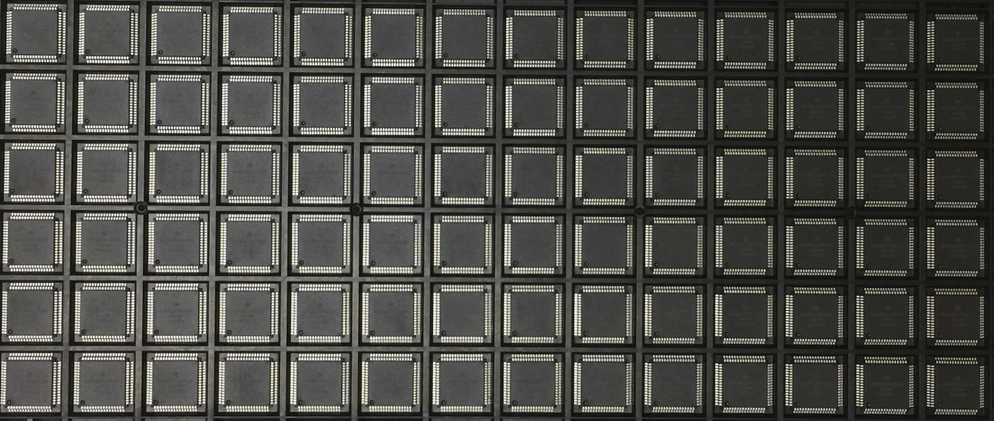

100x 68SEC000
100x 68SEC000
It's not like I have a lot of CPUs or anything.
