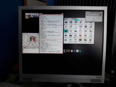

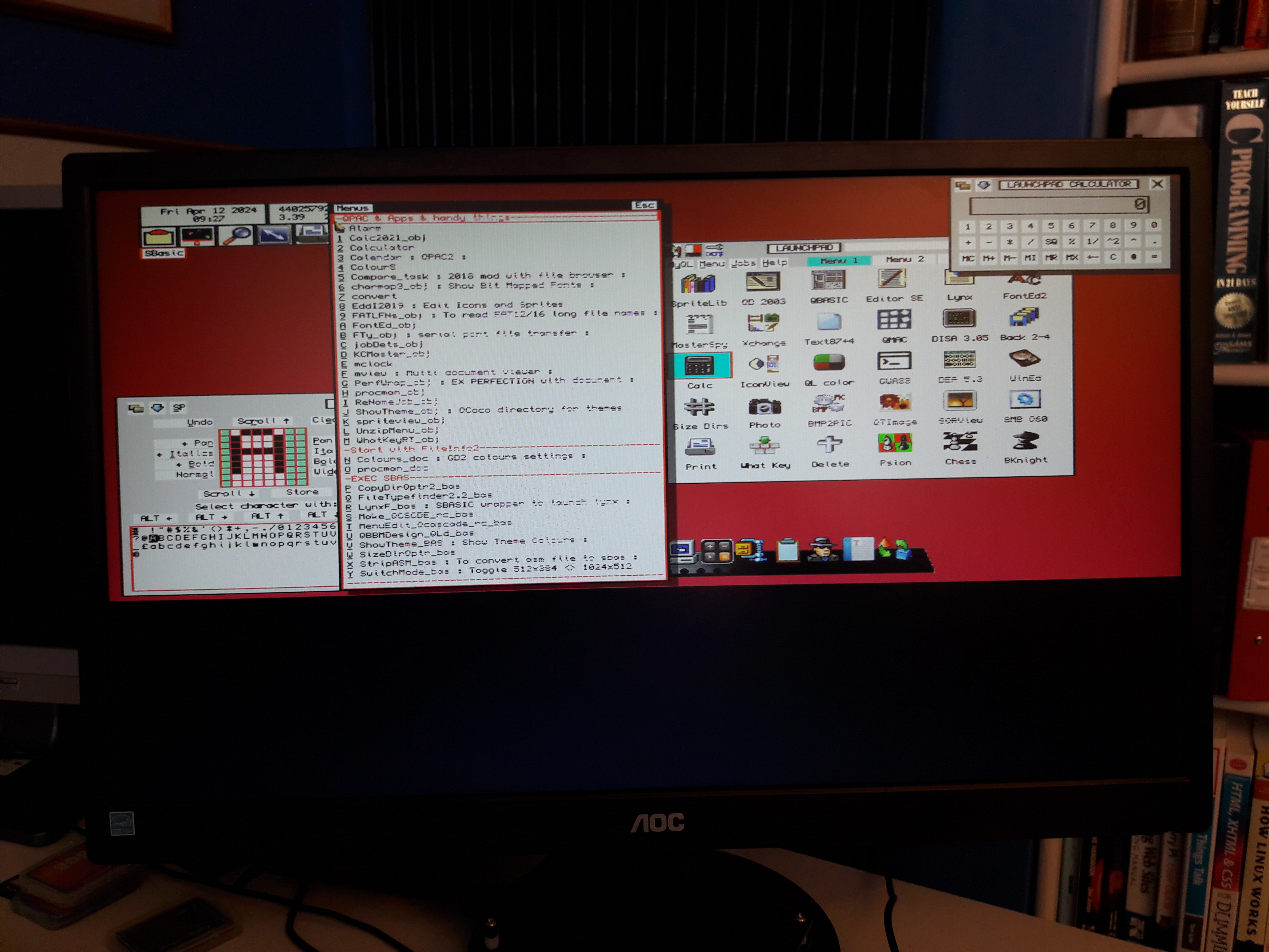

Peter wrote; Not sure I would be satisfied with the OSSC.
This is my Q60 with your updated VGA chip same monitor :
Of the two I prefer the OSSC.

Artificer wrote: Fri Apr 12, 2024 9:42 am This is my Q60 with your updated VGA chip same monitor :
Of course - the modified Q60 video chip is not suitable for widescreens at all.
It is for monitors with native 1024x768 resolution or at least 4:3 aspect ratio.
With a 1024x768 monitor, you get an absolutely crystal clear picture. With a black bar :(
Here is the updated video chip with an older monitor with 4:3 aspect ratio. Again I still prefer the OSSC output. A lot of what you get with either solution is down to the quality of the monitor. If you are fortunate enough to have an old flat screen monitor with a 1024x768 resolution and 4:3 aspect ratio you are OK, if not then at the moment it seems the choices are use an OSSC, ditch the Q60/40 and go to emulation or to the Q68 which is nice but very slow at higher resolutions, or back to the black box.
