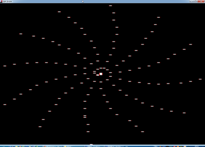

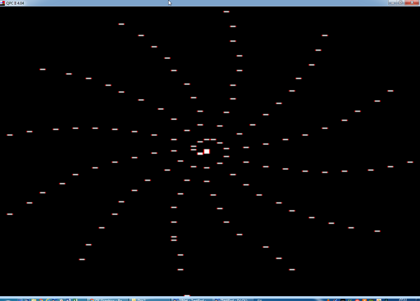

Whilst Per has moved on to to fry bigger fish :-)
I thought I'd close the Mode4/Mode8 'sample-point' conversation...
Should anyone find it of any value, the address offsets (integer) for a set of 127x test-points forming a spiral, based on the 32k QL display can be found attached as a .txt file and saved as spiral_offsets.zip
The pattern itself looks like:
spiral_offsets.zip
TXT file of integer offsets within a 32k QL screen forming a spiral
(517 Bytes) Downloaded 173 times
