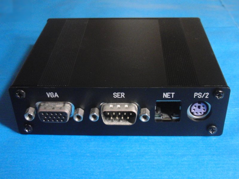

I've just seen this on Facebook and wondered if you had a ballpark price that's being aimed for? Had a Spectrum and Amiga so sort of missed out on the QL the first time around.
Re: Q68 Advance Notice
Basically yes, and on the same chip a graphics unit with QL and Q60 modes, an SDRAM controller, QL system core, PS/2 controller, serial port, sampled sound device, two SDHC card controllers, some Flash ROM, a little fast SRAM and the drivers for an extension bus.dilwyn wrote:It's not a 68000 chip in there, but it's not an emulation either. It's to all intents and purposes a 68000 in a different chip, a compatible chip in essence. A chip which has been programmed to do exactly the same thing as a 68000.
By this relatively high level of integration, the Q68 needed separate chips only for SDRAM, power supply, ethernet, the RS-232 driver and the buffered realtime clock.

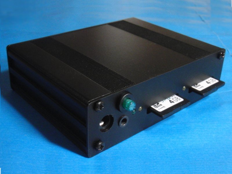

Very nice indeed.
Reading the earlier spec, it appears that the PS/2 port is multiplexed between KB and Mouse.
Will the Q68 therefore use one of those KB/Mouse PS/2 splitter/Y-cable adapter that was popular on Toshiba & IBM laptops, way-back when?
What about the speeds of the Serial and I2C interfaces?
