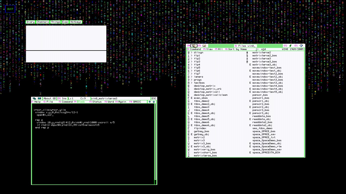

I managed to compile pjw's last posted Matrix!!! code on my system as follows:-
x=scr_xlim:y=scr_ylim
window x,y,0,0:cls:g%=x/12-1
open #1,scr_
rep p
window 10,y,rnd(g%)*12,0:ink#1,rnd(1000):scroll s/5
if rnd(1):bput#1;rnd(31,99):s=5:else:s=15
end rep p
I still don't fully understand the program but was able to add random colours to the raining text to see what it would look like. To slow the rain I divided s by 5.
I tested SELECT ON an array and found that SELECT ON is fine with a variable but not a variable within an array. (it is rejected by my parser)
The Matrix!!! code will not run whilst it is overlapped by another window. I guess this is because you can't resize a window whilst it is covered by another application's window.
As a background, the fact that Matrix!!! stops raining when covered by applications is actually rather useful. One can freeze the display at an appropriate point.

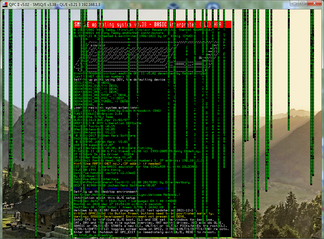

Here's the SBASIC code what I call MiniMatrYX (85 bytes):
REP:SPL WIN1_,"SCR_6x"&RND(SCR_YLIM/2TO SCR_YLIM)&"a"&(RND(0TO(SCR_XLIM-6)/2)*2)&"x0"
Here's the rather spartanic but even shorter 68 bytes version called MiniMatriX:
REP:SPL WIN1_,"SCR_6x"&SCR_YLIM&"a"&(RND(0TO(SCR_XLIM-6)/2)*2)&"x0"
MiniMatrYX under QLE v3.21 (wip) on QPC2 v5.02
:ugeek: Just call me Neo.

pjw posted
"Since you appear to be interested to get to grips with SBASIC......."
Yes, I really am interested. I have no idea why, but I enjoy programming for fun on/in SMS. There is something about SMS that is completely absent on various other hobby or learner systems. I find that writing a program in my SBASIC, as in SmsBASIC, setup is a kind of artistic endeavour.
For this activity to become more fluid I need to better understand how the whole thing works.
Your reply was very informative but will take me some time to digest. I have played with your program to produce varied and very attractive results. I am amazed by how much can be achieved with so little code. Inspired by your program, I am going to try and write a MATRIX!!! program that runs in the background and looks more like the ones found on YouTube.
Sadly I am not an accomplished,or not even an unaccomplished author but I intend (therefor it might never happen) to write an SBASIC programming manual for people who think like me. For example, I have been following the PE for dummies thread but have very little understanding of the topic being discussed. So you see I am even dumber than a dummy. I suppose I could try harder but I am not very keen on using EasyPtr.
There are a number of limitations that become apparent when writing animation programs. These are probably a reflection of the very low power of the machines on which SMS was developed.
The first, concerning the pjw MATRIX!!! program, is that the WINDOW #n,x,y,xp,yp instruction does not seem to work in the background.
The second is that if you let a program write to the screen "flat out" and "on top" the performance of the system is affected, such that no other program is useable. If the animation window is even partially covered by another window, system performance is restored. Why is this?
The problem I have with animation is that the only real control I have on animation speed is the WAIT instruction which has a minimum delay of 20 msecs. This is far too long. I can delay animation by wasting time doing a calculation but this is affects the system's performance.
Is there no way of creating a DELAY instruction to control programs in micro seconds? Lots of NO OPERATIONs (what ever they are) perhaps. Is there not a clock that controls the processor that could be used somehow?
The third, fourth and fifth limitations are really all the same and can probably only be solved in hardware.
Animation stops if you move the pointer over the animation.
Animation stops if you move or resize a window.
Most problematic is that even programs that are not writing to screen appear to stop when moving or resizing.
