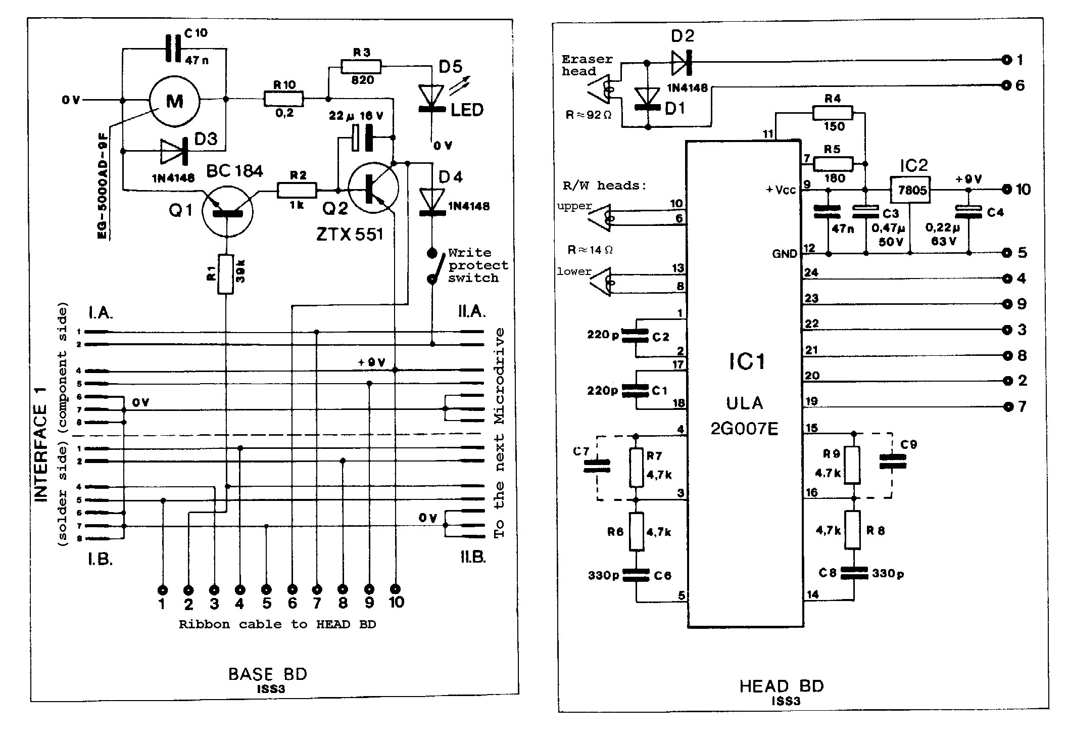

Swapping wires 3 and 2 on the ribbon cable between the two boards should allow you to reverse the order of connection and use them ascending to the right. Solder side pin 4 is the pin that carries the location information, which is amended by the ULA. All the other pins pass through.
Check out this schematic :)

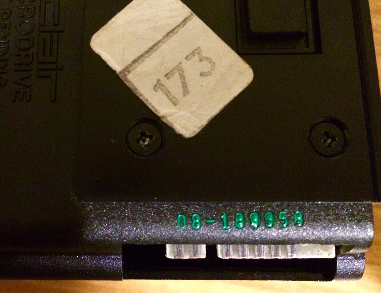

Checked my ZX drives and found a slightly later one (if they were numbered sequentially):
ZX MD Serial
ZX MD Serial
Doesn't format or save unfortunately. Resistor values are r4=150/r5=180 as expected.

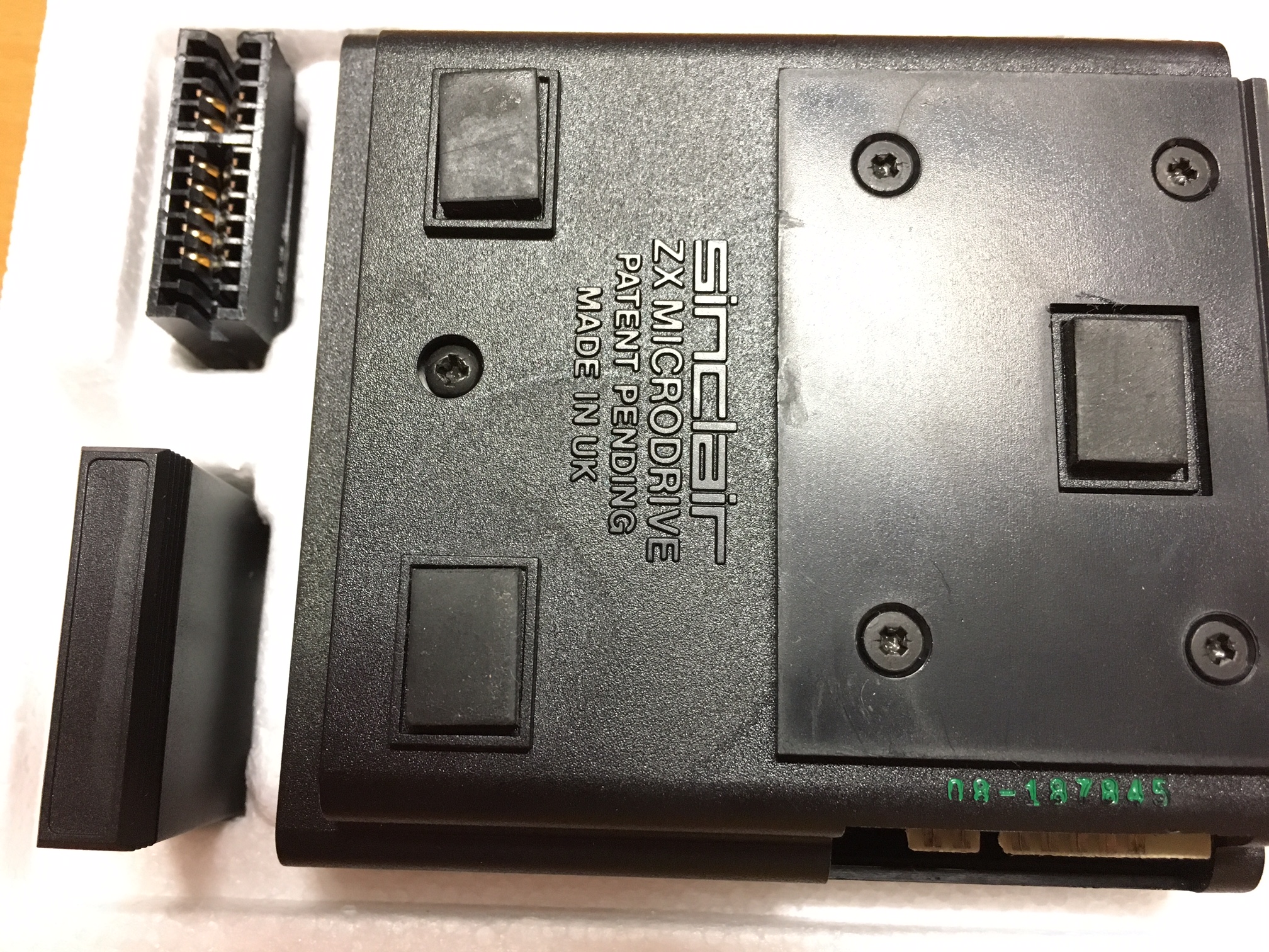

I have 3 External ZX Microdrives, which came from a ZX Spectrums I purchased as a job lot.
" ZX MIcrodrives are joined with the plastic plate and expansion connector, each drive has a Serial Number of:
04-082935
04-081725
And a Single ZX Microdrive with a serial number of:
T-I12961
Does anyone know if the serial number has a bearing on QL compatibility.
I was going to remove the microdrive and install a QL-SD card, placing the unit on the top QL over the internal microdrives.

Dave wrote:On further research, I found this which should nicely solve your problem: http://www.ebay.com/itm/Sinclair-ZX-Spe ... SwO~hXIJMl
What tolerance are the resistors? If they were 10% tolerance ones which Ive found in a few 80s devices thats actually quite a wide range of values.
Even 5% is pretty wide!

While the PCBs are very different between the Speccy and QL the schematics are functionally identical. Unless the Speccy and QL devices use different ULAs, the resister values and possibly head resistances might be the only differences.
