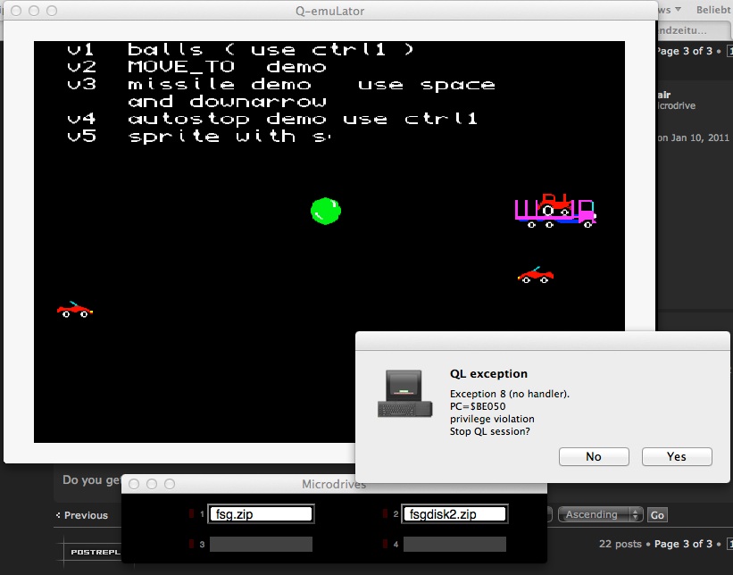

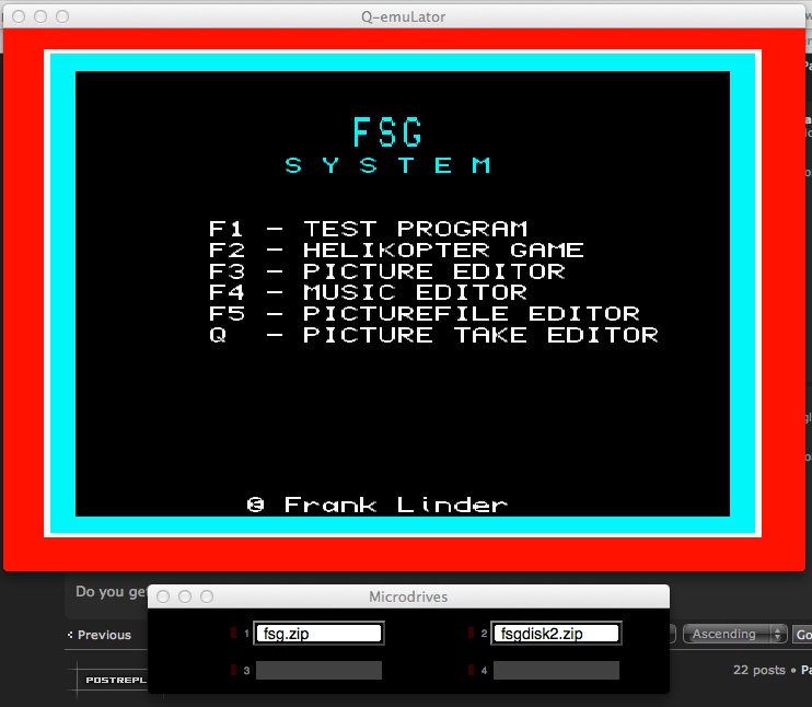

I've attached 2 screenshots, first the starting screen, second the Q-emulator error.

All I can add to the exception error is that I have experienced the same on my iMAC aswell, I have tried different speeds as well on other Sprite programs with varying degrees of success. It is very frustrating as many interesting programs could be written if sprite control was available for the new QL systems with more colours. The starting point would be to get a Sprite program working well on the emulators.

68000 has a user-mode and a supervisor-mode. There are som instructions that is only allowed in supervisor-mode. If I remember correctly I used Trap 0 to get into supervisor-mode.
Every trap is executed in supervisor-mode and I call some of then.
Since you get some sprites on screen it may be the sound call that gives the problem.
The code may call the sound trap just to make sure there is no sound.
Could it be the Q-emulator is not correctly emulating 68008 supervisor-mode-instructions ?
I know there is differences betwen 68xxx processors. In one processor an instruction is a supervisor-mode-instruction, in others it is not.
Is there a way to let the emulator to skip the message and just continue?
Dispite of your problem, it is very nice to see my spritegenerator in action.

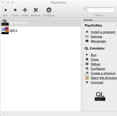

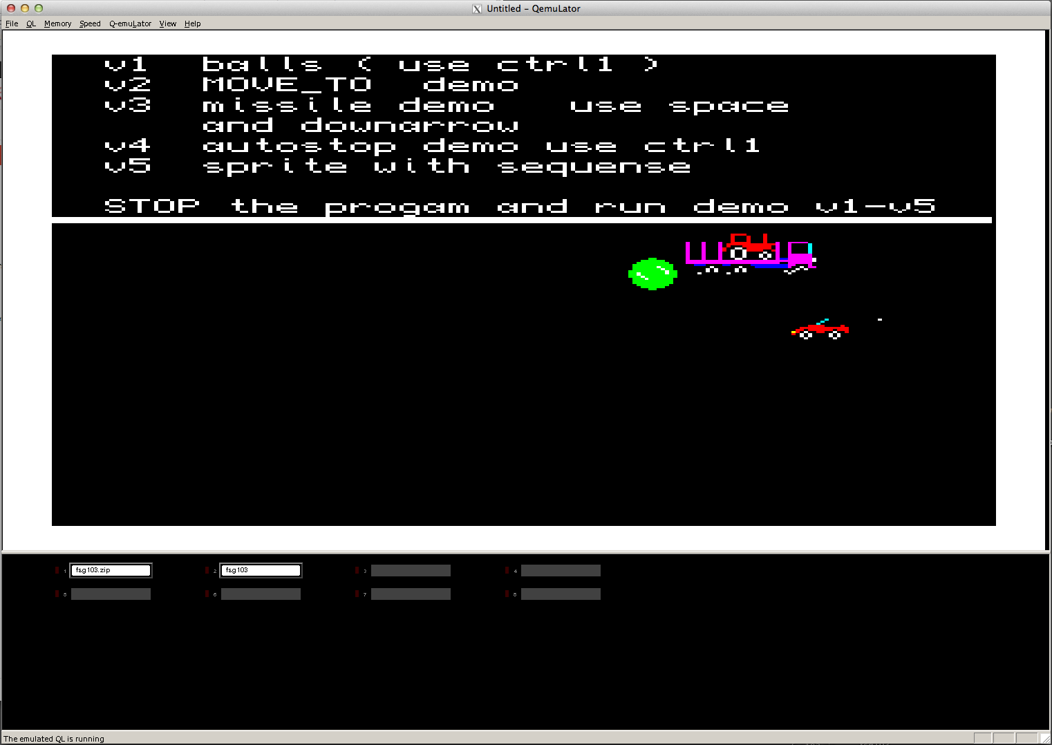

Hi people, being in the fortunate position of having purchased both the MAC and Windows versions of QemuLator I can flip between the two. Indeed the Windows version does work with FSG, and as stated before I get the same error when trying FSG on the MAC version.
That is not the whole story though, although a bit convoluted I also run a program on the MAC called Play on MAC, which with certain limitations allows some Windows based programs to run on the Intel based MAC OS 10 systems. Having not used it for awhile I updated it to the latest version running on Mountain Lion, it also installs another set of driver/OS called XQuartz (a replacement for X something, I wont bore you with details). Suffice to say I have successfully installed the Windows version of QemuLator on a MAC and although inferior graphics by comparison to the real MAC version it appears to run OK and is alongside the QPCII (also Windows program)
I then downloaded the ZIP file of FSG from Dilwyn's site and attached the ZIP as is, to QemuLator drive slot, booted the QL run the program, ran the DEMO and as you can see by the screen shot below, it works. The sound also works on the Helicopter game although I haven't completely played that yet. Hopefully this will give some clue to Daniele as to where to look in the MAC version of QemuLator at some revision in the future. For now it seems it is possible to use the software on the MAC albeit through some devious means if you have the Windows version.
