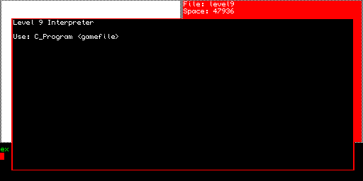

Just to report some progress with `level9' game engine.
It now compiles, shows some info on startup asking for a game file.
file size: 79810 bytes
data space: 47936 bytes
NOTE executable file size is fairly big compared to ATARI port, which is roughly 25K, and AMIGA 45K.
Specific QL code in `ql.c' needs implementing a few routines, currently set as dummies.
Will need a lot more work to do, we can start w/o compressed game bitmaps as Rich suggests, graphics is going to be the most difficult part.

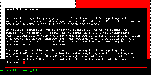

When `bitmaps.o' removed from the build, and adding `-O2' to CFLAGS, makes final executable smaller.
`level9' - file size 58416, data space 48400 bytes.
It seems doing things with `Knight Orc' data files for DOS,
taken from `Abandonware' pages as hinted by Derek.
Tomas

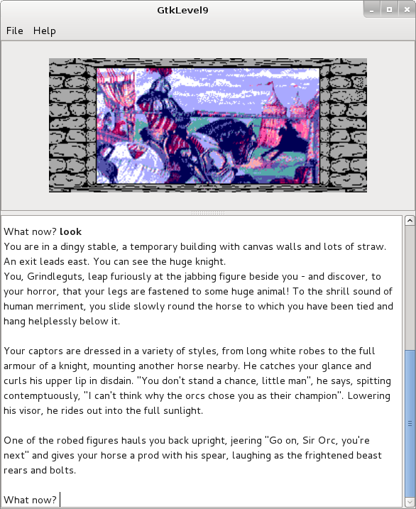

I have also build Gtk2+ version of `level9', can be possibly used to source graphics from the games. Seems to also support `magnetic' engine.
EDIT, Amiga or Atari game versions may have nicer graphics with more level of detail
