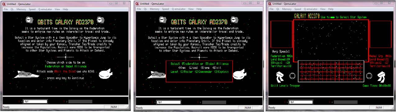

The weather not so good so I cracked on with the coding of Galaxy AD2370.
Happy to release my present version.
Probably best run on am emulator QL2K or SMSQmulator!
Enjoy!

Galaxy AD2370v3DS
The earlier release of Galaxy AD2370 was very much a work in progress. Now with further work carried out I can deliver a Game with improved layout and extended graphics, hopefully fulfilling most of my original ideas for the Game.
Changes include Hyperspace Jump, Orbital approach, Laser Weapon and improvements to the Simulation mode.
Eight data files with the Load and Save function and a (H)elp page.
Good and not so good the program runs with QL2k and SMSQ emulators. I have loaded the program into the Q-Emulator in basic QL mode with 128KB memory. The Intro screen is displayed and from the Game Menu the game screen loads (be it slow). However within a few moments the screen freezes I suspect because the program has run out of working memory. I would be interested to hear back from anyone who tries the prog with QL hardware and extended memory.

Re: QL Tinkering
nice game - unfortunately, it uses a variable name "SET", which is a keyword used by the ENV_bin system extension. If you have this extension loaded, this leads to a name clash.
Once I renamed this variable, all ran fine on QPC2.
Re: QL Tinkering
I tested your program on a genuine real QL, TrumpCard expanded and MGI rom.qbits wrote: I would be interested to hear back from anyone who tries the prog with QL hardware and extended memory.
(M) Game Menu
(F1) Quick Test of Game functions including a revised Game End with new graphics.
(F2) Simulation Mode
For some reason it refuses to detect the pressure of "M" key. So I REMarked the line (maybe 144?), so the program proceeded. The pressure of "F1" apparently produces no visible effect. Pressing "F2" a "simulation mode" sentence appears.
Anyway the program runs. Obviously it's really slow on a 7 MHz CPU, but it runs. Wonderful job!
I'm gonna try it with Minerva too
Re: QL Tinkering
Thanks vanpeebles and Tofro - Perhaps I should have seen that one coming ‘SET’, by the way what did you rename it as.
Next Code Update – ‘set’ changed to ‘slk’ (Save lock) Line 109 / 163 / 165 / 204 / 231
Thanks Cristian for you QL hardware review - You might try this if you haven’t already:-
Line 144 - Quick fix is to use PAUSE without a qualifier. That will allow reading of the Intro page!
For the Intro page ‘M’ uses KEYROW for the Game Menu it uses INKEY$ does it work from the Game Menu.
Line 404 – If F1 works usually – to check this function run prog and go to Game Screen then halt prog using Ctrl/Spacebar and type sn=50: GameTest:
This should run the Game End sequence. Default will be a Federation WIN. Selecting (R)ebels from Game menu will show the alternative Rebel alliance wining.
