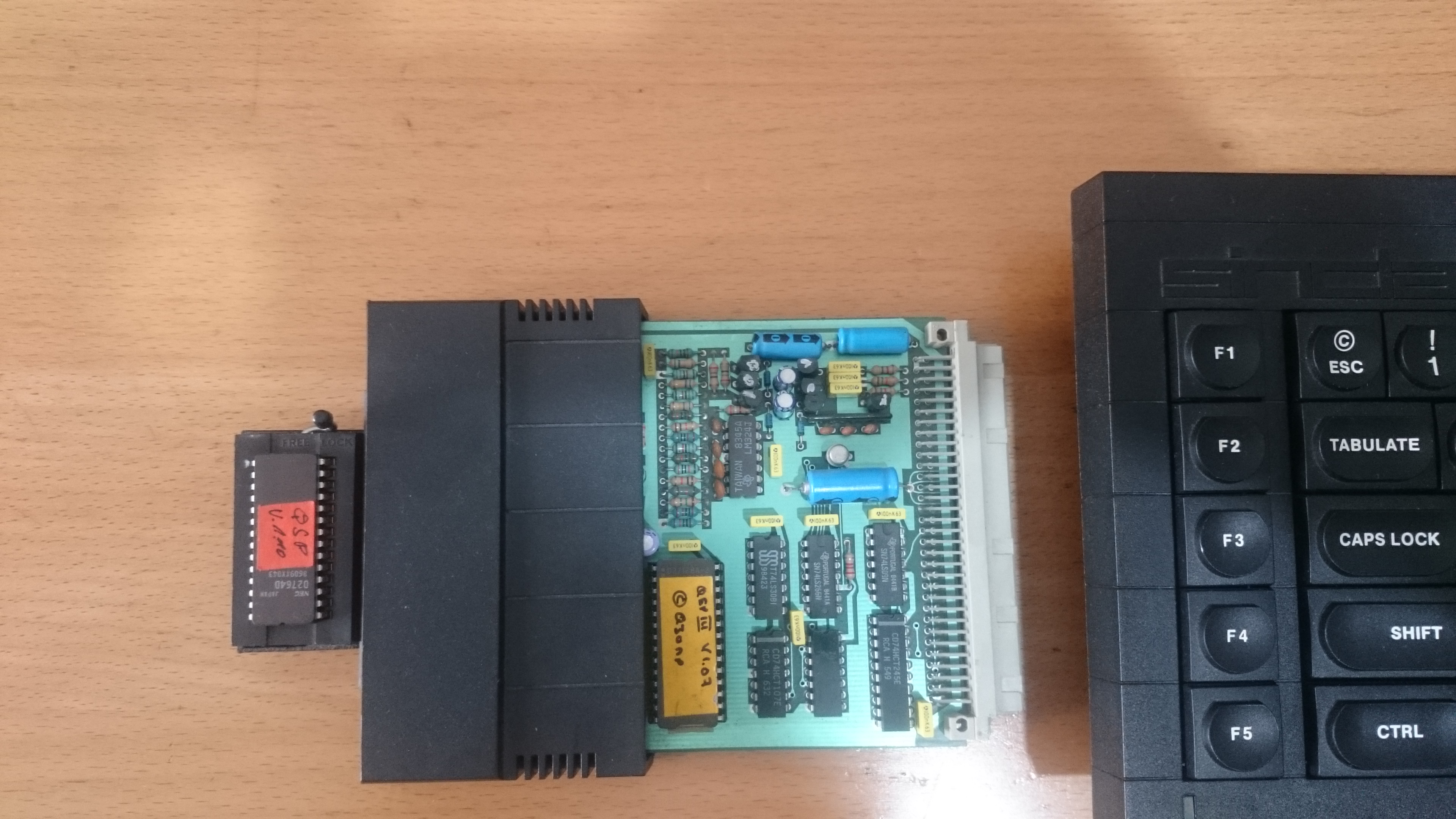

I will read the ROM content and also make proper diagrams of the both sides of the PCB. It will probably take me a few days.

The Qsound/Qprint Interface I have has had a lot of damage done by someone with a very hot soldering iron.
I am looking to get a professional PCB Track repair kit to correct all the damage.
The ROM looks to be damaged, are you able to save a copy of the Qsound ROM, this is best done by removing it from the board and reading the Eprom in a Eprom programmer

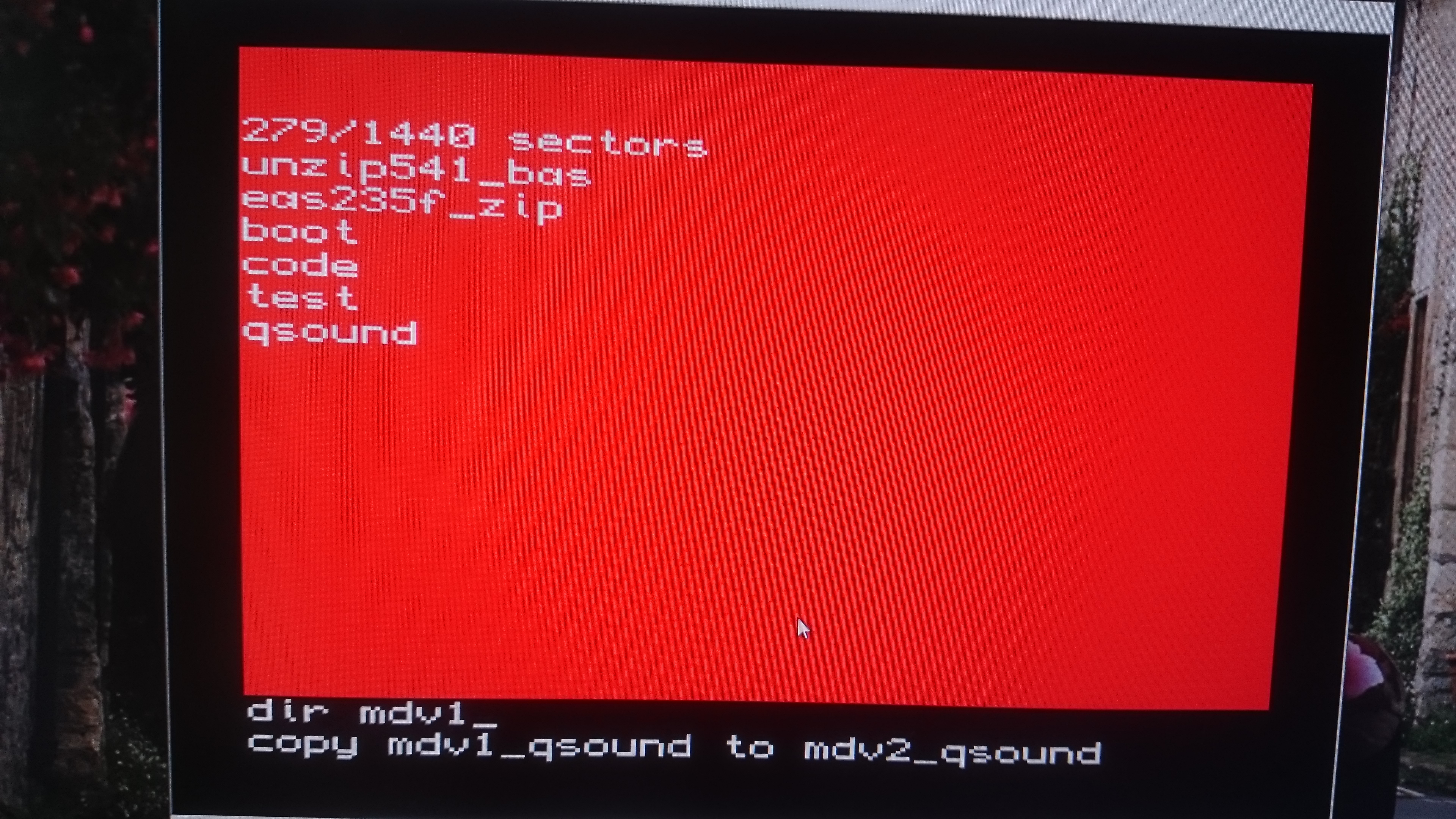

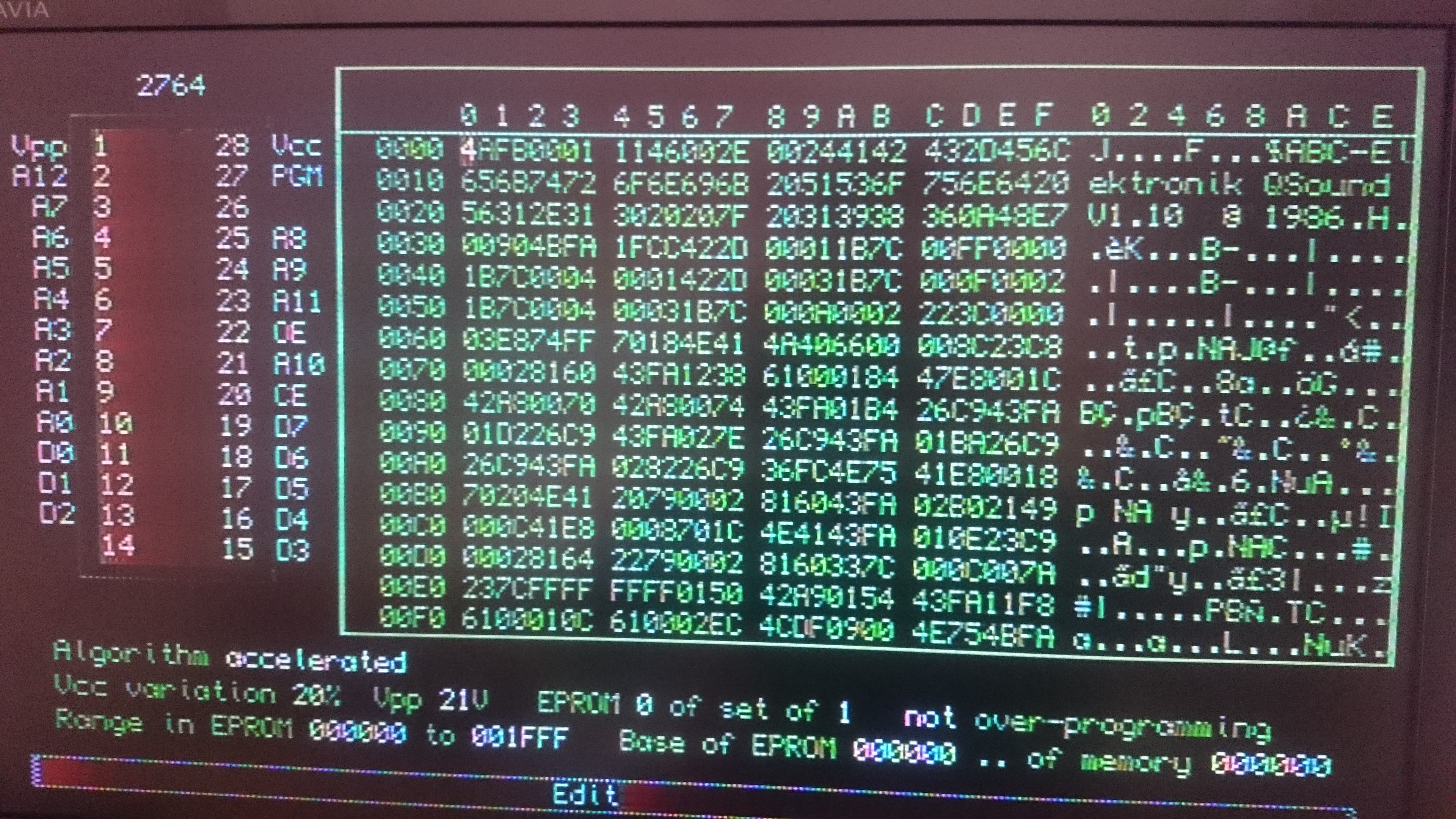

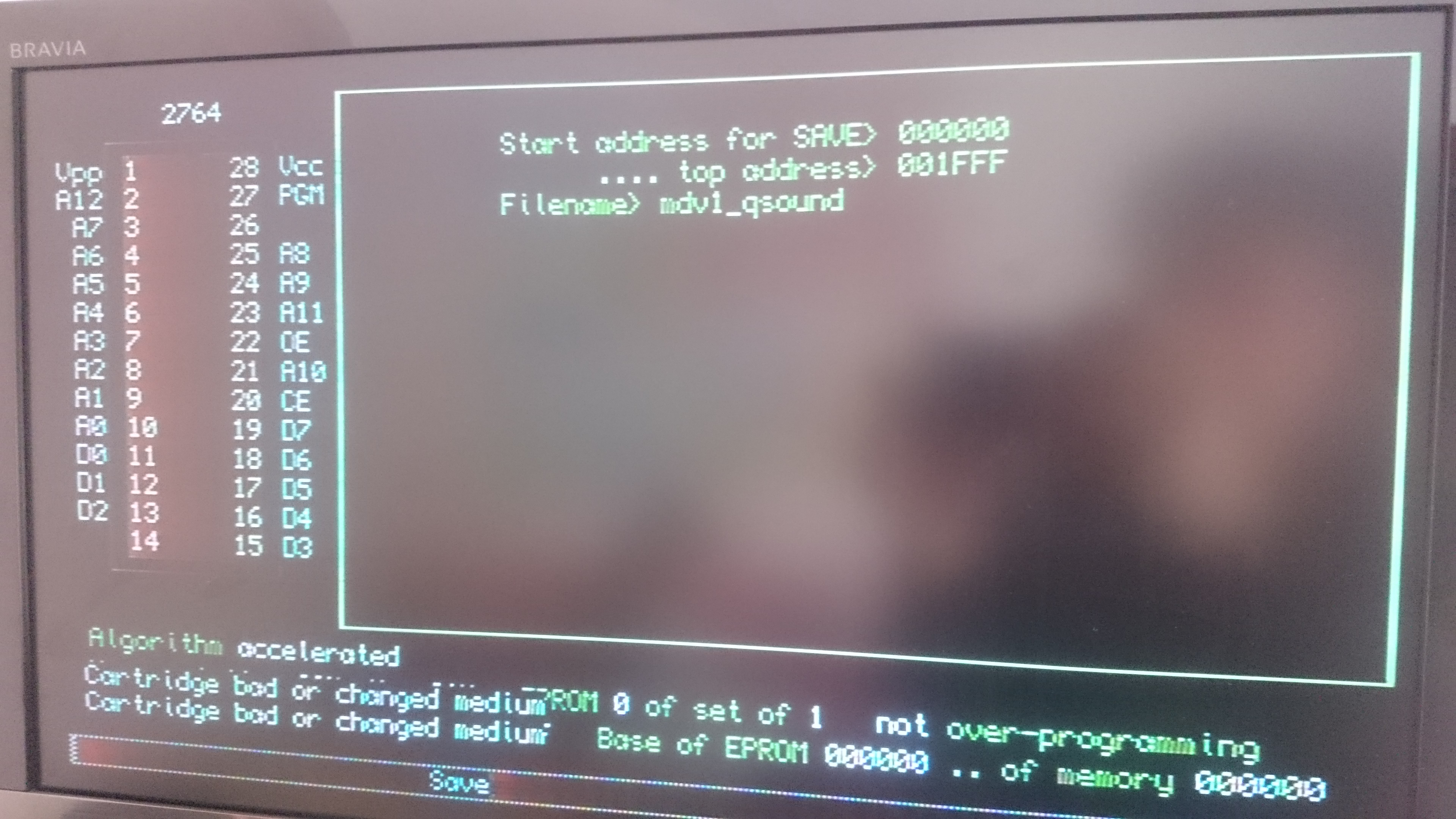

OK, I did it the old fashioned way... Took the EPROM out off the QSound board, inserted it to a QEPIII, downloaded the contents to a MDV cartridge (one that still works...), then switched off the QL, connected a Sandy Q-Board and floppy drive, copied the file from MDV to a floppy disk, then took the disk to my PC and use Q-Emulator to copy it to a folder... That was a lot of fun! I hope the file works... I also hope that I am not breaking any copyrights by doing this. (Had to zip the file to be able to upload it...)
