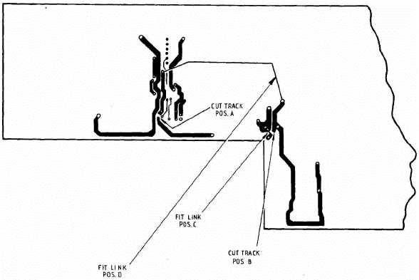

Here is the mod documented in QL Service Manual, I am curious what does it actually rectify in electronic sense. Is it to do with powering MD units, or rather to do with head frequencies used?

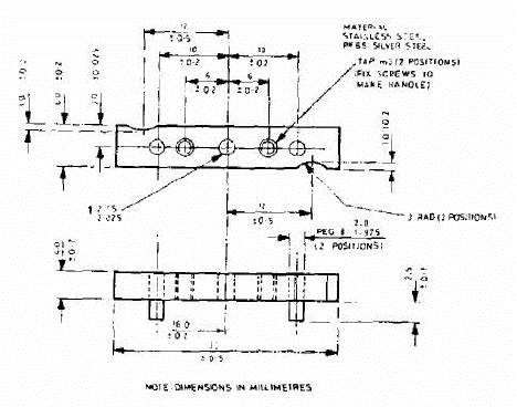

Hi Charles,
Thank you, I believe with my tools, I can set the loop time in between 7.0 - 7.25, as the precision of my measurement currentlty is <0.25 secs.
A small advantage is, I measure it with a real motor load on real cartridges.
I would also like to make a jig as per ink pen drawing, but I lack a better scan where all the dimensions would be clearly legible.
MD Motor Adjustment Jig
Last not least, I still miss the answer to the QL main board modification (a few posts earlier), how does that influence the loop speed, R/W performance, etc?
Tomas
I think this is an electrical noise reduction attempt rather than anything to do with actually controlling the Microdrives. But I would have to study the board layout, the tracks and the schematic to be sure.
