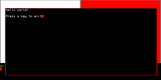

I tested qdos-gcc on hello world prog
on my Linux box I compile as follows
It reports the stack dataspace value, plus another value in parenthesis, that I do not know what means exactly
It produces a binary hello without an executable header, when transferred to the QL, and after creating the header.
It can execute in STD I/O window as follows
Tom
#include <stdio.h>
main (int argc, char *argv[])
printf ("%s\n\n", "hello world!");
$ qdos-gcc hello.c -o hello
hello: dataspace 882 (372)
Tom
