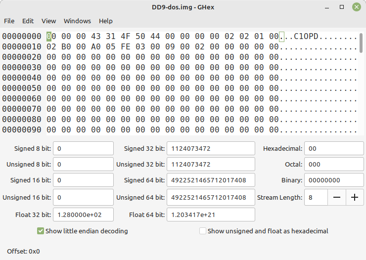

That's good to know that your image can be written ok. I assume dd would do a similar task? I'm not sure if Stephen updated his header program after he got the rom running? if he did not the header would need to be the same as the one in this pic. From what I understand from what Stephen was saying is that the OPD has it's own format (which is DOS compatible), but the OPD doesn't care/read the header information , however DOS of course does. Stephen also pointed out that because of this if he changed the header to a DOS one, then that is the best of both worlds as far as reading and writing is concerned. He also noted that the Header was just a plain string in ROM which writes to each disk, thus altering this is what is going on with the modified ROM.

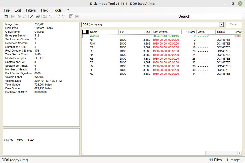

This is just showing what the settings are (hopefully). I copied as many settings as I could from the manual.
