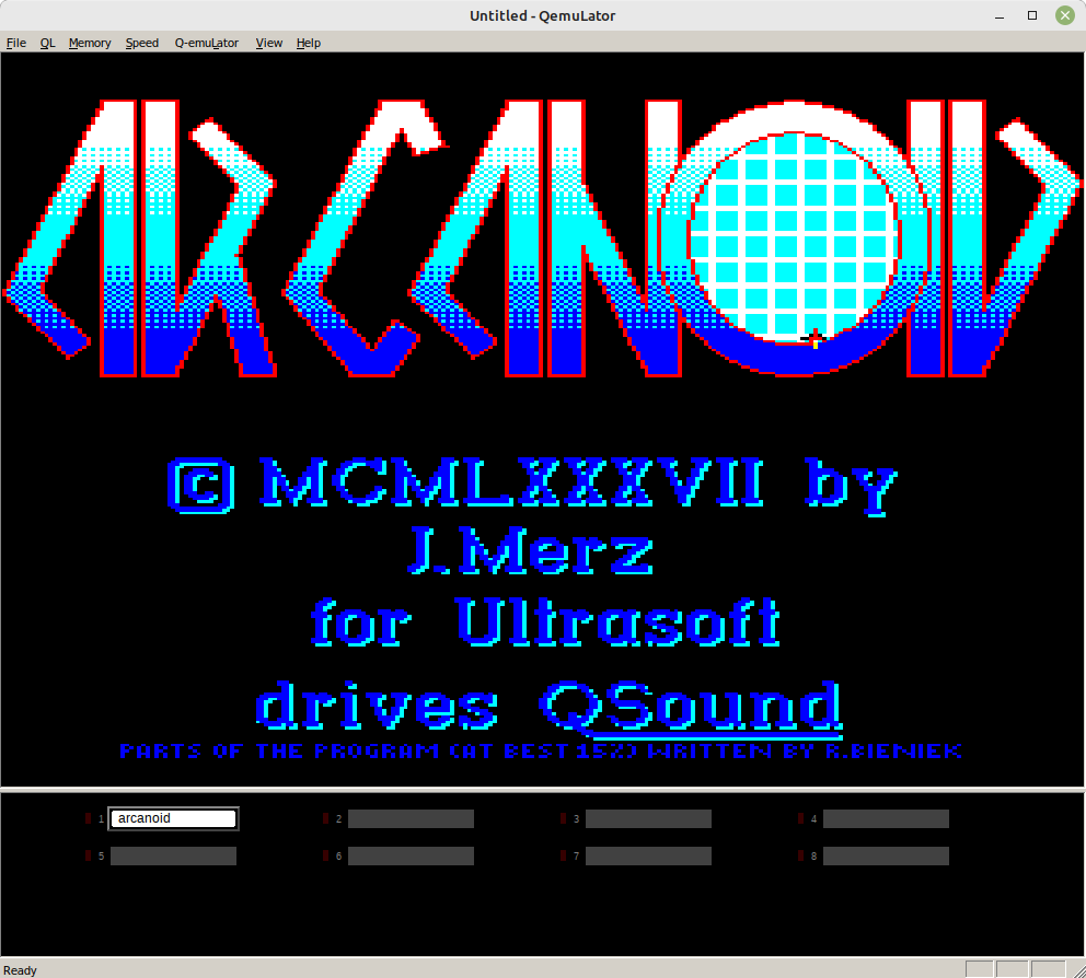

What arkanoid? I was thinking that there are no software for this interface... it's available for donwload? I want to try it. it's for a standar QL?
jobdone
Posts: 117
Re: QSound and QPrint Interface
Post by jobdone »
See screenshot. It's available from RWAP still.

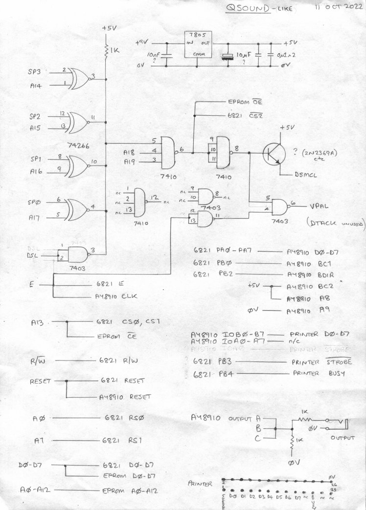

Did you use this schematics for your rebuild?

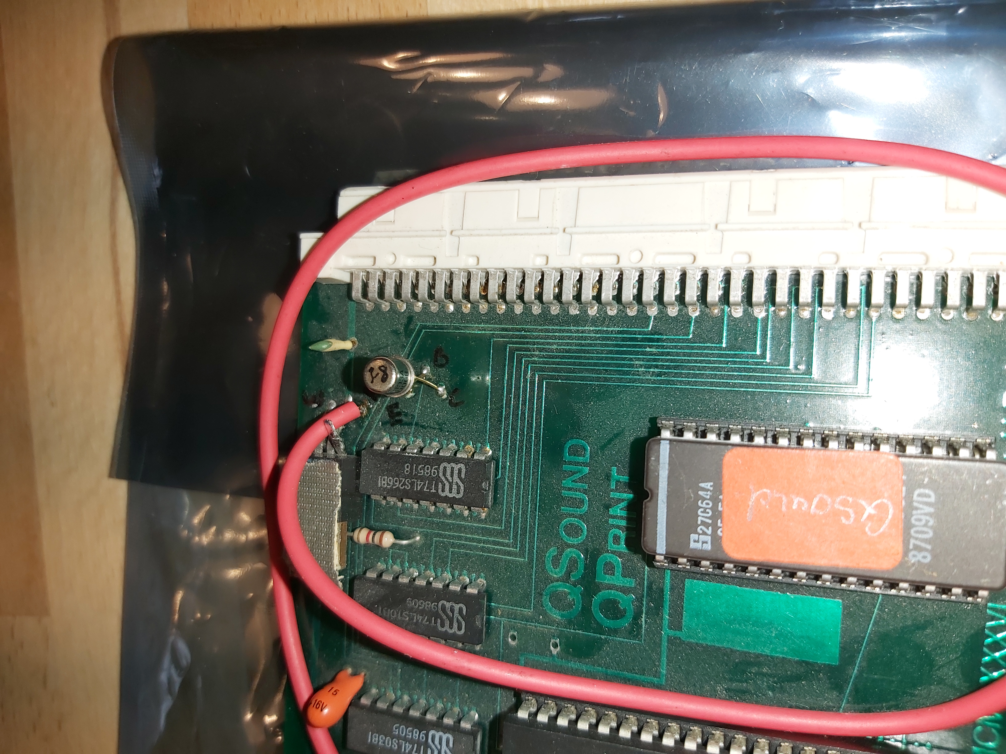

If I compare the schematics with my QSound I see a mismatch in transistor connections. In my case Emitter goes to +5V, Base to 74LS... and Collector to DSMCL
As I have found the Transistor speed to be critical and also found boot issue when tried with the ZX8301 replacement you may consider to check this. See some posts before in this thread.

Test that you have 5V, also test that all IC (at least the 4 I indicate below) get the correct 5V and GND.
Then If you leave only the ROM, U2, U3 and U5 in my schematic, you shall see the QL booting and the message of the ROM in the screen.
This is the first step, if you check the schematic, CS2/OE (pin 20 of eeprom) is the output of a very simple address decoder, you should check signals go correctly.

I still wonder why the transistor is rotated compared to my Qsound.
