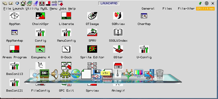

https://dilwyn.theqlforum.com/qdock/qdock101.zip
Been there since 24/08/24 but nobody had noticed/reported the broken link.
Contains bug fixes reported by Peter at that time and compiled with the latest QLiberator and Easyptr at that time - see UPDATES_DOC in the zip file.
Just replace qdock_obj and updates_doc in your existing setup, and possibly use Config or MenuConfig to set (1) default directory, and (2) whether or not to use Home Directory thing.
Reason: Added screen dump
