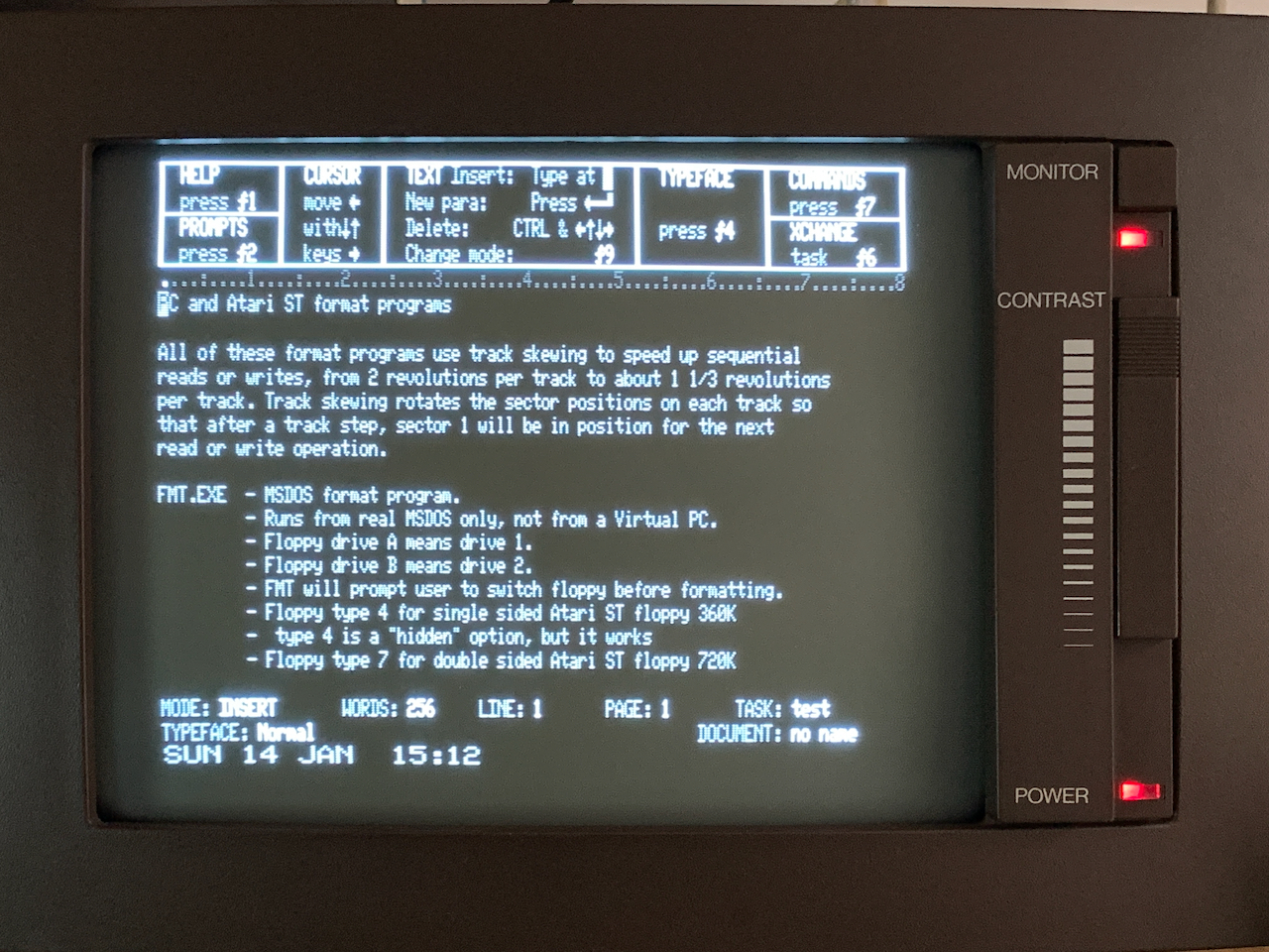

It looks like the disk image I was using to test was corrupted.
This may have been due to the Gotek's FlashFloppy version being old or because I had pin 34 set to change rather than ready. It certainly writes more quickly now.
Anyway, the converted version now mounts in DOSBox but something is not right as "type test.doc" seems to show the contents of the profile file instead.
Anyway, here are the images along with an HFE format file which contains the same data.
P.S. Using the converted floppy image on the OPD still works, suggesting that the firmware ignores the boot block.
