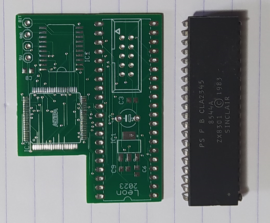

lliont wrote: Thu Nov 23, 2023 9:03 am Ok I have already ordered some pcbs of a more compact version of the basic ULA and after testing the new pcb I will order cplds to build some.
Is there still hope for this compact "pure" ULA replacement, or was it cancelled in favour of the 68008/FPGA project?
I'm still very interested in the former. It is much neater than the previously published designs.
On my main QL the ZX8301 seems close to death, so I'm quite eager. ;)

Peter wrote: Sun Dec 17, 2023 11:16 am Is there still hope for this compact "pure" ULA replacement, or was it cancelled in favour of the 68008/FPGA project?
Yes I got the pcbs, I'm waiting for few cplds
