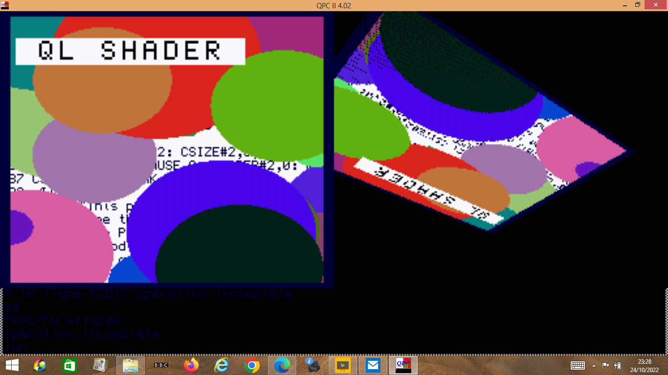

stevepoole wrote:Hi Folks,
Following the various suggestions about getting Pixel colours, I have cobbled together a prototype shader for 3d perspective windowing.
It works fine using the DIY Tk PIXEL% under SGC, but on QPC2 it does not seem to fathom out where in memory to look, and returns garbage values. (Screen set to 512x256).
Per's RPIX% seems to get that problem right, but the returned (16 bit ?) colours cannot be reused as INK values for shading...
So, is there a way of getting the original 256 INK colours from the 16 bit returned values when using QPC2?
The prototype is slow under QDOS, faster with SMSQ/E, but nips along under QPC2. But I need to find the solutions to these colour problems...
Any suggestions ? Steve.
________________________
Steve, I presume that when you mention a shader, you are referring to either SBasic or M68k code that runs within the emulator, rather than the OpenGL shaders that have been added to sQLux, which run on the host gpu? The OpenGL shaders have access to colour information at each pixel position.
Are you able to share your prototype code please?
stevepoole
Posts: 909
Post by stevepoole »
Hi Folks,
Thanks to Dilwyn's site, and advice from Per, I now have a working shader prototype, which is mainly SuperBasic code, and now runs OK under QDOS or QPC2.
I need to tweak it still further to make it fully adaptable. (Pity I haven't seen how the SQLUX shaders operate. Do they ray-trace for example ?).
At present it lifts images off the #2 screen, and wraps them onto any 3d perspective surface orientation, (but only flat ones for the moment).
The code is short and well-tested, and I will put it on the forum as soon as I am sure that it will be fully user-friendly.
But only being one day old, I need a little time before releasing it, as it covers some new ground to me.
Steve.

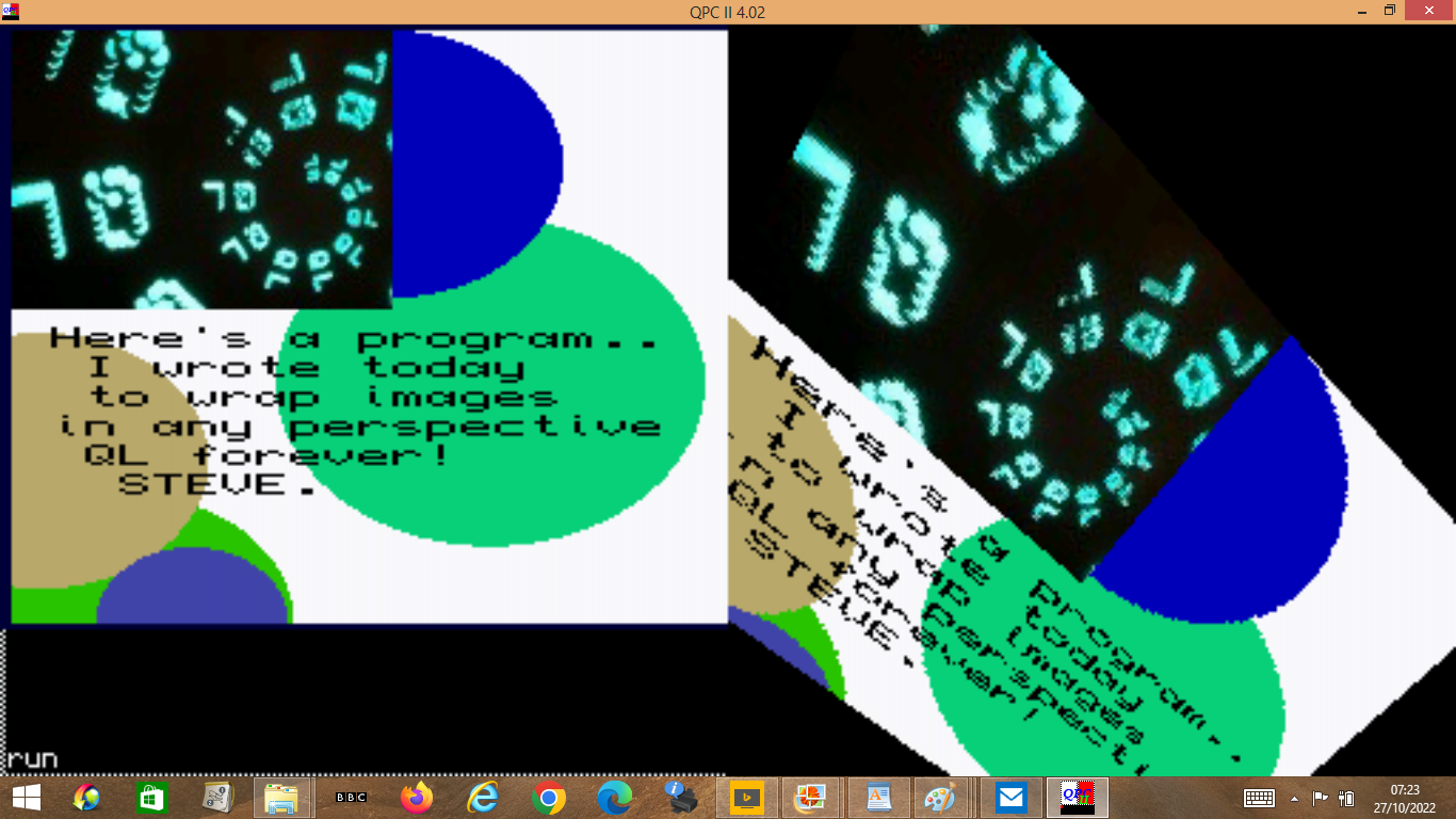

Hi Exile,
Thanks for the SQLUX info. I suppose my SuperBasic program should not be called a shader, to avoid confusion. A Texture_Wrapper, perhaps ?
Work is progressing though, and I have included the possibility to wrap photos, using photon's FPIC_LOAD function.
The photo used is a screen shot of an '80s program on my SGC QL to display text at any angle ! (But not in perspective ...).
Next I hope to wrap any textures onto multiple surfaces. Many thanks again to Per for his excellent RPIX.bin !
Steve.
stevepoole
Posts: 909
Hi Folks,
Here is a first version of the shader program, now renamed as WRAPPER3D_bas for you to tinker with. First UNZIP to your selected device. (say dos4_)
Then LRESPR RPIX.bin and PHGTK.bin. Type er%=FJPEG(dos4_YourPhoto.jpg,dos4_pic_pic) , with YourPhoto.jpg being smaller than 20ko so as to fit.
RUN, or change the variables sc (.5 1 2 4) , direction (-360 to 360) , angle ( 10 to 90 ) , slope ( +/- 10 to 85 ), xs (+/- .75 ) , ys ( +/- 1 ) ;
SC is scale factor : DIRECTION to look at the image : ANGLE step clockwise around image : SLOPE to look up or down : XS and YS invert the images...
Row and column details can also be changed, but for the moment I have not implemented them. (future versions will). <<< Tested on QPC2 >>>
Experiment by modifying the Channel#2 screen background in INIT... Regards, Steve.
